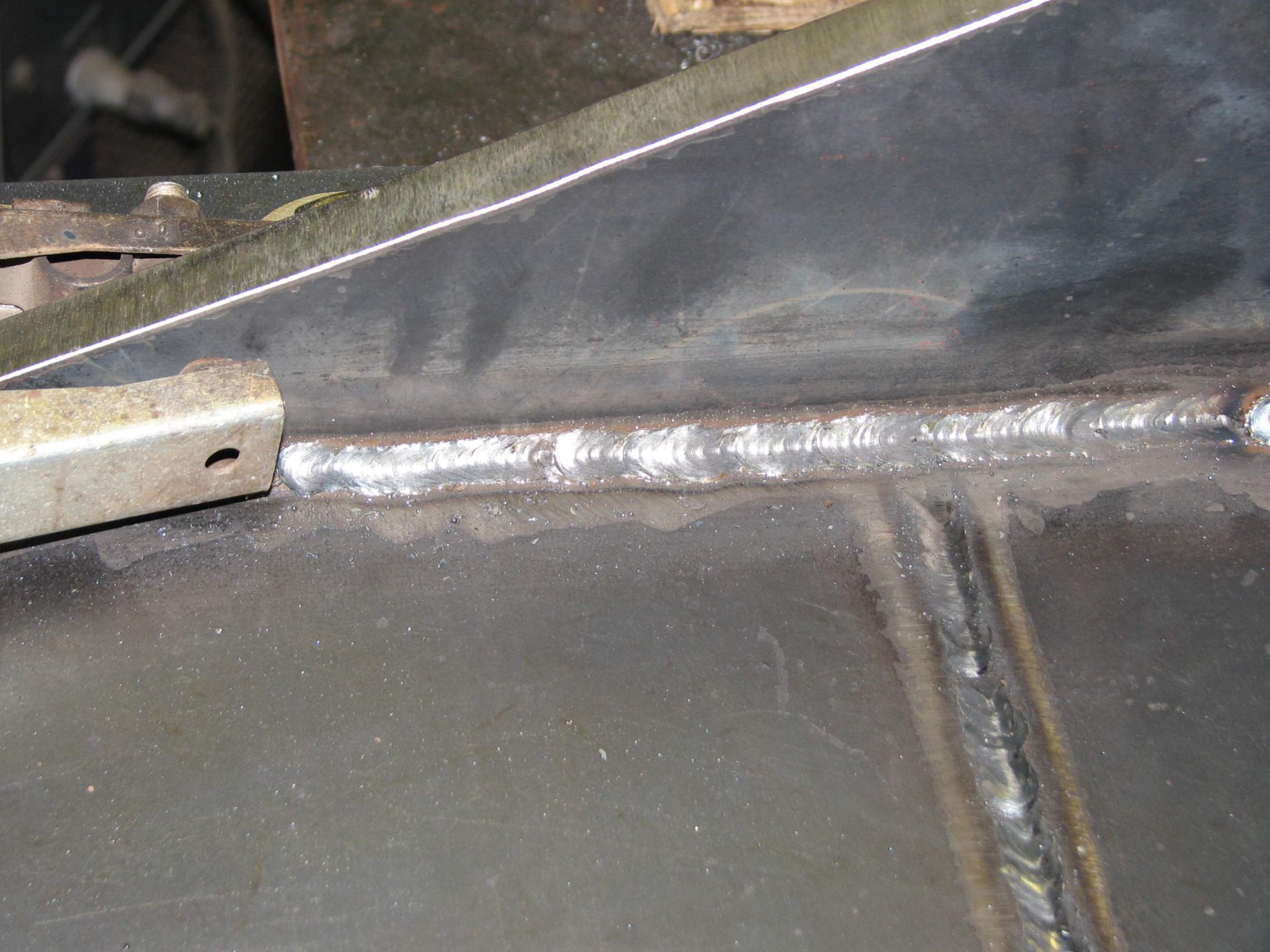

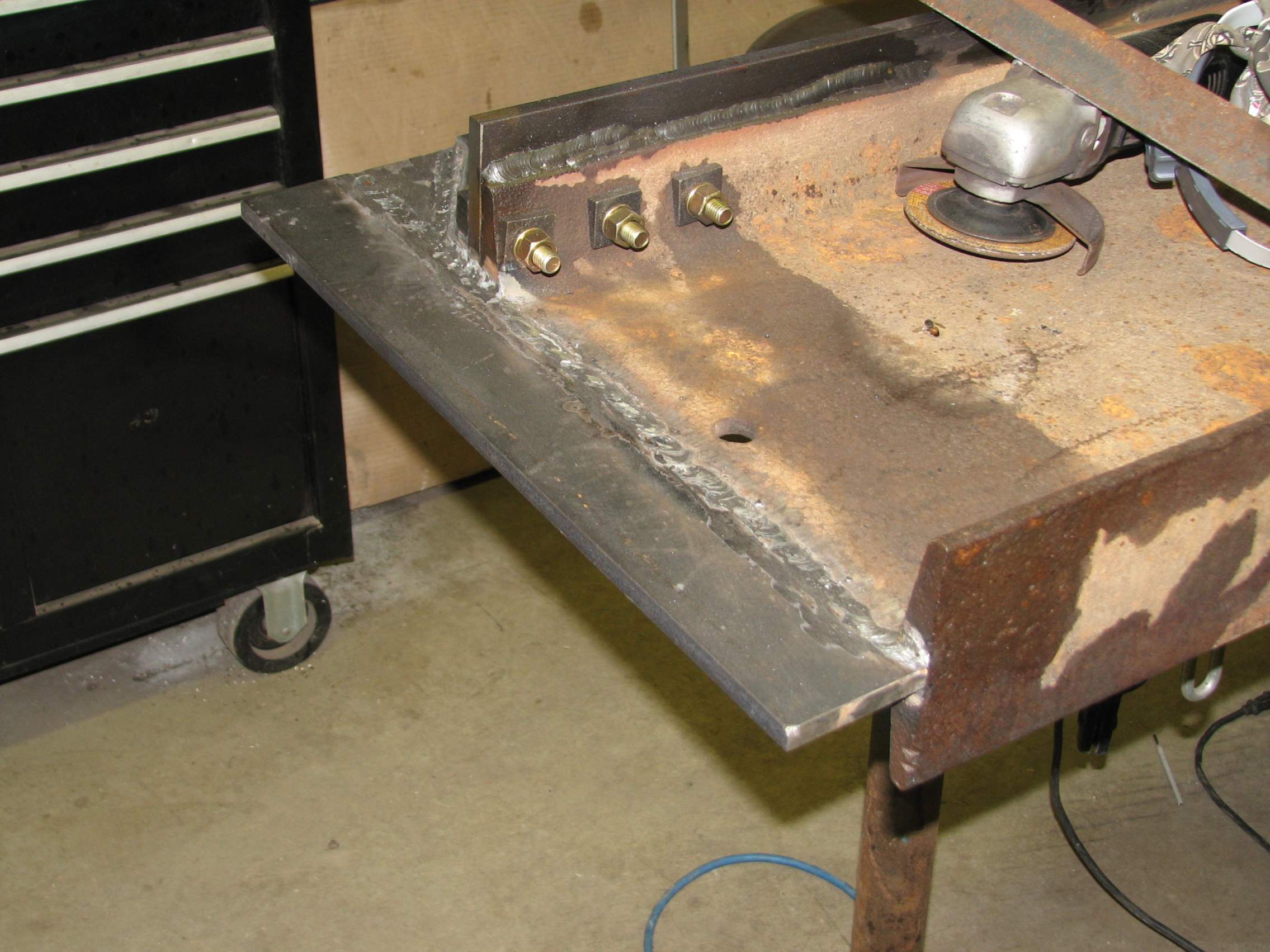

Half way done with the sled, just a lot of welding to do now.

Looking good there!
Will you have enough clearance between the sides of the push plate/sled to remove and install the pin in the clevis? I guess you could always just put a 1.5" hole on the outside so you could get the pin in and out.
Also, it sounds like you got your wedge (which appears to be 12") from Northern Tool. Assuming it was square and you cut the sliver of so it would be angled, how much did you cut off?

Lance, You can't see the hole in the picture, but it is there. On the knife, I just beveled the bottom good and tacked it at about 3 degrees and filled the gap in back with weld. First time I ever made fill passes and it is not as easy as I thought. I am getting fired up to finish this Beast!

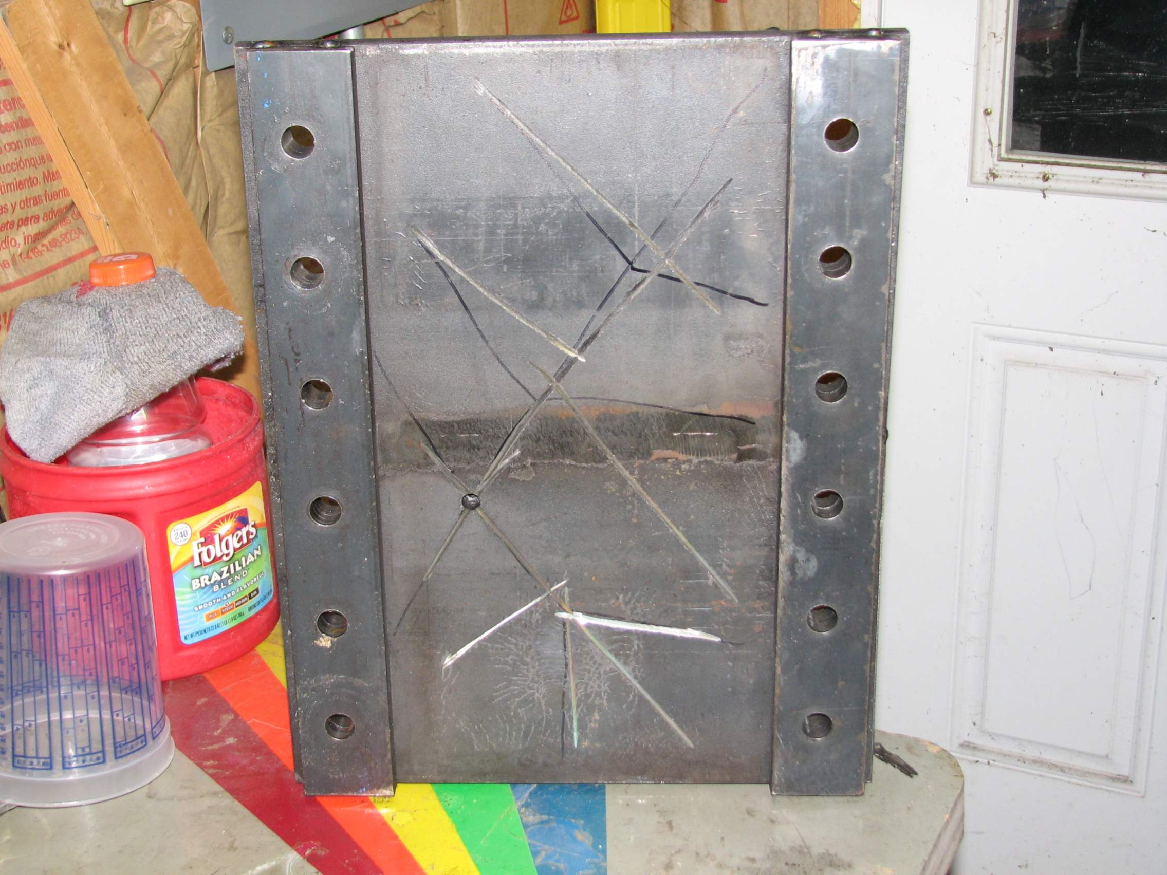

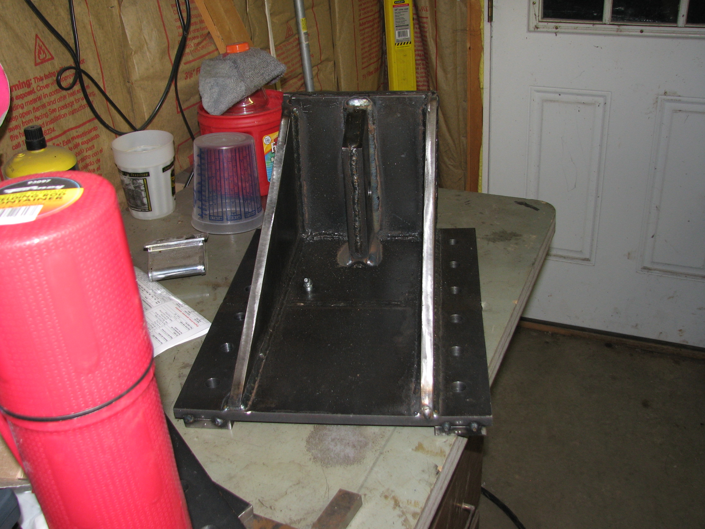

Well Valentines Day has come and gone and Romance has turned into sparks and slag. More work than I thought beefing up both ends to resist twist, But I think we have a good plan and if we don't run out of welding gas this weekend we may be close to testing on Monday.

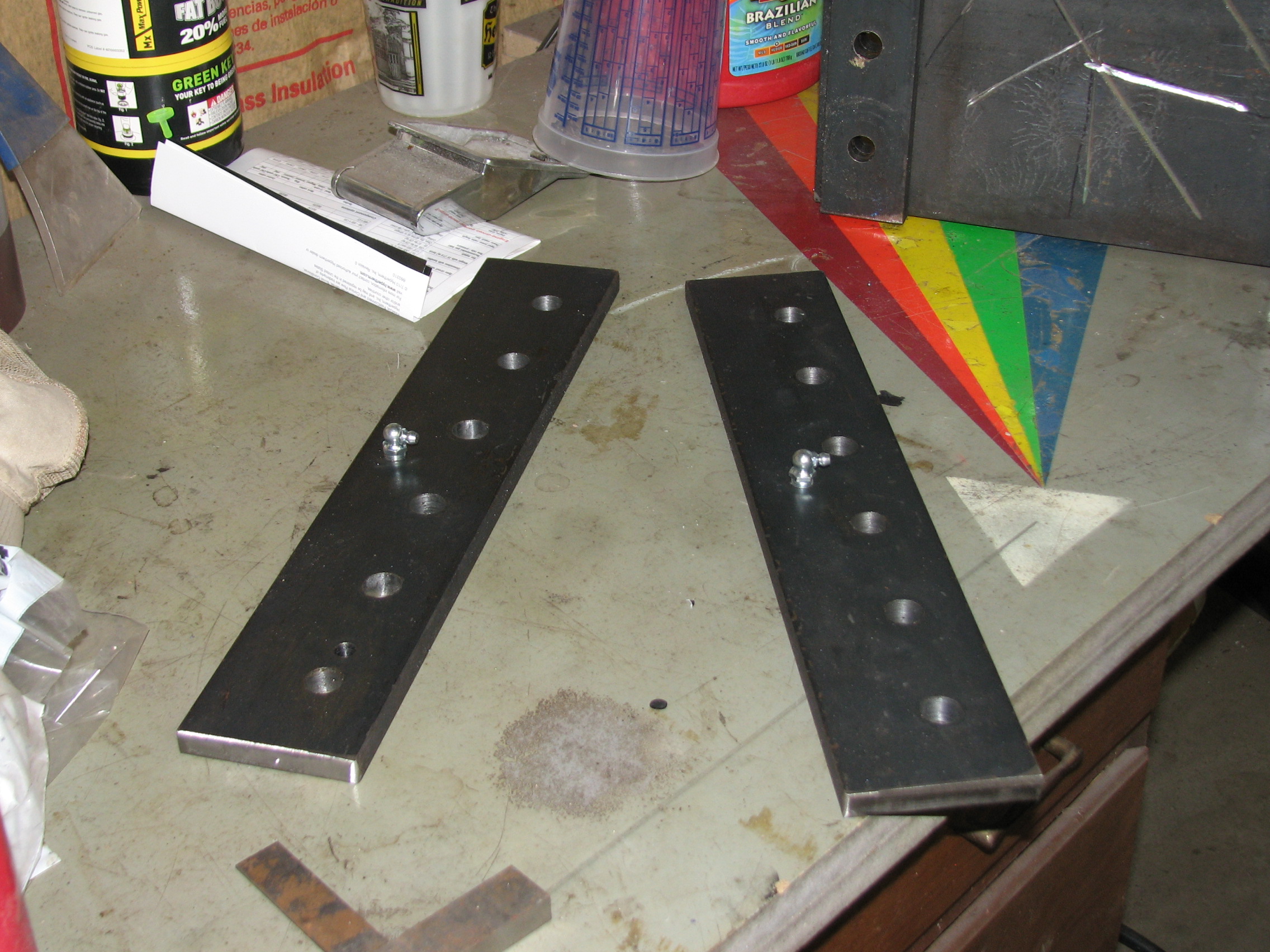

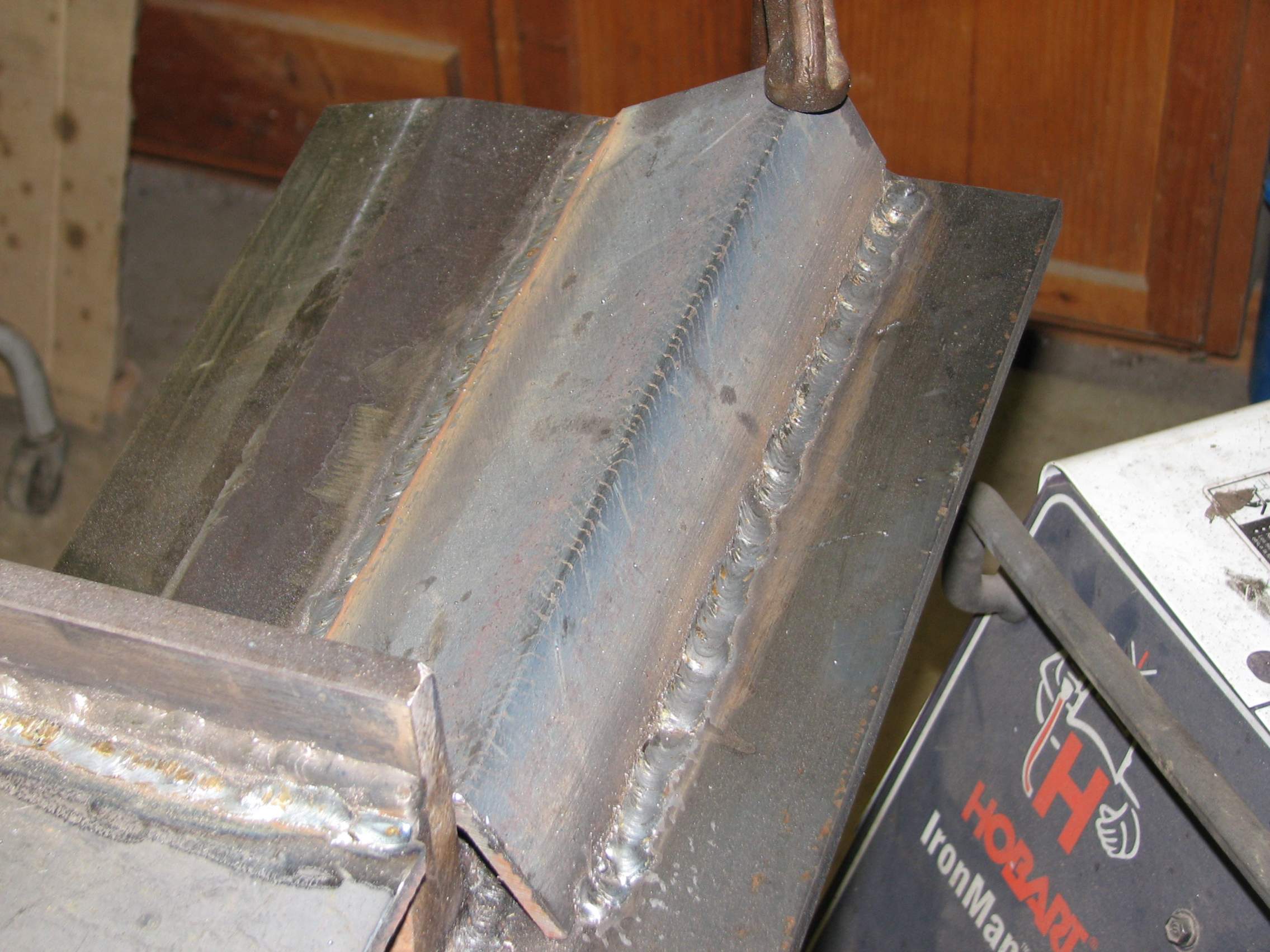

Just a few other details.

Looks like most of the steel you are using, plate wise, is all the same thickness. How thick is it? and How thick is your wedge before it gets to the angle iron?

LanceH, The structural parts are 1/2" thick and the side plates on beam are 1/4" thick. The wedge is 1" thick and was purchased from Northern Equipment. Thanks for the compliment GE , we decided to stick weld most of the beam web stuff and I have not stick welded in 20 years. I had never stick welded with my miller tig welder either. So the welds get better as we go. We just had someone drop off some 36" elm rounds so that should be a good test.
