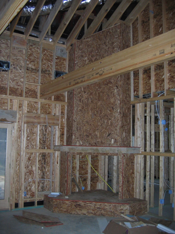

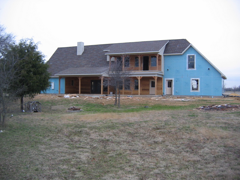

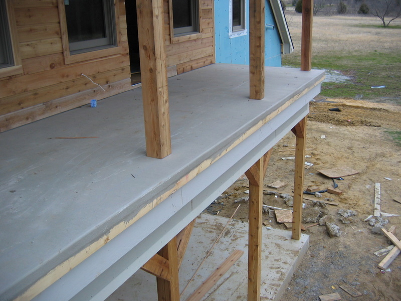

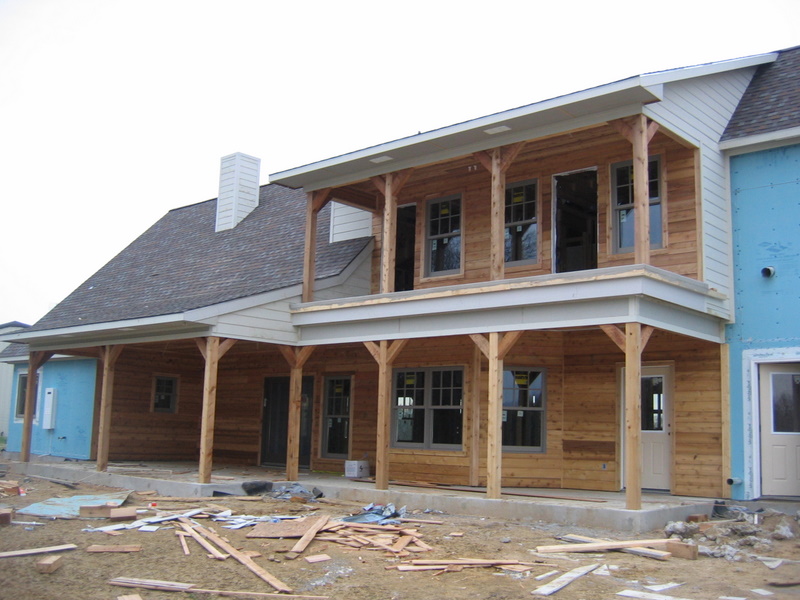

Here are some pics of the slow progress, especially the cement balcony. There is a 2 x 4 under the lip edge of the concrete that will be removed later. Also, the fireplace inside is framed in per my plan, which is derived from Mrs. Alan L's plan from 20 years ago, so the fireplace is pretty much identical to the one we had in our previous home, and we loved it. Difference is this ceiling is much taller.

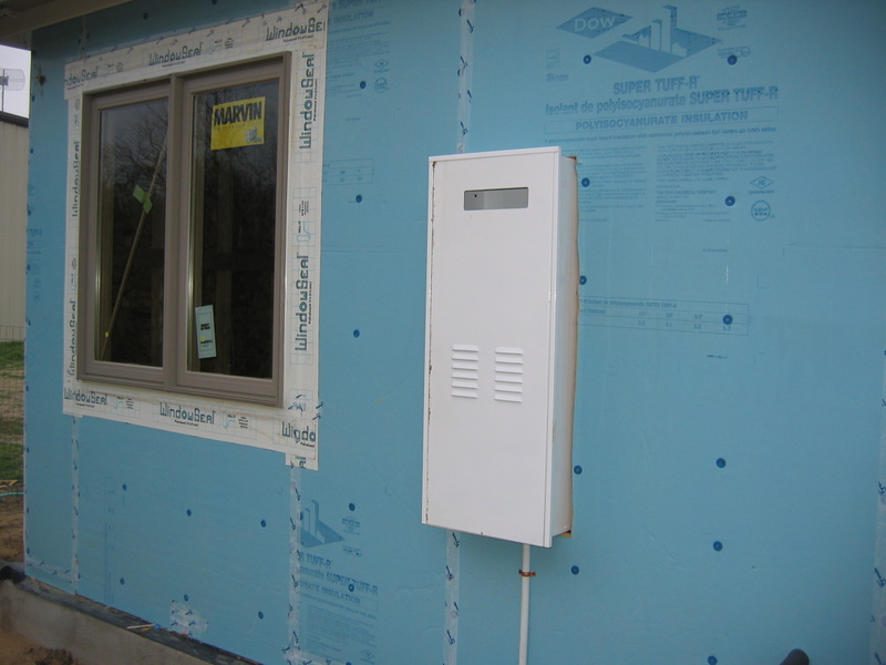

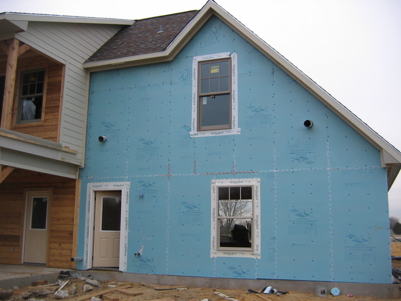

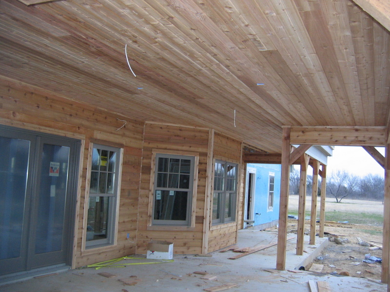

More pics of the back porches. In the blue area (to be bricked) to the right on the back porch area (this is the back of the garage mostly), there is a 6" duct sticking out about halfway up the wall on the left, and another one on the right. The one on the right is the fresh air intake for the ERV unit, the one on the left is the stale air exhaust.
Hopefully they will be spraying foam insulation this week some time.
