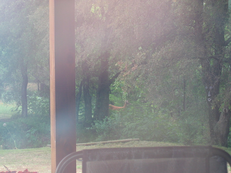

The amount of room and everything else has been just great and everything we imagined. Still alot of work to do, hanging pictures and such. Spent til 10:00 Friday night spreading gravel for the driveway, then we got the big rain and I found I had blocked some water flow. Had to get the tractor out Sunday morning early and cut me a trench in it to let the water out. Guess I need some kind of pipe to act as a sort of culvert.
In the building we didn't have but a couple of windows to see out of. First week Mrs. Alan L. spotted a deer right out one of the back windows, and a bobcat the next morning. Much better view in all directions. Attached is her fogged up picture of the deer.

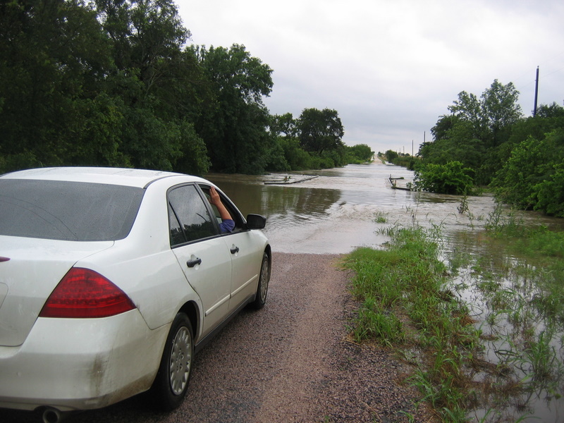

Here is a pic of my creek. The bridge splits my property in half - that is the creek runs more or less down the middle, but it has some feeders and is pretty crooked too.
