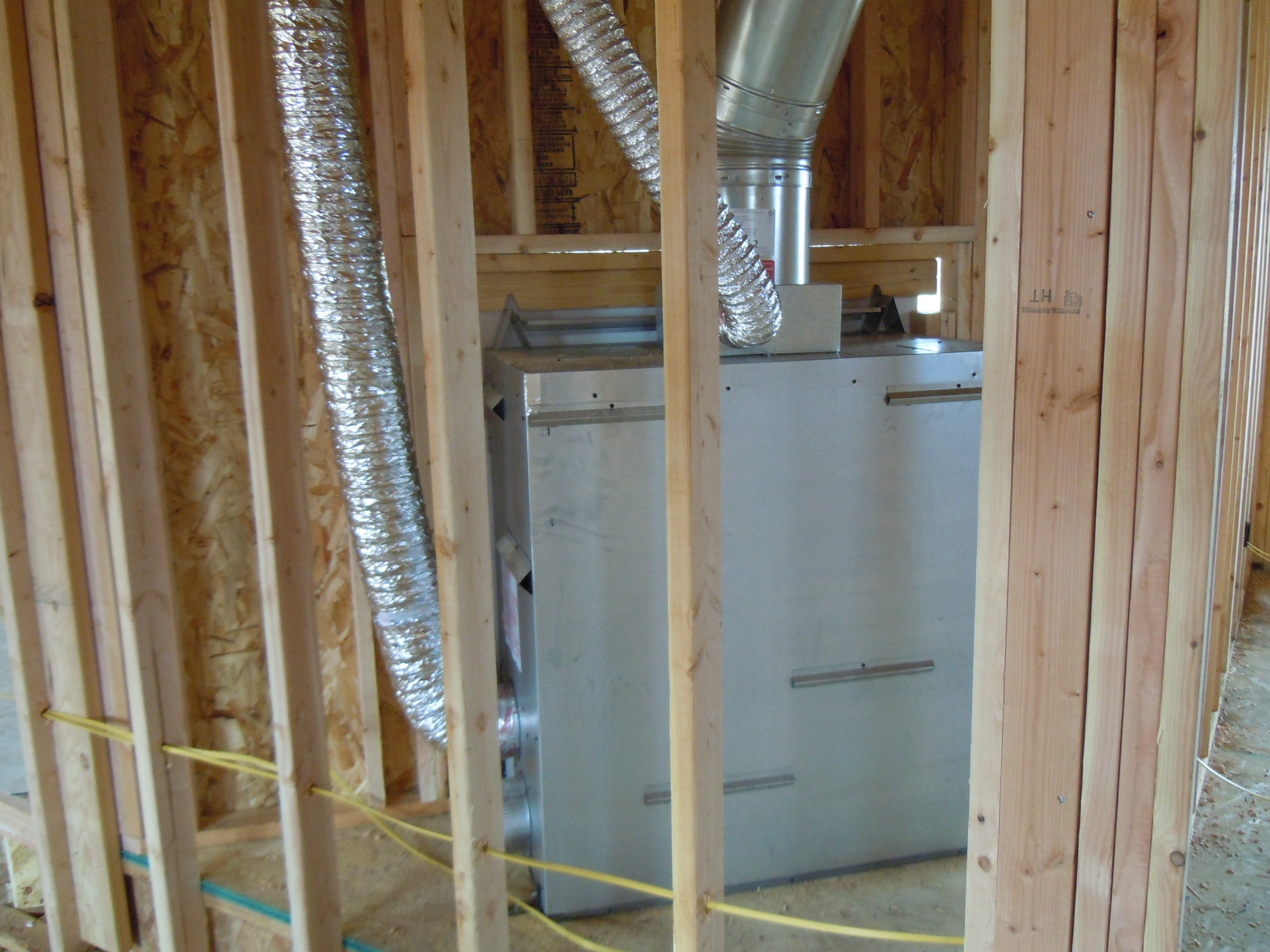

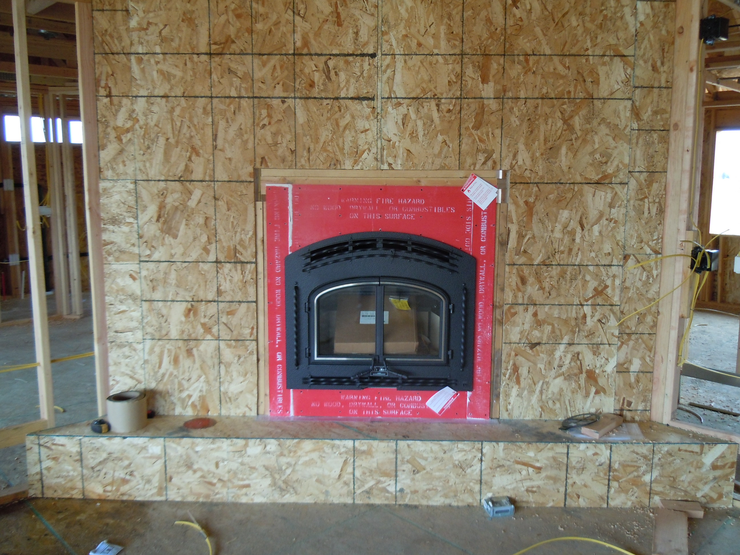

Here's some pictures of the fireplace. On the back the bigger line is combustion air, the other one is cooling air for the flue pipe.
The last picture is why we need a fireplace to begin with.:laughing:

Would you ever need to get into the space behind the fireplace?
I have bought homes where rodents gnawed through heater ducts and made a mess... one was in a concealed space.
Anything I do in concealed inaccessible areas is with hard duct as a precaution...
Not saying your area has a rodent problem but it looks like significant space being walled up.
