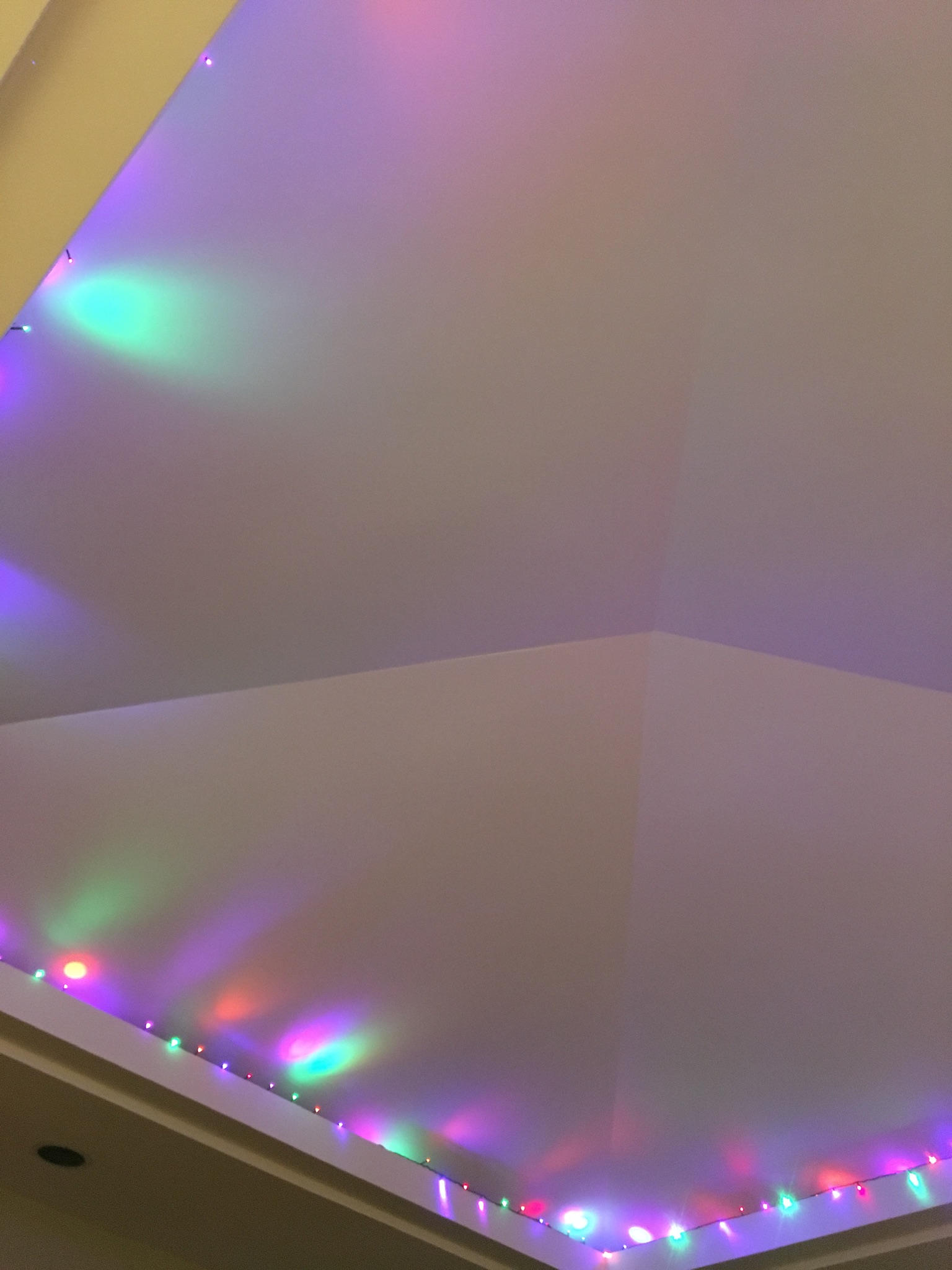

We have a "trayed" ceiling in the master bedroom and I'm thinking T&G would look real good in there. Goeduck ask about it a few posts back. I didn't think about it much then, but, the thought has been planted.:) I would do it after we move in.
I did not know the definition or trayed ceiling until now. Coffered was mentioned that I referrred to but I now think that is a different style entirely. From a quick google search I think trayed is what cat fever has in the one picture. I have 3 exactly like that and then this pyramid trayed ceiling that I would like to put T&G in. I probably would tackle the 3 that are like cat fevers before the pyramid one.

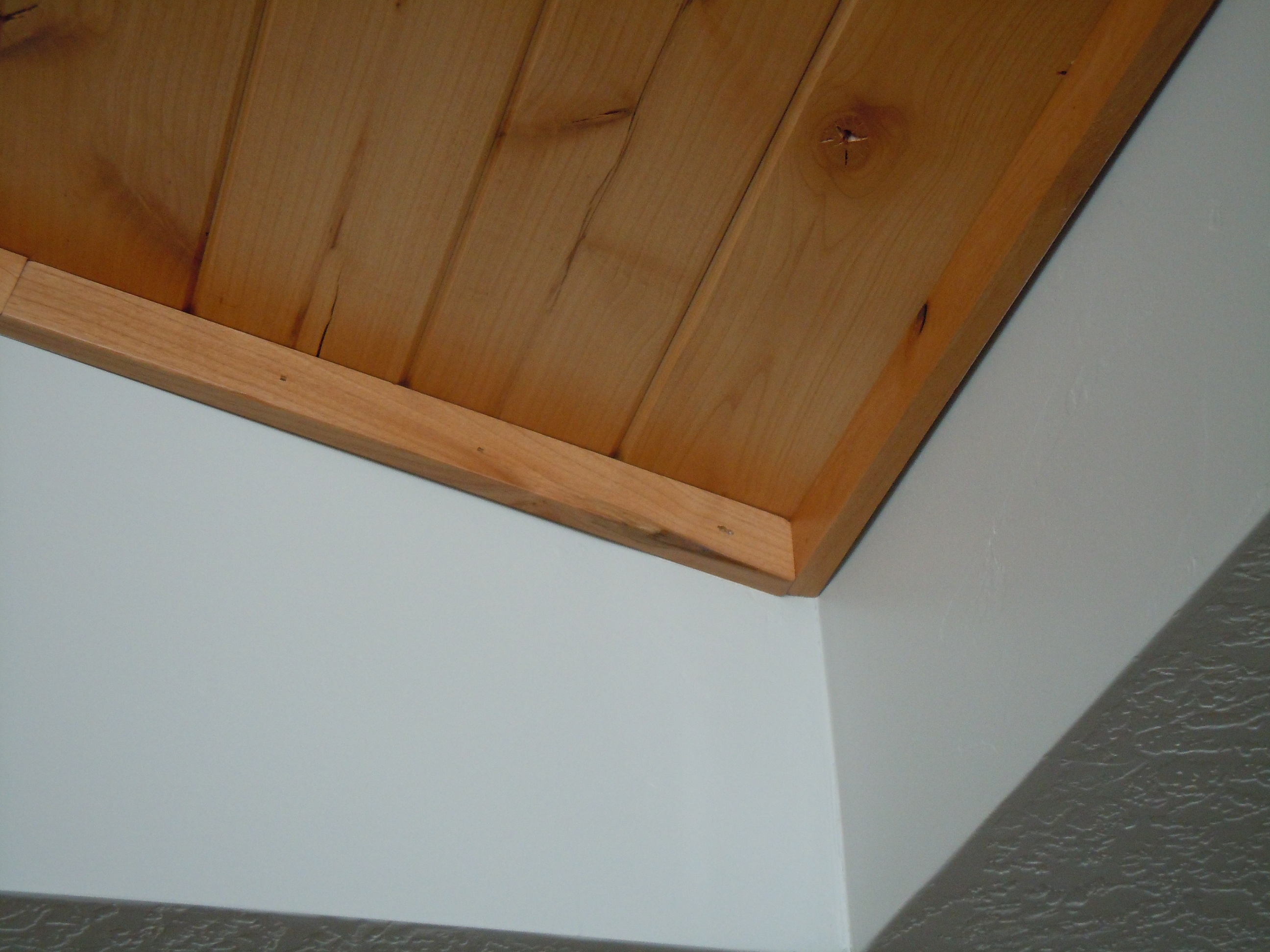

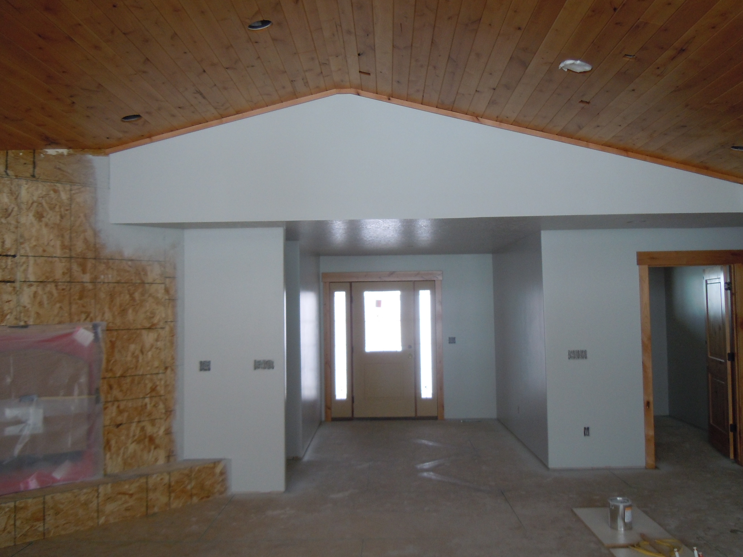

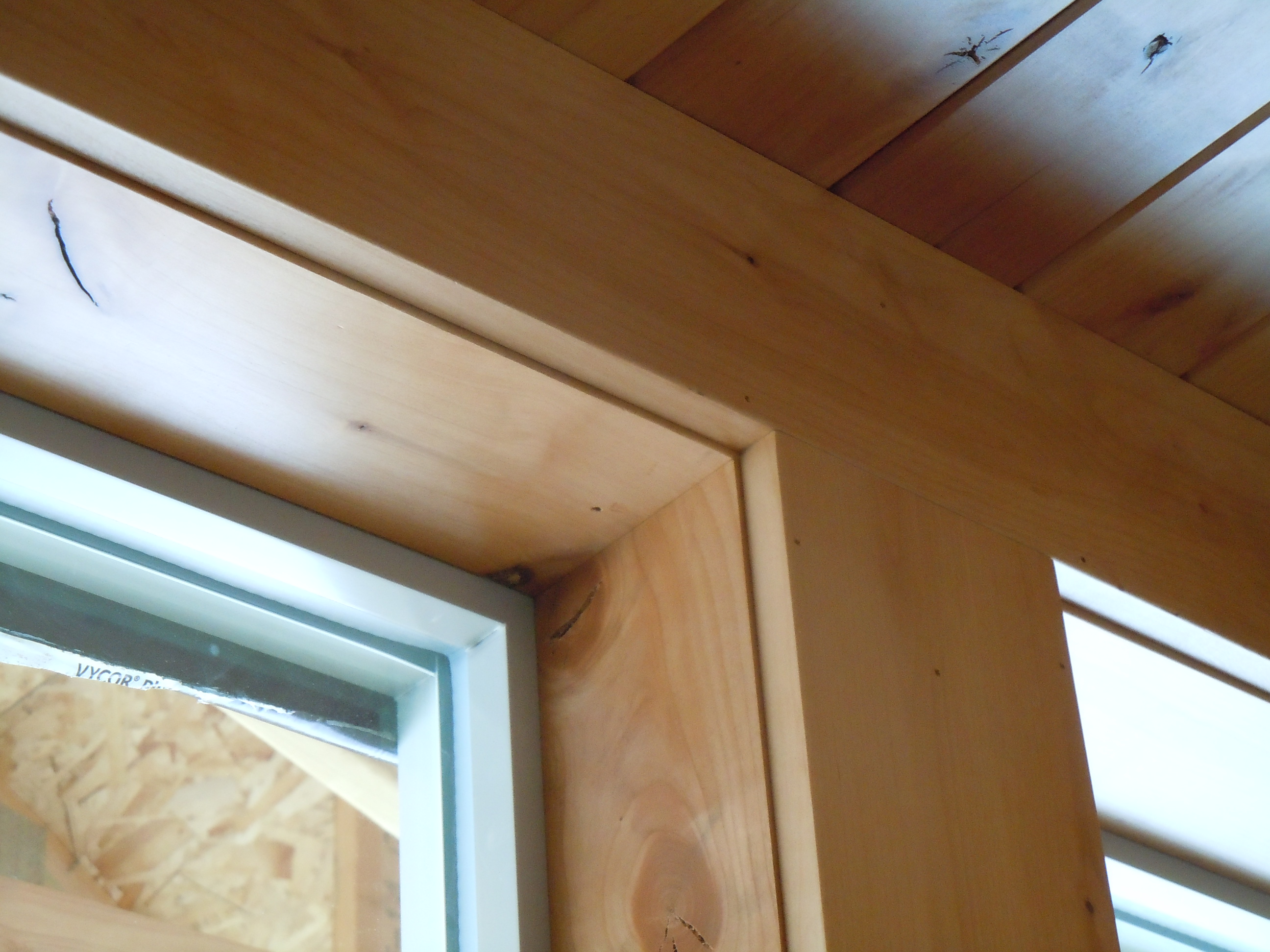

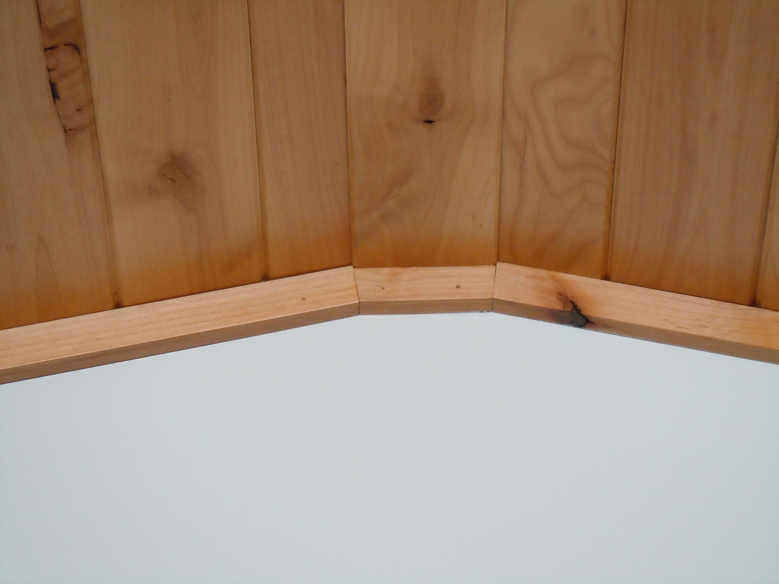

Buckeye,
Here are some pictures you ask for a few posts back. If it's not want you want let me know.
The exterior is being put up. (slowly)
Flooring is going in right now.
Tub/shower surrounds going in tomorrow.
Cabinets going in Thursday.
Moving along nicely. :)
