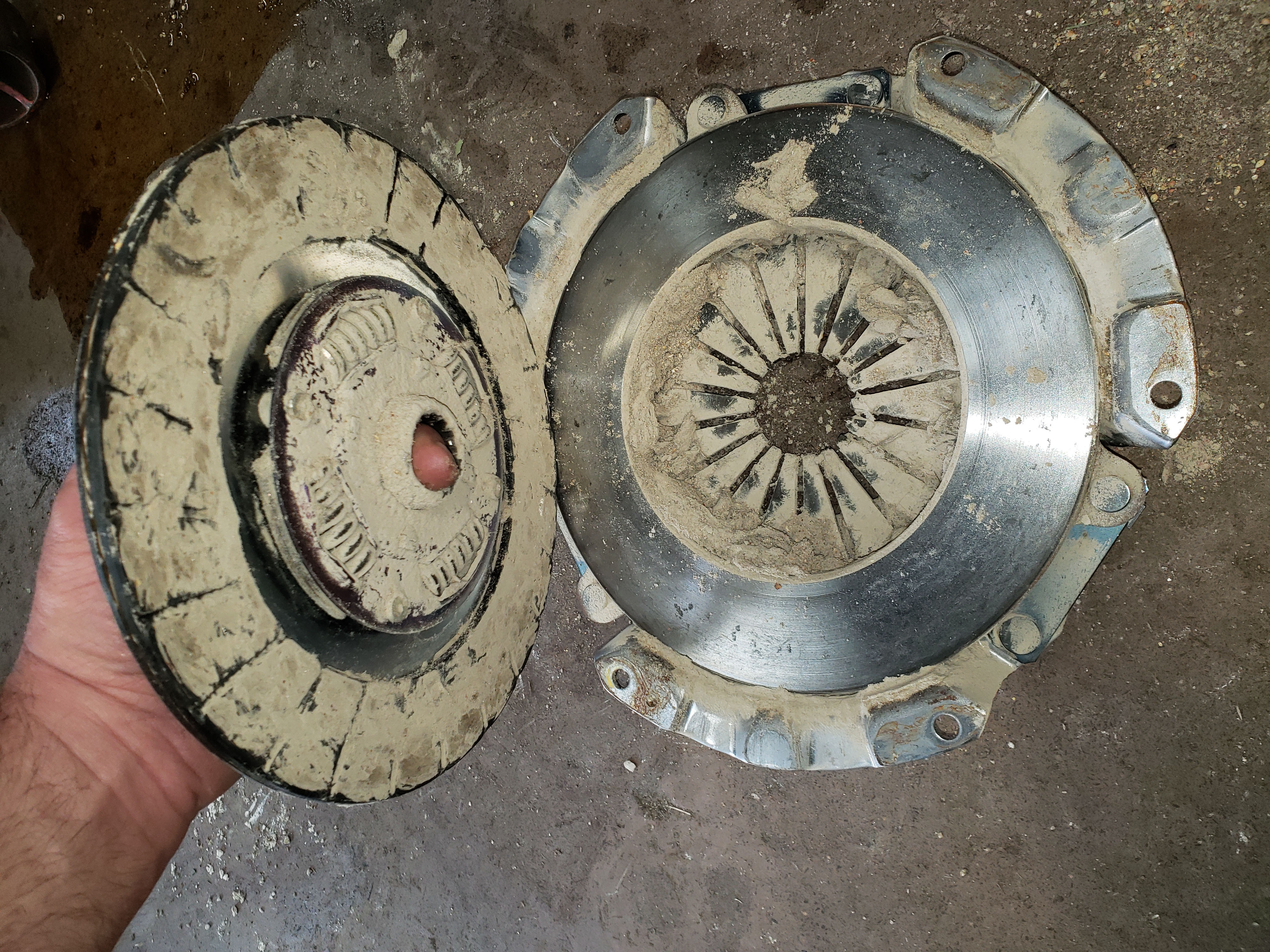

In case anyone cares, here is a followup to my saga.
After replacing the starter, I worked the tractor for about another 5 hours and then started to have drive problems. It would barely move in forward or reverse. It was beyond my capability to repair, knowing it had to be split. Took it to a dealership 80 miles away. When I dropped it off, tech initially thought it was an issue with the HST. He just barely got it off of the trailer and back to the shop's parking area. A couple days later he called to say that something was wrong with the clutch as he had no PTO rotation either. On these tractors the HST is not part of that power tranmission path to the PTO. So he split the tractor and sent me several pictures including the one I've attached here. He said that everything would probably work if he just cleaned up the parts, but recommended replacement. I agreed and told him to replace the pilot bearing, throwout bearing, clutch disc and pressure plate. I didn't want to have him split the tractor again in case the cleaning job didn't clear the problem. It took nearly a full week to get the parts from Mahindra. Total bill was $2040.00. I've since put another 20 hrs on the tractor and all is well. He took off the screens and plates I had put over the holes, so I had to do that again. Wish I could turbocharge the tractor, kind of a dog at 8200'.
