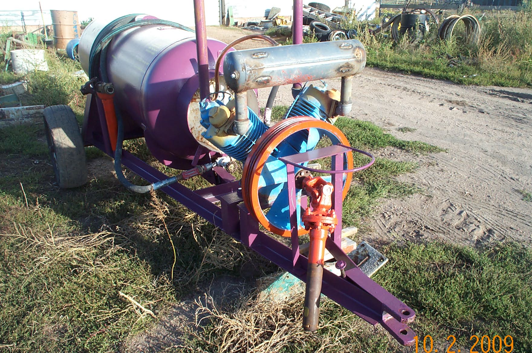

the only time I try to start my tractor with the PTO engaged is when I have this big air compressor hooked up, as with the fly wheel the location where the PTO shaft and the fly wheel attaches is a weak point and you can shear 6, 3/8 bolts like butter, so start it as slow as possible, mine does not have a safety switch on the PTO,
