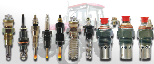

tractor_glow_plugs.jpghttps://encrypted-tbn0.gstatic.com/...mkYGx9adYjKpFXgzA9FKN-ALao-Xo241nWurCoJNo6zsn
The attached picture shows several different diesel cold start aids. On the right is the type of manifold heater used by older Perkins, Allis-Chalmers, and other engines. They have a heating coil that both opens a fuel orifice that sprays fuel into the intake manifold where it is ignited by that same heating coil. This type has been used on lots of different brand large commercial diesels. It is difficult to control emissions properly so now other heater types are used such as the grid manifold heaters. Both the fuel fired and grid heaters heat the combustion air.
Glow plugs do heat air but the air is that immediately surrounding the glow plug during each compression stroke. Glow plugs are optimized for either indirect injection or direct injection. Remember that the Diesel cycle differs from the Otto (gasoline engine cycle). Diesels ingest a full cylinder of fresh air with each stroke - needed for the compression to get the air up to ignition temp. Then only enough diesel fuel is injected. The glow plugs are in this stream so they can heat the small amount of air where some of the fuel is sprayed starting the flame front.
If you read up on glow plug history from the different manufacturers you will see that a problem with older designs is that people tend to overuse the glow plug (turn it on for an excessive period of time) which results in burned out glow plugs. The newest (probably meaning most expensive designs) are self controlling.
Watch the attached glow plug video to see how the tip heats. The air heated immediately surrounding the glowing tip is enough to start the fire.
DieselRx Glow Plug Comparison - YouTube
