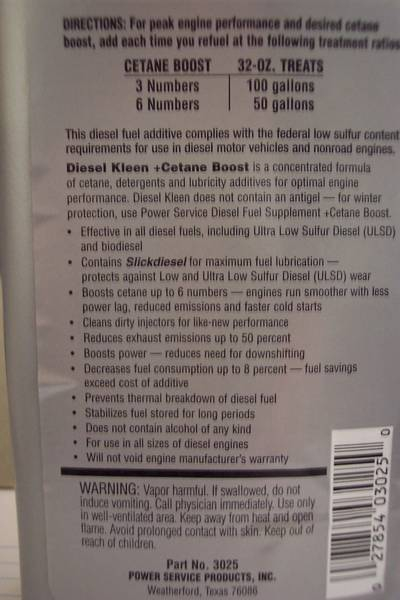

I try not to use the 911, it's not great for the engine. It contains alcohol. I do use power service with anti-gel (white bottle) as it's easy to get. I often use it year round simply because I have treated fuel left over from winter that lasts well into the summer. I don't think there's any difference between the silver bottle and white bottle except for the anti-gel. There are other brands that do work better (lubricating, not anti-gel) if you are willing to spend more.

Any idea why they would say on the link to their white bottle that it is only for temps below 30F? They just trying to sell the silver bottle?
Why would you need any additive for temps above 30 degrees?

Mostly for lubrication with the ULSD fuel.

They did - but - not enough per EMA (Engine Manufacturers) requirements. API spec'd 520mm 4 ball wear test max scar depth, EMA spec'd 460 per fuel injection pump manufacturers. So.......fuel suppliers aren't gonna add any more cost than they're required to, hence always use a lubricity supplement.
Also, most commercial diesel fuels have min. cetane (40) where our small engines require 50. So need cetane booster too to get complete combustion - prevents exessive deposits on injector nozzle tips, etc.
I use Opti-Lube XPD. No alcohol.
