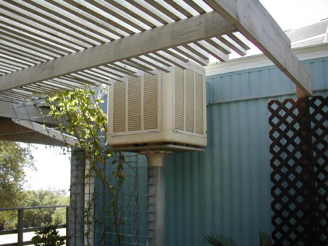

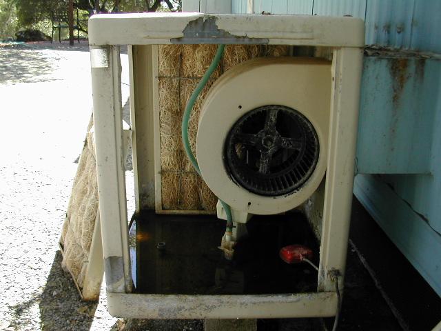

Here's some photos of "swamp coolers". They are cheap to buy, cheap to operate, and cheap to maintain. These two are about 20 years old. One photo shows the inner workings: pump, blower, pads. Pretty simple.
In my case (off-grid) the "cheap to operate" is the most important point. To get enough solar power to operate refrigeration air conditioning is beyond most budgets. And MOST of the summer, swamp coolers are just fine here. It's only the past couple of weeks with over 110 degree heat that have been killing us. Good news, it's gonna be under 100 for the next week or so.
About every other year the water pump needs replacement, about $20. As I said earlier, the pads should be replaced every year, maybe $15 buys all the pads I need for both. The blower motors (whether direct drive on photo 003 below or a belt drive as the bigger unit has) usually last many years (these are both original, knock on wood).
The coolers on commercial buildings are huge. Ace Hardware's are probably 5 ft cube and there's a bunch of 'em.
[on edit: about every two or three years the water inlet valve and float have to be replaced also. So... 4 parts that need occasional replacement or maintenence.)
