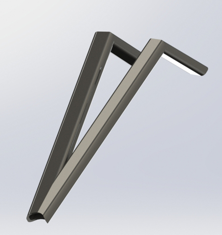

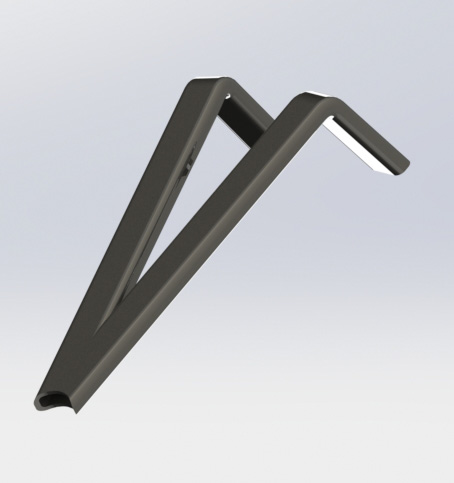

I have got some rectangular tubing that I need to bend a tight radius. It is 1x2x.125 Rectangular tube. I need to bend four pieces that are 30 inches long. The image below shows two of the pieces as they will appear finished. Wondering what would be the best way to bend something like this. I would like to do it myself, I did phone some machine shops and they wanted a lot of money. Any suggestions would be appreciated.

Cut 45 degree angles, flip and weld up, then grind if desired. IF you actually bent them as shown, the outside surface would be really thin. I assume it could be done with heating it and proper fixture. Cold, I doubt if that tight of a bend can be done in tubing.
   / Steel bending #3
Similar idea, if you absolutely need a radius and not a sharp corner: Grind a few slots 1/4 to 1/2" apart, with a bit of a wedge shape leaving the outside of the curve intact. Bend it so that all the slots close up, weld, grind smooth. You might have to regrind a few of the slots to get the bend you want before you weld.
You could also grind a slot at the start and end of the curve, and remove the inside surface and side walls completely. Bend the outside to a curve you like, then clamp into position. From the scraps, bend the inside surface to match the new curve and weld in place. Trace the arc shape for the sidewall onto a piece of scrap, cut out two pieces (using any of: bandsaw, grinder, torch, plasma, cnc), weld in place. Grind to match.

Bending the tube was purely cosmetic, but I'm thinking that I'm going to lean more to cutting and then welding it. But you have given me some really good suggestions. I've attached two renderings of what the difference would be, I've just always been a little picky about how things look as well as how functional they are.
It was 107° bend with a 1 inch radius. Really tight.

If weight is not a problem, 1"x2" flat bar stock would bend nicely to the radius you desire.
   / Steel bending #14
If you make 6 cuts over 2-1/2" (1/2" apart) each about 0.2" wide at the inside of the wedge (mark each at 1/8" and cut outside the marks with an 0.040 cutoff wheel will get you pretty close to that), you'll have a pretty close approximation...and you won't have to hold the metal in place like you would if you did a cut-and-flip.
