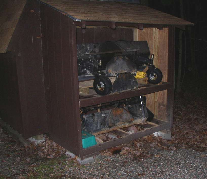

if my memory serve's me right. Didn't you have some sort of added roof or something to one of your sheds around the back side, where you drove the PT up to it and could hang up attachments?
Think they were more or less outside but protected from rain. How did that work out? Do you still use that and did you leave them outside all year round? How about rust? Or was that someone else. :eek:

Yes, that was me. I think it is working fine. It's mostly downwind from the prevailing wind. I have not seen any issues and it is very convenient as well as cheap and easy. It is enclosed on three sides and the open side faces NWN. See attachment.

Looks like a convenient and smart idea. Only thing that comes to mind. Around here I might worry a little about someone stealing something. Even though I have never had a problem, other people on the mountain have reported things stolen.
Would defiantly help free up some room in my garage. Or at least until I can get around to constructing a new building. I would put some doors on it though, if for no other reason to keep someone guessing at what might be in there. :cool:

I thought about running a chain down through the middle of the open side. You could run it through the attachment quick attach plates or at least put a pad lock through the holes in the plate. We really don't have a theft problem here and who would want a PT attachment. It's a very small market.
