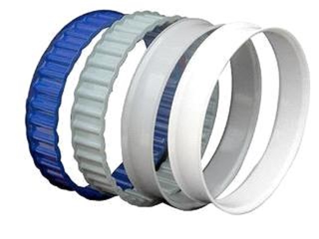

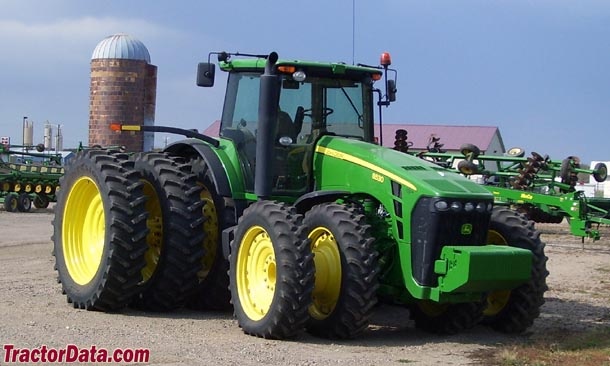

Another thing worth considering is the spacer band off of large tractor duals. A 42" band would likely be more than 12" wide and look like those shown in the photo below. It's just a rolled band of steel that separates dual tires/wheels for multiple tire applications. Even new they can't cost all that much. Generic farm parts are relatively cheap. Just a thought.
I can't get the photo below removed. It was supposed to be an example of a dual setup--and it is--but this one only has the dual bands in front.. Sorry about this.

Another thing worth considering is the spacer band off of large tractor duals. A 42" band would likely be more than 12" wide and look like those shown in the photo below. It's just a rolled band of steel that separates dual tires/wheels for multiple tire applications. Even new they can't cost all that much. Generic farm parts are relatively cheap. Just a thought. <img src="http://www.tractorbynet.com/forums/files/welding/401987-steel-diy-fire-pit-advice-china_spacer_band_sb4020c_sb4020k_sb4020r_sb4415c_sb4220c_sb3320k201112221531567-jpg"/>
Great idea!
