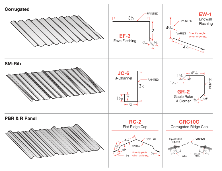

On metal panels such as what yours look like, the edge shouldn't leak even without butyl tape. The edge of the panel with the foot has to be under and the other edge without the foot has to be over. Possibly the wrong edge is on top at the seam, Metal-Roofing.gif
On the picture on the bottom, the left side of the panel with the foot should be overlapped by the side without the foot of the next sheet.

   / Steel roof leaking #45
On metal panels such as what yours look like, the edge shouldn't leak even without butyl tape. The edge of the panel with the foot has to be under and the other edge without the foot has to be over. Possibly the wrong edge is on top at the seam, View attachment 499957
At least that is what I was told.
I don't think it matters what type of panel -- I used PBR panel on my boat house and the manufacturer still called for butyl tape on all seams. Wind can push rain under that edge rib without some sort of sealant.
Not all panels are formed that way. I have actually never seen a panel with that "foot" and I have seen a lot of steel roofing.

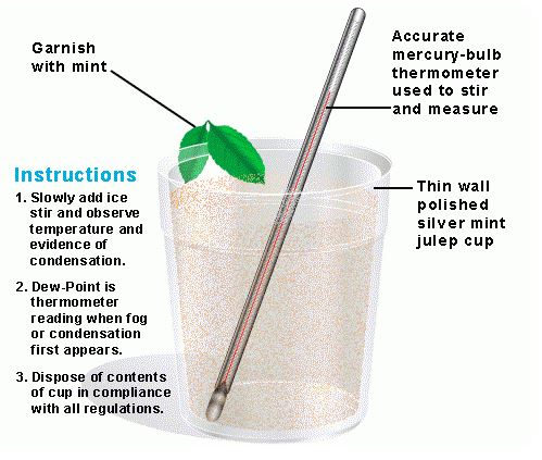

Condensation can easily be determined, when there is visible water, by taking an air dew point temperature reading at that level and comparing that DP temperature to the metal surface temperature.
You won't necessarily need a silver cup or the mint for barn work. :laughing: A glass or AL container will work and when a piece of tissue sticks to the container dew has formed.
Aaron Z
There different types no doubt but that is the one I am most familiar with. Also the screw nearest the seam must be about an inch or so away for a better seam hold down.
I definitely thing butyl tape would be a good idea but the steel guy never advised it and I thought it was for corners and peaks and such.
