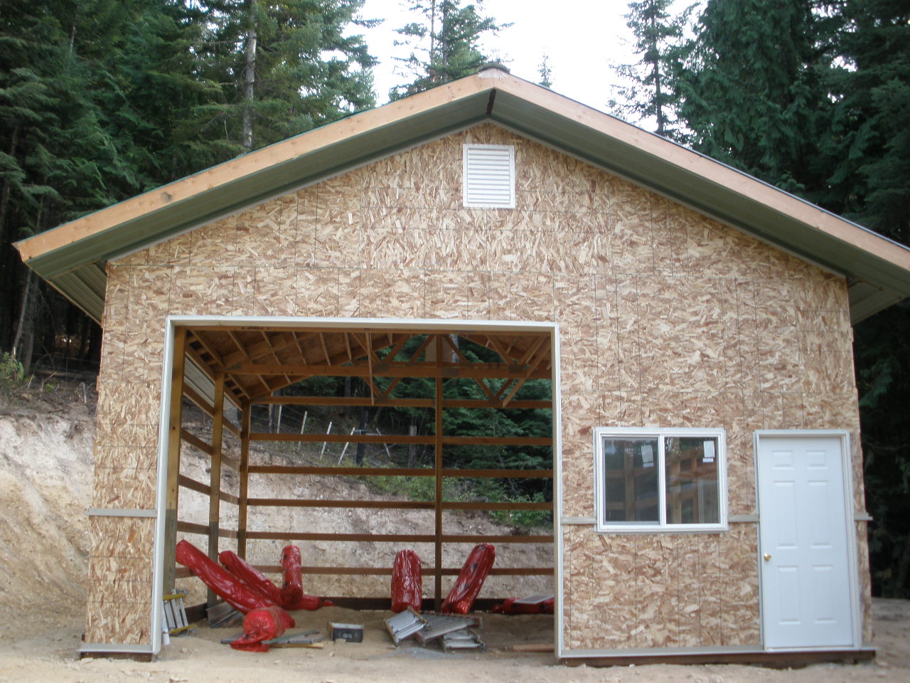

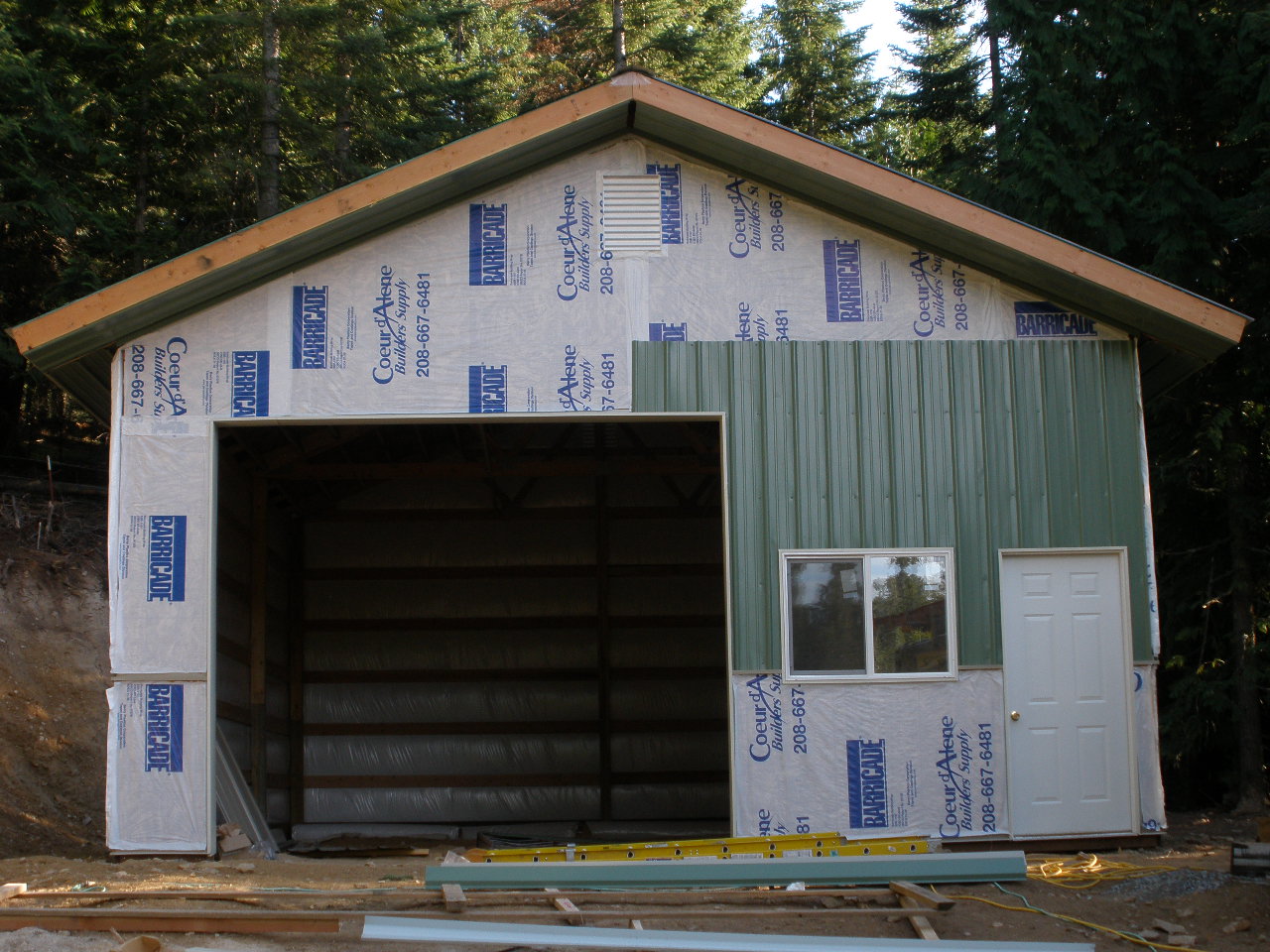

When I put up my pole barn I wanted it to blend in with the house so I finished the front gable with Hardi-shingles and painted them to match the gable on the house. Luckily the steel paint scheme was a close match to the house. OSB sheeting was nailed to the front with house wrap over the OSB. The steel was attached to finish it off but using the Hardi-shingles keeps it from looking industrial.
