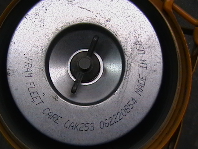

Rob,
It looks just like my Donaldson (on one end anyway).
For the price, you could just remove the plastic fan.
The Donaldson filters are washable, but kinda pricey.

Tom,
That's sort of what I was intending except using steel wool and the oil vapors from the breather exhaust. What's odd is that Brad's 554 came with the oil bath filter and mine has the paper filter.
Which one is a better filtering system?
Today I finished re-routing the breather into the air intake tube.
I also re-set the filter minder and changed the paper filter with a brand new one.
The routing is not directly into the intake manifold but very close to it.
I had to make another bracket to hold the steel tube but it came out pretty good. I reduced the size of the tube just before the intake. I drilled a hole into the intake tube and welded a hose barb onto it. I ran a short length of hose from from there to connect it. When I got done, I ran the tractor for a couple hours and it ran fine.
Here are some photos of re-routed system.
Rob-
