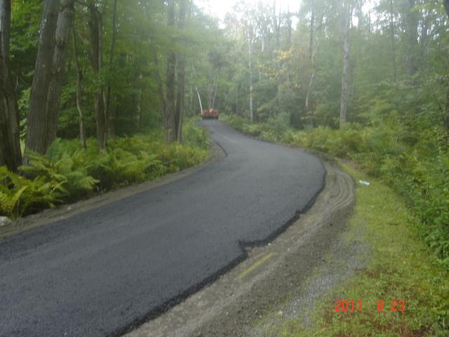

Driveway pavement rough coat is now in place..... I hoping this will end any erosion, and make snow removal easier. Not to mention not tracking sand/gravel into the house every time it rains!:thumbsup:

its my experience that gravel drives need to be topped every 3-4 years.
You need to make shure you have proper drainage (aka ditch) on both sides and crown in the mid.
based on the slope you say you have your likely going to need larger rip rap in the ditches to control water velocity. (aka check dams)
