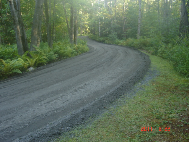

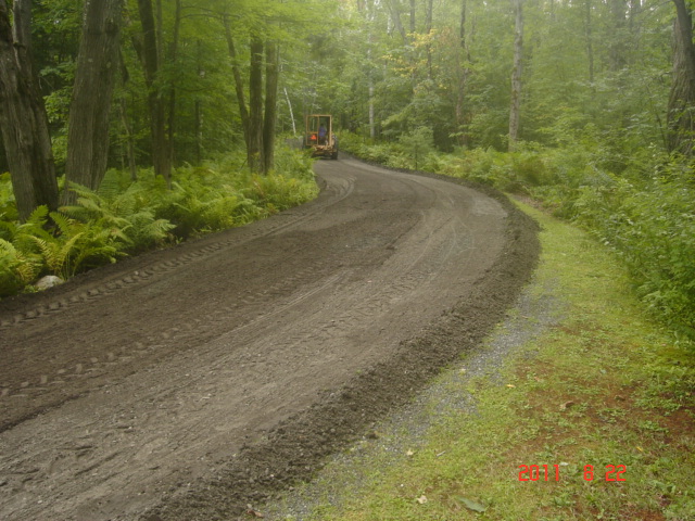

/ Steep Gravel Driveway Too Much Work #8
When I did my drive 26 years ago, the ol' geezer (with only one eye, but that didn't slow him down any!) that did the excavation simply told me up front: "This is going to go over budget, but here's what you have to do...."
He dozed it down 2 feet or more, brought in 350 tons of 5" stone, covered that with another 150 tons of "hardpack" (crusher run). He explained that that was the only way to ensure it would hold up. It's wet here, with a layer of clay 2-3 feet down. We have a great crop of ferns every year....
I've had to do major touch-ups only three times in all those years; it has held up extremely well. My drive is around 250 feet long, 90 degree corner at the bottom, and uphill all the way. Quite steep at the top.
OTOH, I've finally decided to bite the bullet and have it paved! Big decision for us (and pretty $$!!) but something I've wanted to do ever since we built the house. Asphalt arrives today!
At least it has a good stable base under it!:D

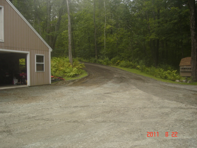

#12
View of driveway looking up from the turn. I just spoke with the local quarry. He said pave it.
/ Steep Gravel Driveway Too Much Work #13
Hard to tell how steep the grade is from the picture but I don't see any swales to route the water into your concrete side ditch.
Depending on how steep it is you will need some swales placed ever so often to divert the water into the ditch. Google camp road maintenance, there are several good pages on how to properly design gravel roads.
