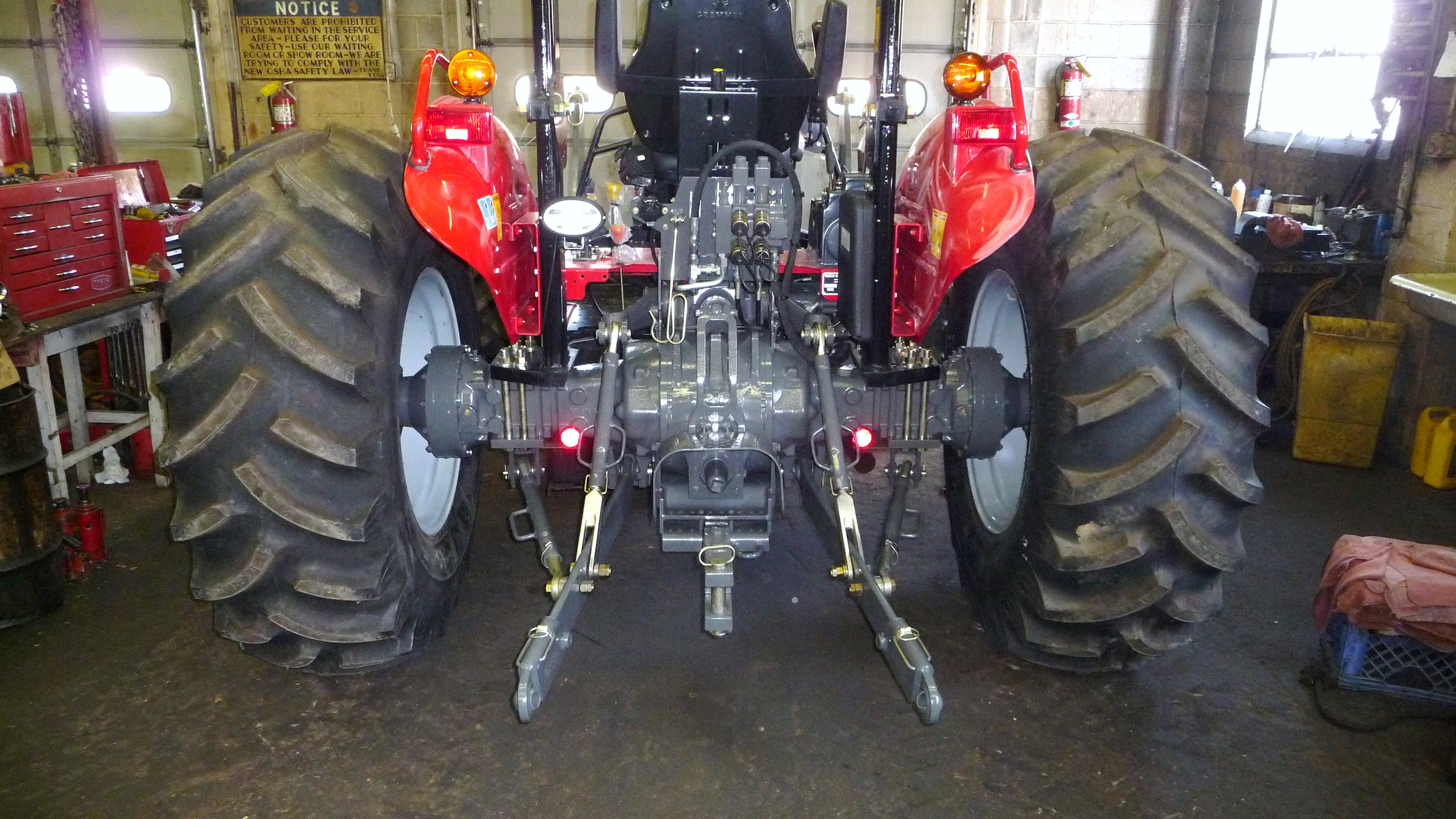

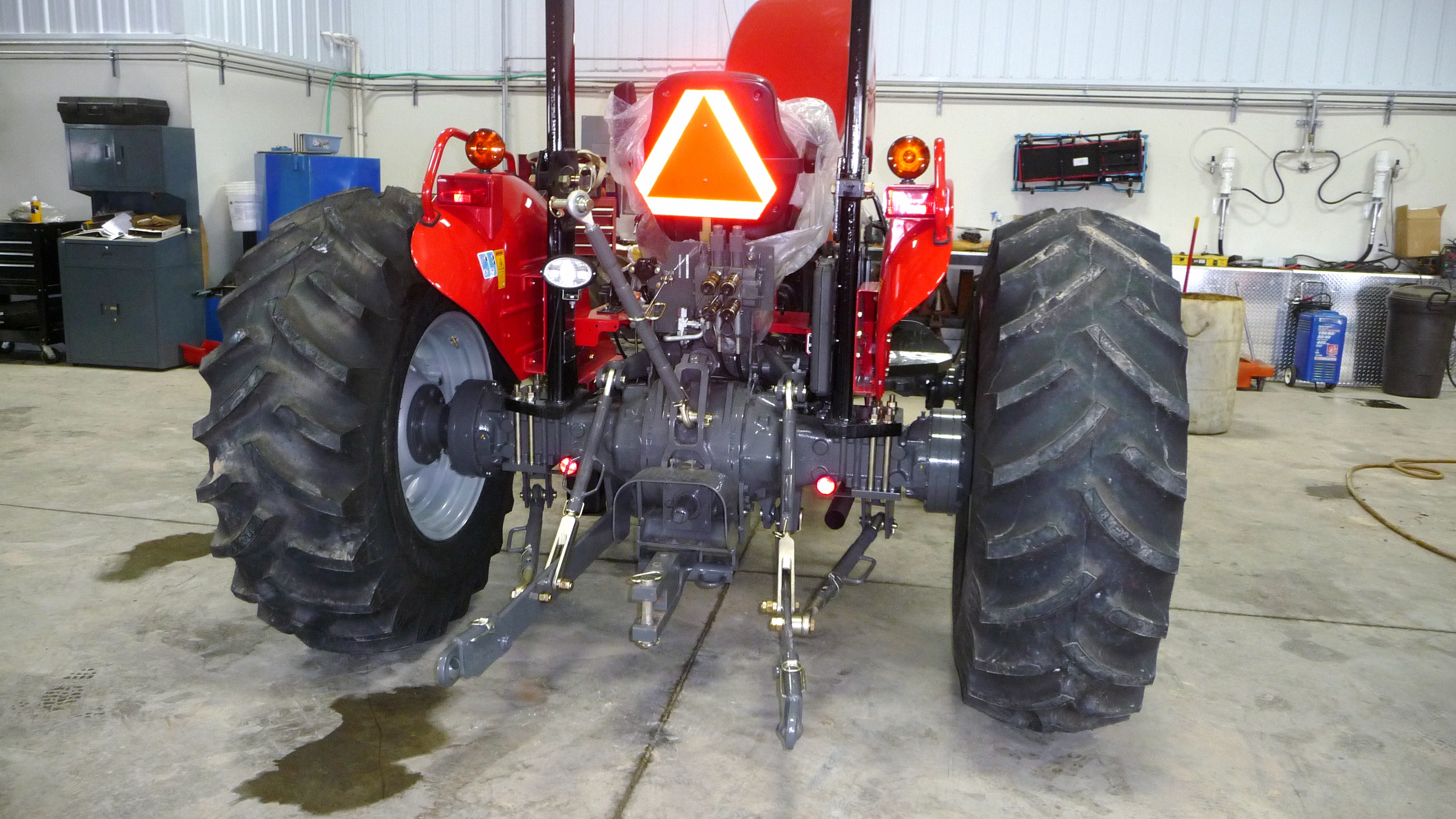

Different brand machine but the principles are the same. My MF2660 is a low profile model which helps and non-cab which also helps. My tires are out to 81.3" centerline spacing and run a little over 8' outer edge to outer edge. I studied the spacing options in the manual and I could go as much as 7.8" wider spacing. I chose not to do that when I bought it due to trailering issues and just awkwardness in storage, parking, maneuvering, etc. I've found the result VERY good for my case. I routinely mow slopes between 40% and 50% but not intentionally over that. I consider my configuration about as safe as you can reasonably get short of a VERY oddball tractor. Here are a couple of pictures of my width settings: MF2660LP while on Eastern Shore (3).JPGIn Guy Bros Shop (2).JPG
