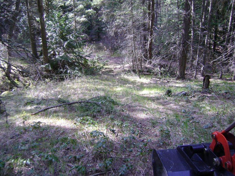

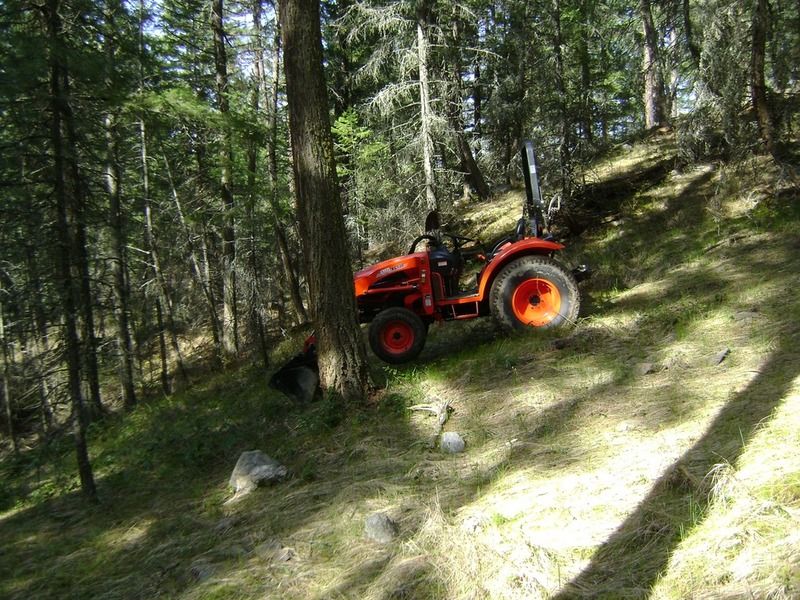

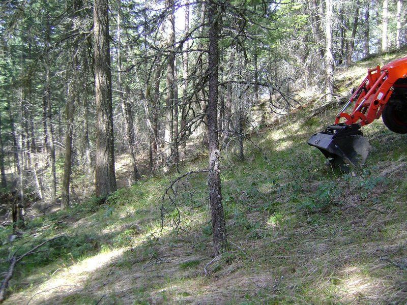

This is probably one of the steepest I've ever done.
   / Steepest grade you have made it up? #24
That looks steep.

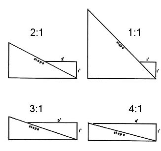

Just a note.
A 45 degree slope
1:1
is incredibly steep, snow will barely hold at that pitch. We humans often over estimate pitch steepness
I snow ski, and pitches are part of the assesment.

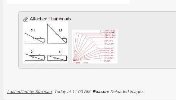

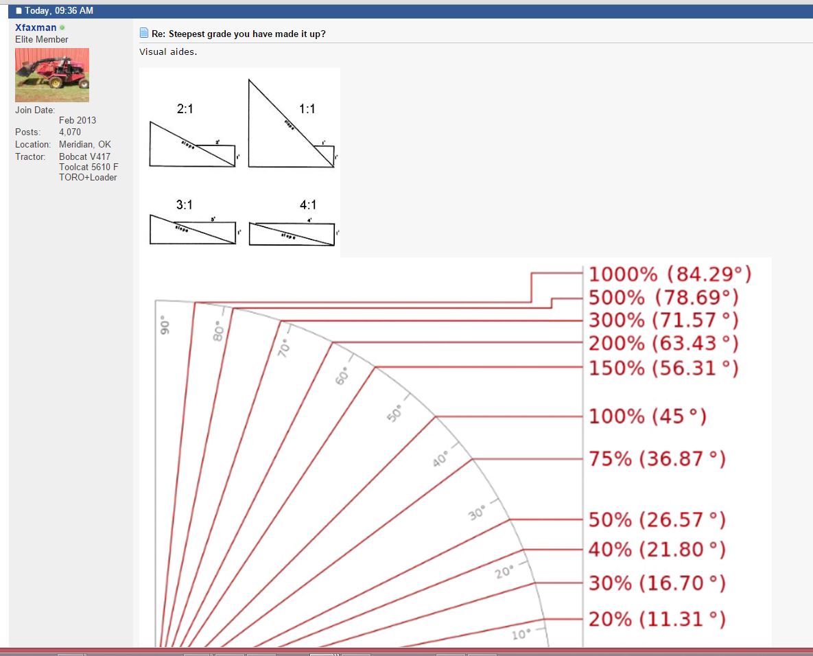

Visual aides.
attachment.php
attachment.php
   / Steepest grade you have made it up? #35
Something tells me that wasn't the result you were looking for. :)
   / Steepest grade you have made it up? #36
Strange, they show up on my computer in the post above yours.
Here is the snip.
424721-steepest-grade-you-have-made-va-jpg
There is something different going on with the photo uploader, I will edit the original post and upload them again.
When I reloaded, it changed the order and added this at the bottom:
attachment.php
