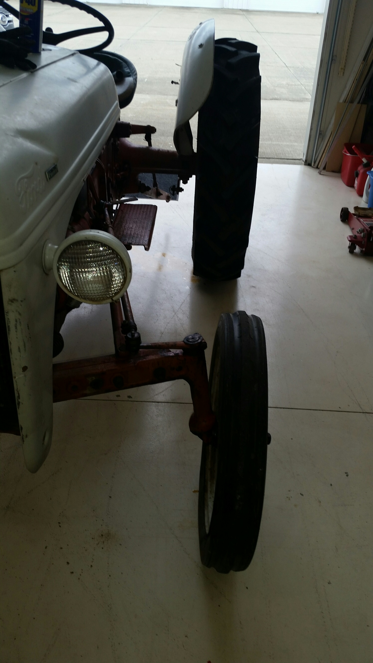

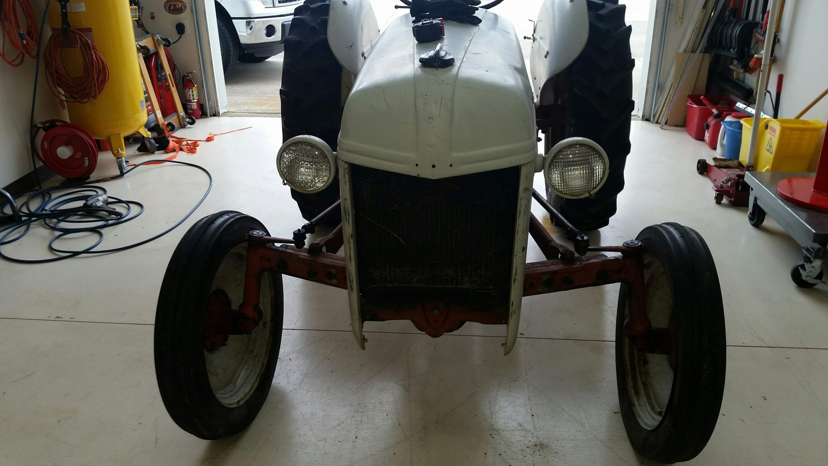

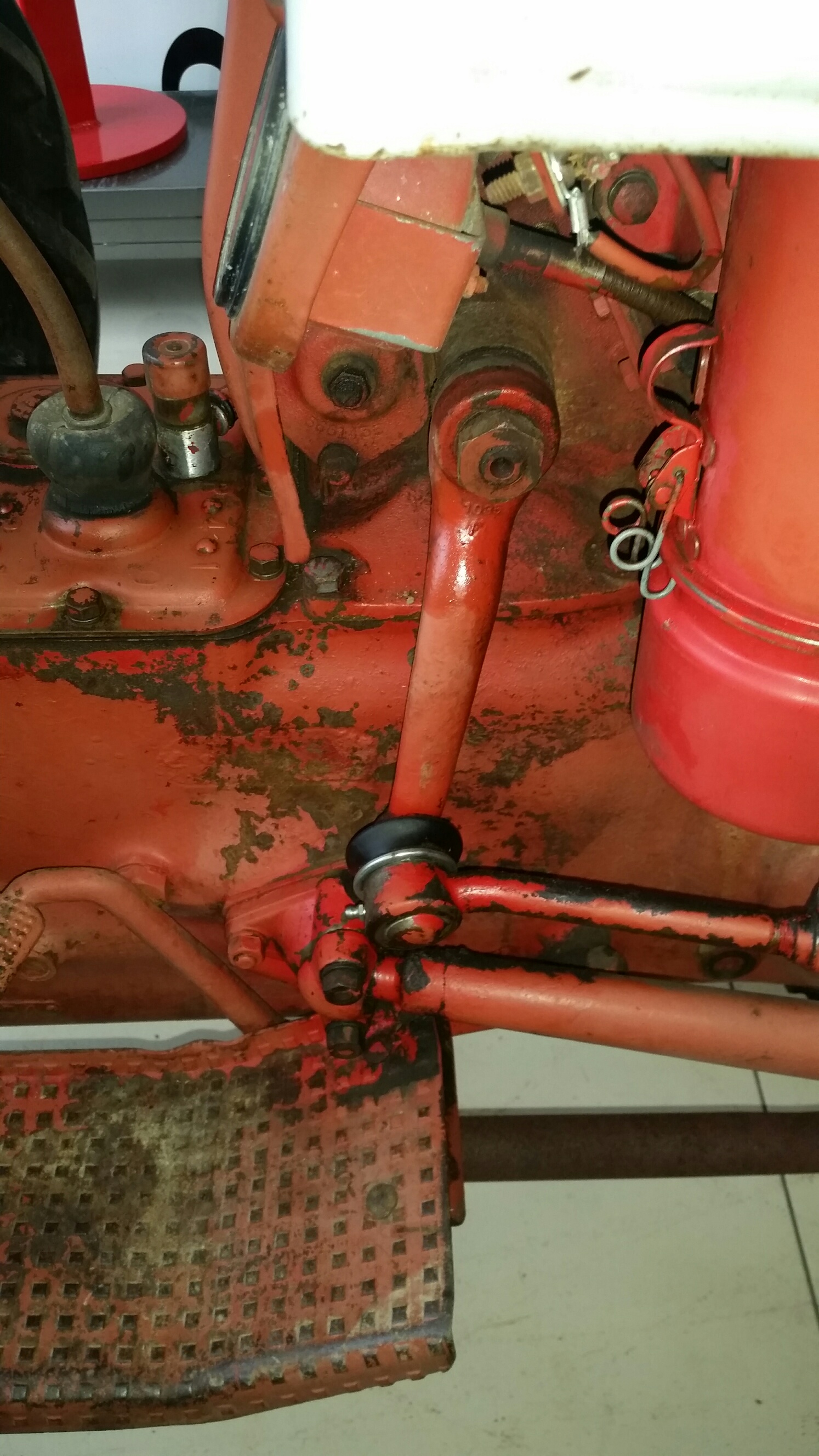

im not sure if the pictures connected to my post. I am the guy who posted this question:
I just purchased a 1951 8N. The left front wheel is straight and the right front wheel is pointed out to the right. I measured the back inside tire to tire the measurement is 46" the front from tire to tire is 51 inches. so I guess it is about 2 1/2 inches out...seems like alot. Is that fixed by repositioning the right pitman arm? If so how do you remove the arm from the spline once the nut is removed? Soundguy responded previously and requested pictures.

   / Steering adjustment for a Ford 8N tractor. #15

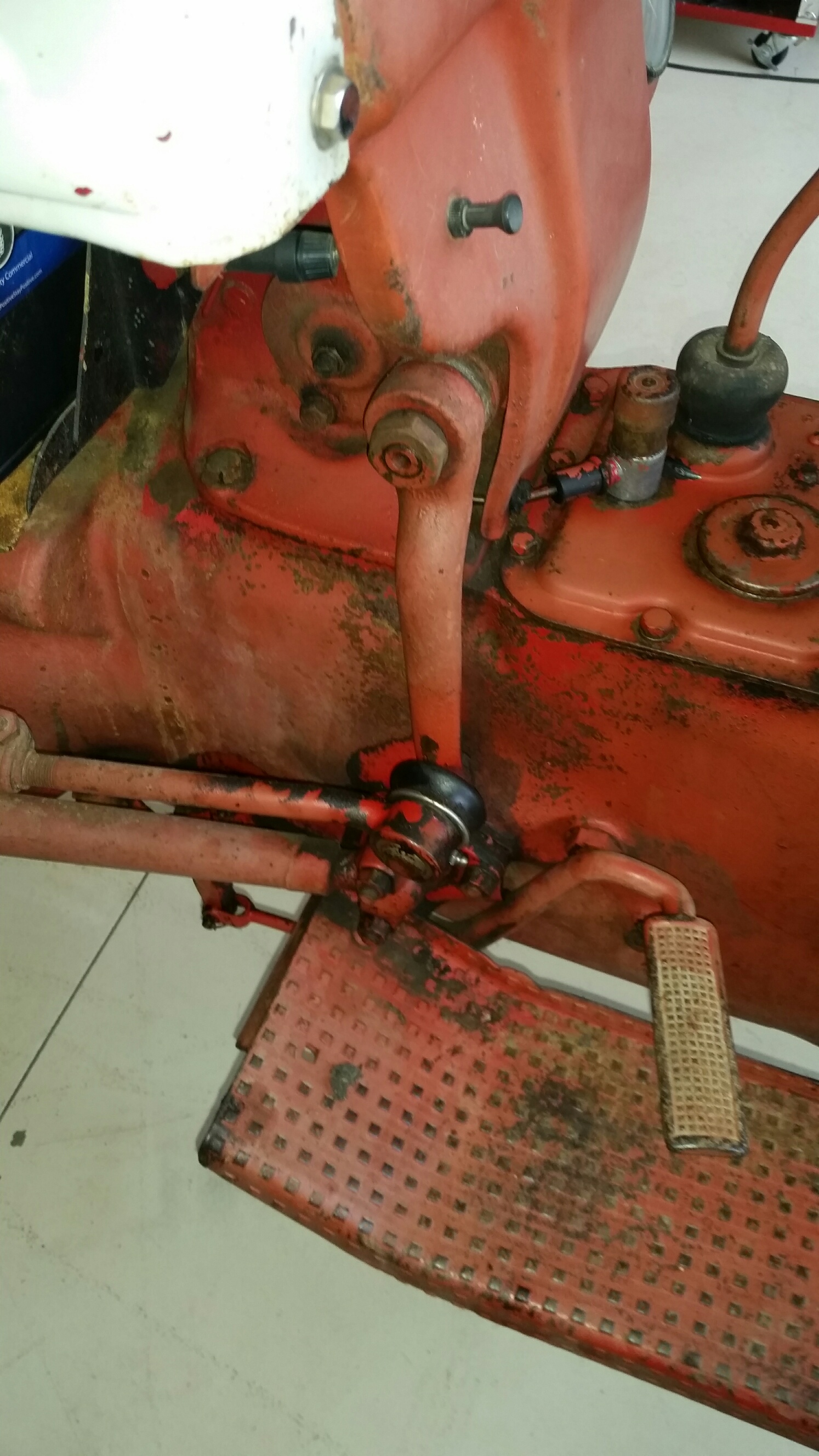

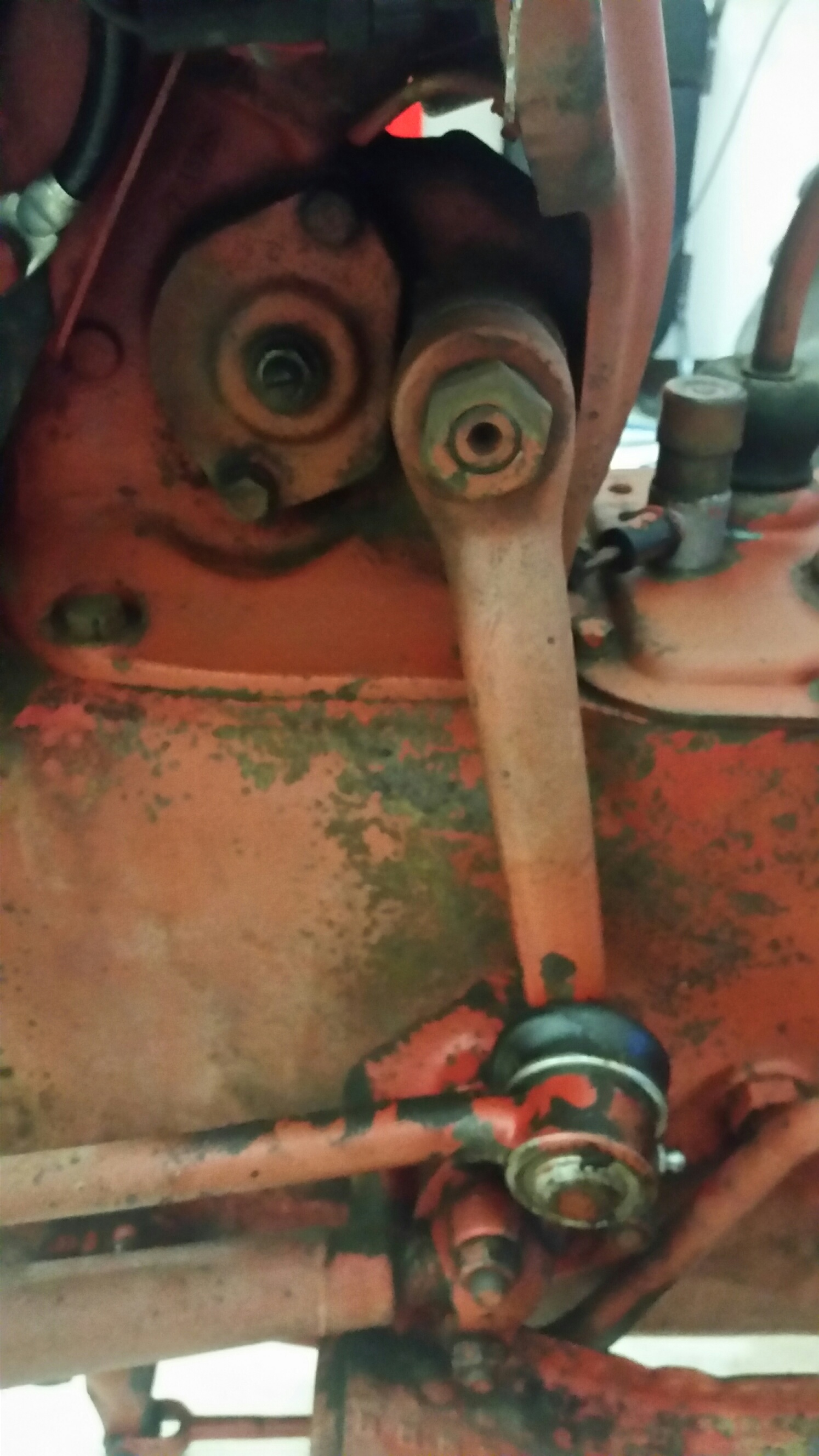

need a pic that shows both sector arms. perhaps from the view of setting in the seat.
   / Steering adjustment for a Ford 8N tractor. #16

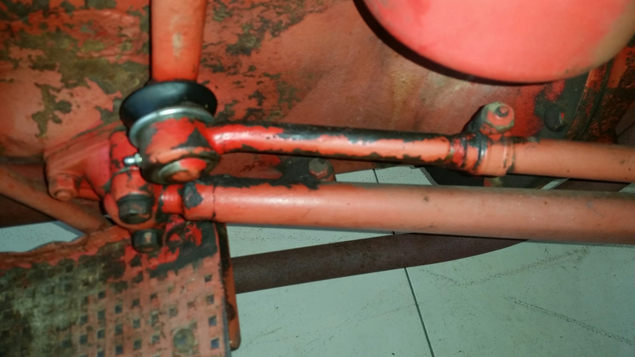

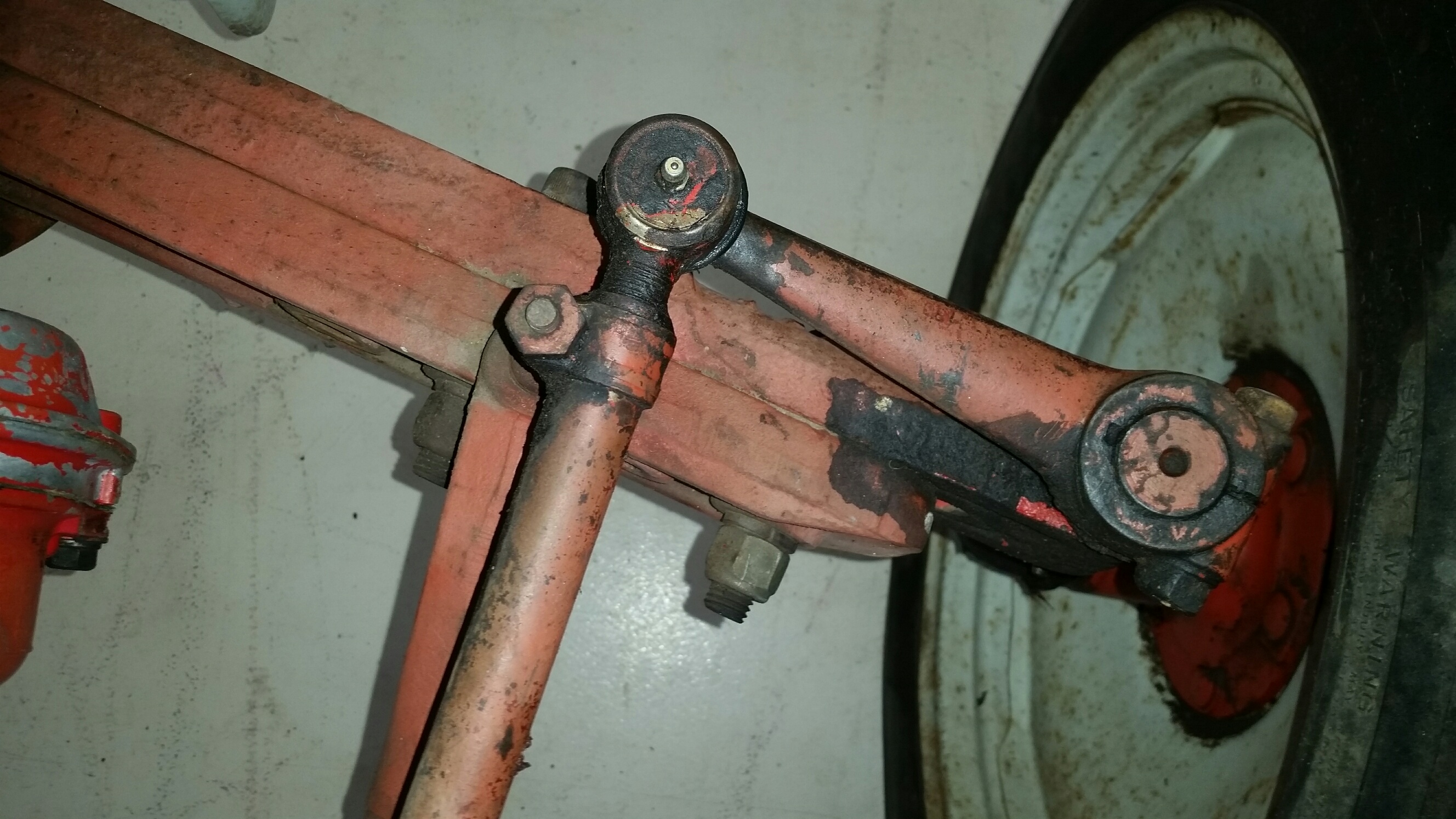

Sorry for the delay I have been traveling. Here are pics of both sector arms from drivers seat and from each side. Even though the right wheel is towed out two inches the steering is correct stop to stop. Same turns at the steering wheel. There doesn't seem to be enough threads at the tie rods to adjust it (see last pics). Thanks for your help.20150520_205723_resized_1.jpg20150520_205728_resized.jpg20150520_205753_resized_1 (2).jpg20150520_205809_resized_1 (2).jpg
   / Steering adjustment for a Ford 8N tractor. #17
misalignment.
both sector arms should be swept back. left looks good. right is deffinately forward... which is why the right wheel is incorrect...
   / Steering adjustment for a Ford 8N tractor. #18
SO....I assume I need to use a puller to remove the sector arm and just reposition it? I didn't see a key-way that would prevent me from just repositioning it. Do I adjust tow to be the same at front and back of tires or should there be some tow in or out? If so where do I find the measurements. Is there an exact science to this or just do it by sight? Thanks for your help.

   / Steering adjustment for a Ford 8N tractor. #19
No, you can't just pull the sector arm off and reposition. If you would have looked it does INDEED have a master spline. The misaligned part is the sector gear and shaft! the forward gear is a double, the aft gear is single. and the ballnut is in front. Ballnut aft side has teeth, it engages front of double sector, aft of double sector engages front of single sector. The service manual has the procedure where you count the teeth to mesh front sector to aft sector.

   / Steering adjustment for a Ford 8N tractor. #20
PS.. toe in.. I like .25" get both tires straight once you fix the box, and then measure front fronts of tire to each other and backs of tire to each other. front toed in 1/4" or so...
