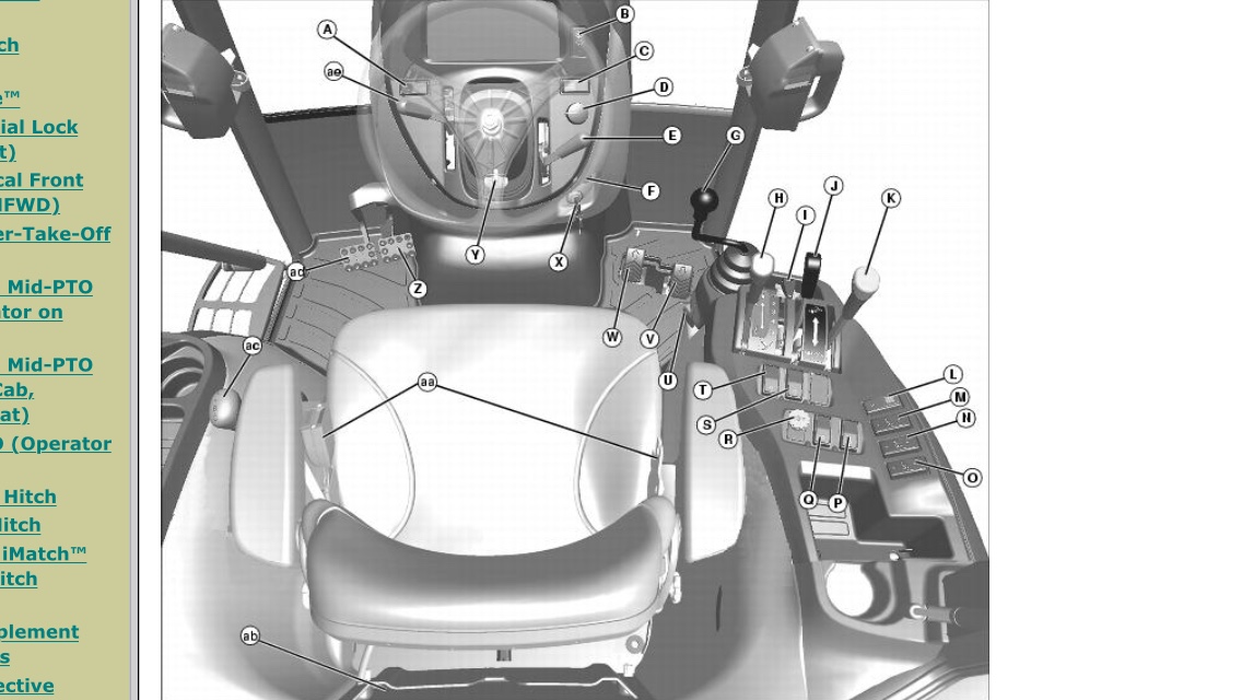

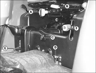

You my friend have the ideal setup and don't even know it.....
There is a lay out, deff lock is "D"
   / Steering Brakes,,, A Necessity,, Or A Nicety?? (41HP, 3000 Lb Tractor) #84
The YTM we rented had a heal actuated differential lock as well. Used it to.....
