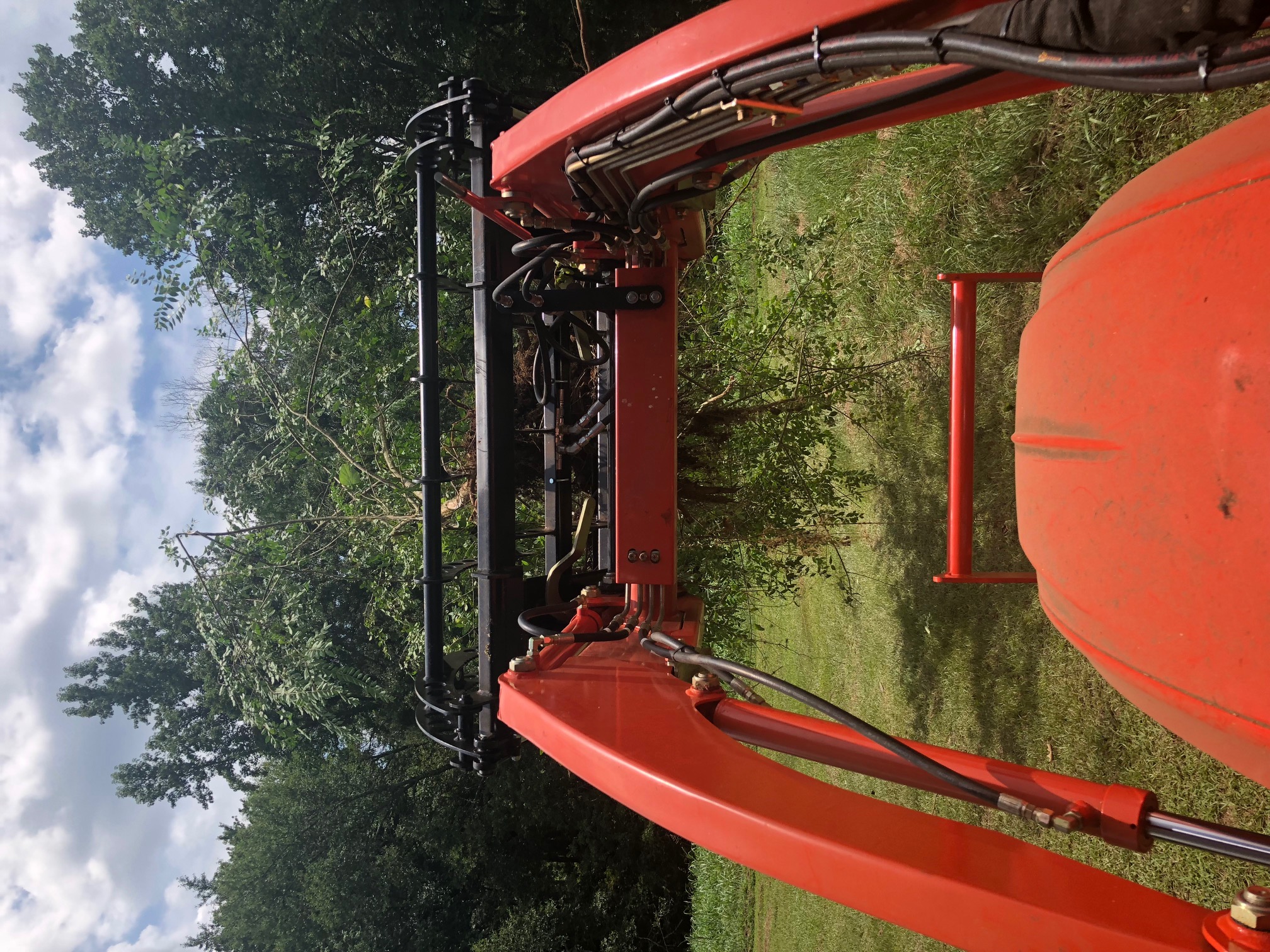

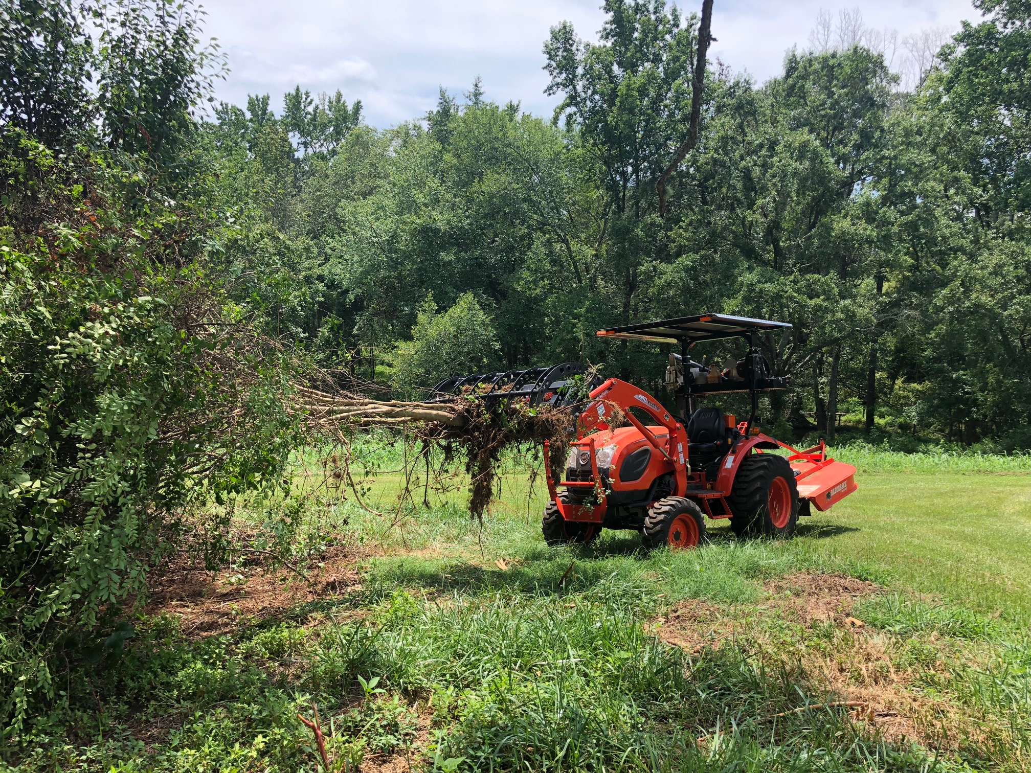

Heres a 2610 ripping out some privit hedge by the roots today. You gotta work it around though. Several angles before the roots give way and pull out. But it seems to me its then more the tractor doing most that work and or bogging when it hits roots than it is the loaders capability... I am guessing. But it does it.. it does the work.
