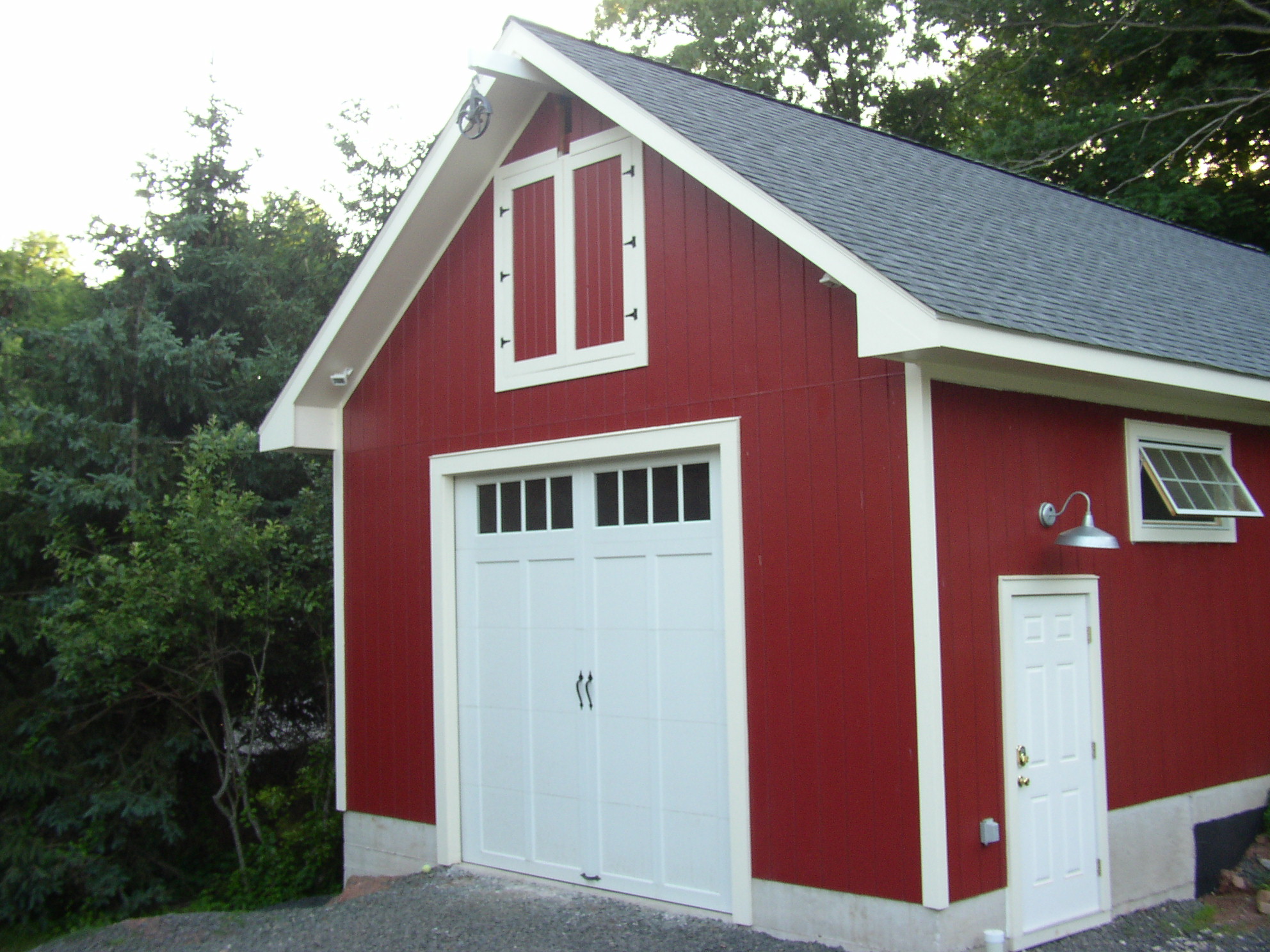

This is really late in the thread but oh well, ....
I agree totally, I had the exact same thoughts. What I did also: 8 inch thick 4000psi slab so I could later install a 2 post car lift if I want, 100 amp service, six 8 foot floresent overhead lights, a big through wall exhaust fan, an industrial ceiling fan. The roof is 9 in 12 pitch so it has good walk around clearance and a 3/4 inch plywood attic that i varnished. The steel beam and trolly is really good at moving large things into the attic loft. The front door is 10 x 10, you can see the peterbuilt parked in the barn during construction, it fits fine. What I screwed up was not pitching the concrete floor enough toward the front overhead door, a good pitch would have allowed ice melt to run out or a little hose down action. I had plans to 5/8 inch fire code sheet rock the back welding area but just use portable spark sheild which seem to work fine. I really like the 2' concerete stub walls, this was to catch the sprarks and splatter. What my wife liked was that it looks good, it is the first thing you see when you come in, not industrial despit the 20' peak and 10 x 10 door, which is on torsion springs to save space. There is no heat, I don't want to spend the money, as it is I get by with a 110K btu kerosene salamander heater and burn about 10 gal a year running it every once in a while... There is over 11 and a half foot of clearance to the bottom of the attic floor joists. The building is 20 x 36 foot. The two side windows can be left open and are very high off the ground, give light but you can't see in or easily get to them. Remember to scrape off the good soil and save it seperatly so you have it for top soil later.... Glad to see your project turned out so well. It took us a while also, but after the better part of a year I can finally get to the projects built in the barn...

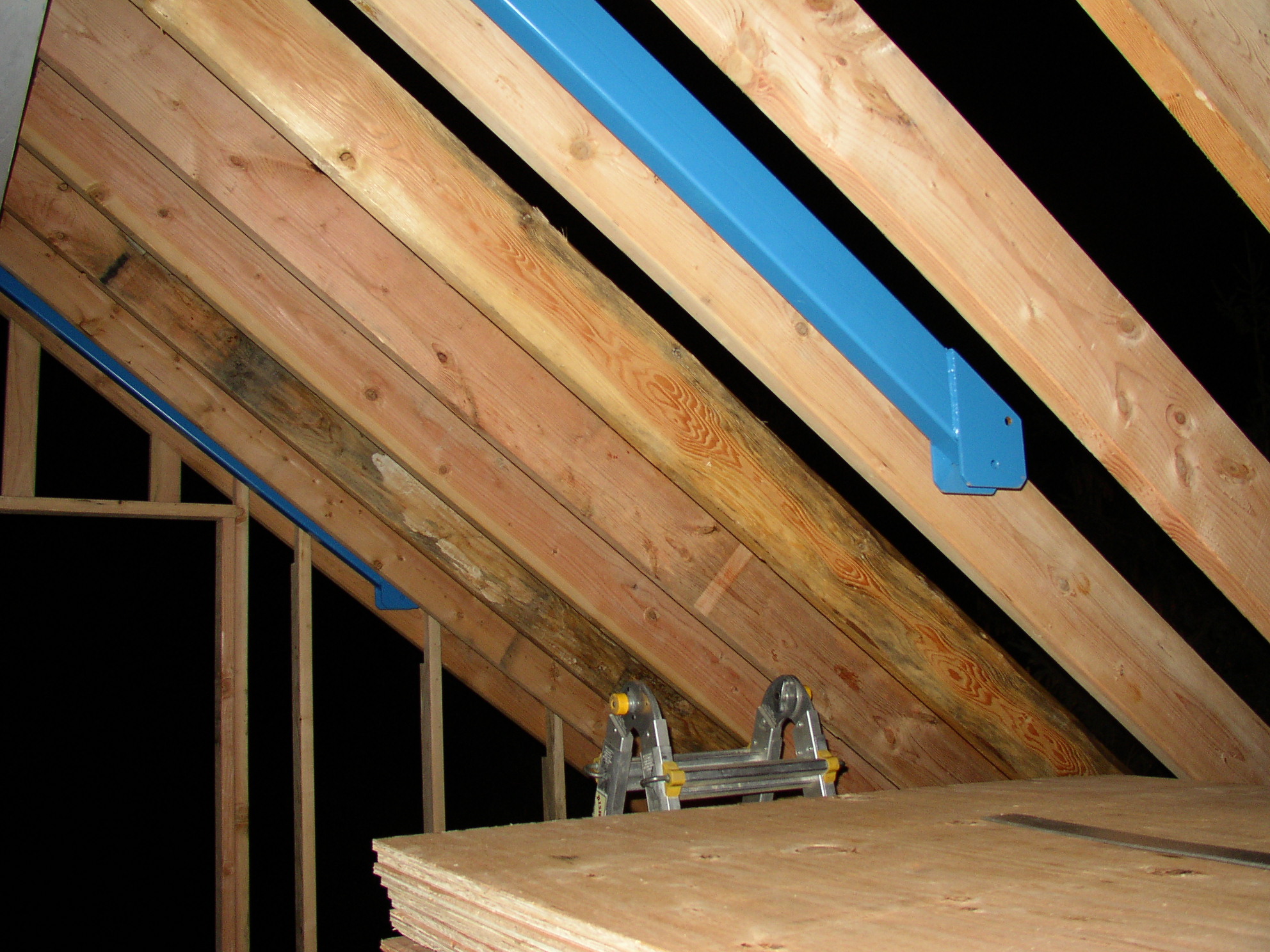

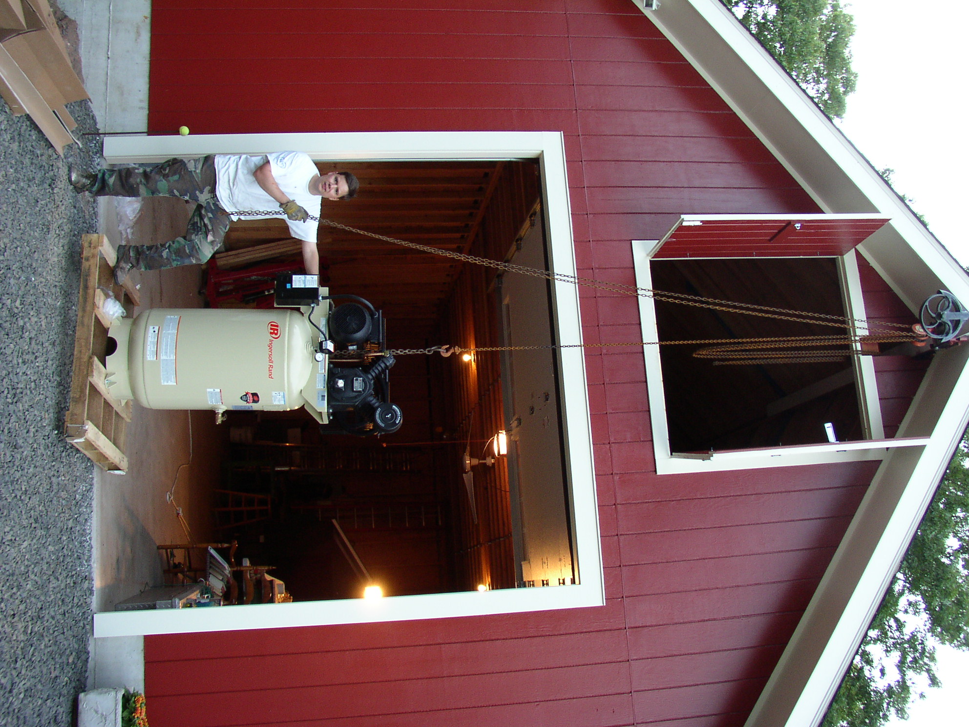

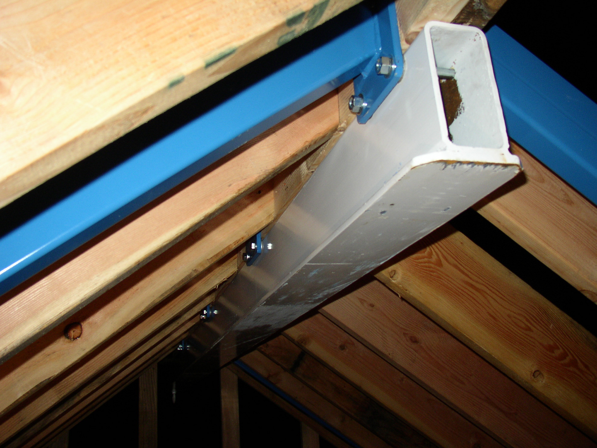

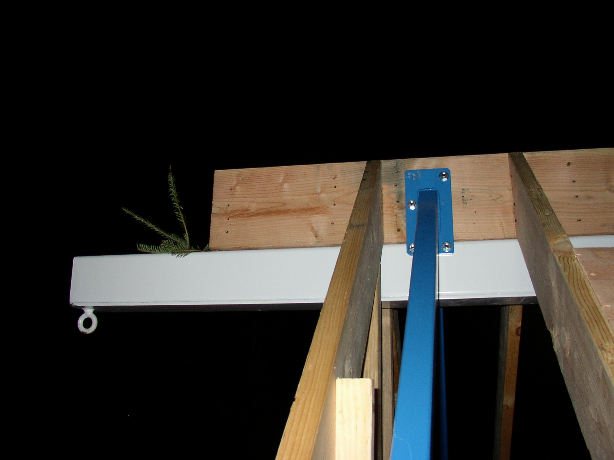

I'm curious about the beam and trolley and how you have it suspended and attached to the garage?
Wedge
   / Step by step photos of new garage #418
Wedge
What I did is make a double ridge beam so it would be 3 inch thick. I used 3 by 6 inch by 1/4 inch steel tubing to which I welded 3/8 by 6 inch flat stock on the bottom to form the trolly run. I used seam sealer to fillet out this joint prior to painting so it would not be a rust trap. I made two sets of brackets to bolt through the ridge beam and four tubular legs that followed the roof pitch then dropped down to the attic deck and were bolted into doubled floor joists. The brackets that join the pitched part to the vertical part are shown in the 51 picture. I waited a long time to bolt the bottom of the legs so that the barn structure would be all dired out and shrunk. All the bolts are grade 5. The holes are all 1/2 inch and all line up because I used a milling machine to bore them. Every piece of metal including the tubing with the plate welded on were all cut with a milwaukee dry cut 8" metal circular saw. This is by the way a fantastic saw. I get many projects out of a blade because I use guides or jigs so I never pinch the cut. I have cut both 2x2 solid and 3/4 plate with really no problem. The ring and pully are really for looks or hauling up single small bales of hay. The trolly gets used with a four part part block and tackle or a light chain hoist. With this set up I can easliy put everything from a small boat to the tiller or snowthrower up there on the off season. If I were to do it again I would have used a much longer beam so I could get deeper into the attic. The beam was found metal so I can't complain, it was about 12 foot long, the over hang is 2 foot of roof, 3 foot of beam and the reach into the attic was about nine foot. All in all it works well. I don't get any bad noises when I pick up 1000 lbs or so and the wieght is not all on the rafter to sill plate connection either. In these pictures I have not cut out the space for the trolly to go through yet and the vertical legs are not in place yet. That 7-1/2 hp air compressor wieghs in at about 650lbs. (I worked for a division of IR so I got a good deal on it...)

Very well done... the welds look great!
   / Step by step photos of new garage #420
Nice job.. I would have never thought of something like that. I'll have to keep this thread handy for when I build my shed. The big difference is I plan on using a gambrel roof. I'm interested in putting the hoist in the lower section and anything else I'll lift up with the front end loader and boom if needed.
