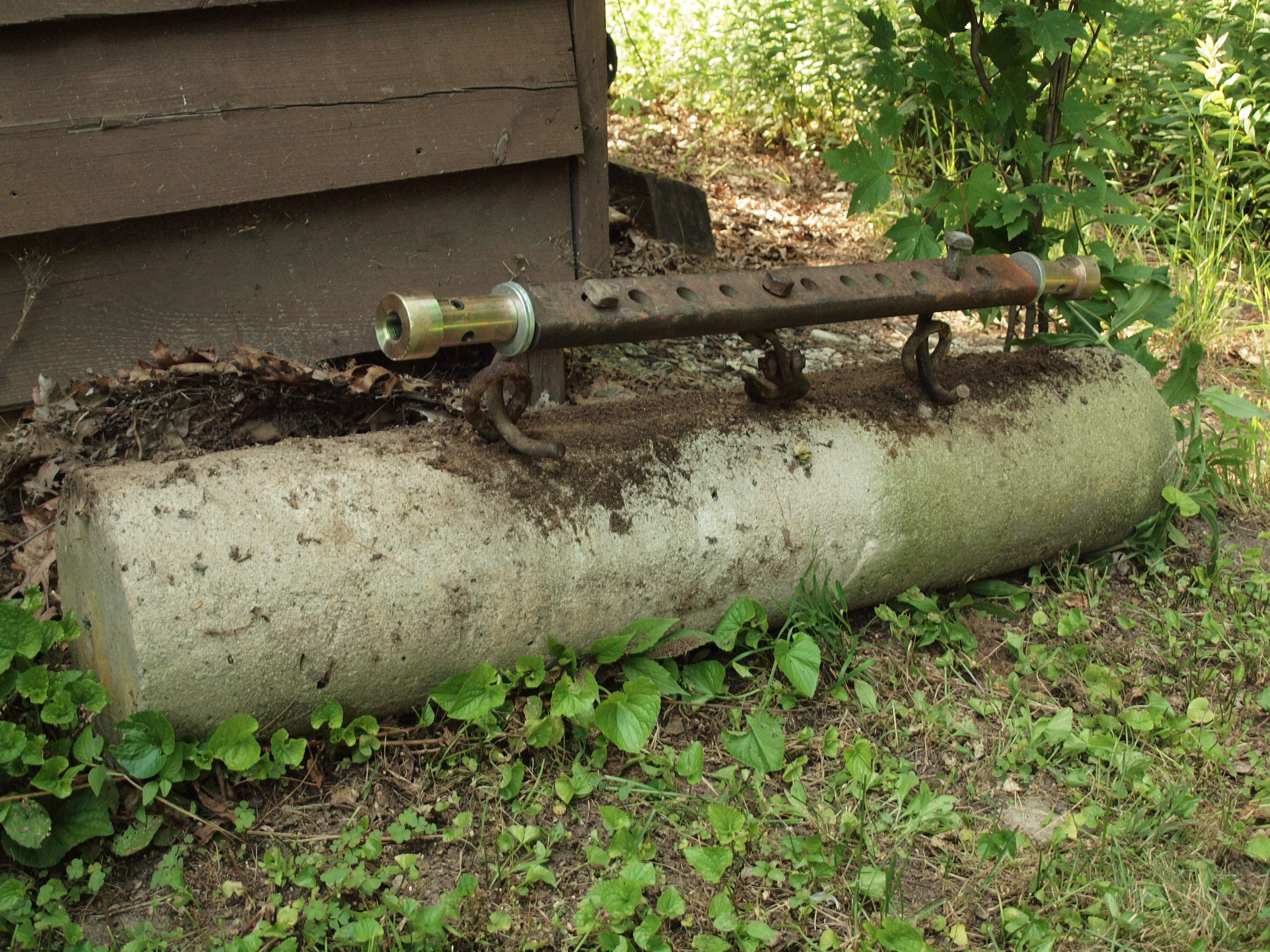

I'm thinking of casting a concrete ballast with 3 chains hanging out. I have this notion that it should be VERY easy to attach to the 3-point. What if it attaches loosely, for super easy hookup? What are the drawbacks to a ballast that is loose? I suppose if you have to travel with it in 3rd gear that could be a problem, but I don't see that as likely for me.
The biggest problem I see is forgetting its there and backing into stuff with it, so shorter is appealing.
I made a ballast by mixing concrete and pouring it into a 4' long 10" Sonotube . I took 2, 1/2" thick , 12" long eyelets and bolted them across the tube. I then filled with the mixture. All I do to hook this up is to mount my 3 pt draw bar and through the holes on the drawbar, place a couple of "hooks" through the hole and thread the hook through the eyelet. I made the hooks with some threaded rod and bent them over. A bolt at the top prevents the hooks from falling through the drawbar holes. Takes about two seconds to engage and disengage with enough leeway to only have to get the tractor "in the vicinity".
arrow... do you have any pics of this?
   / Stepped off, and it almost tipped over (lifting a snowmobile) ! #98
