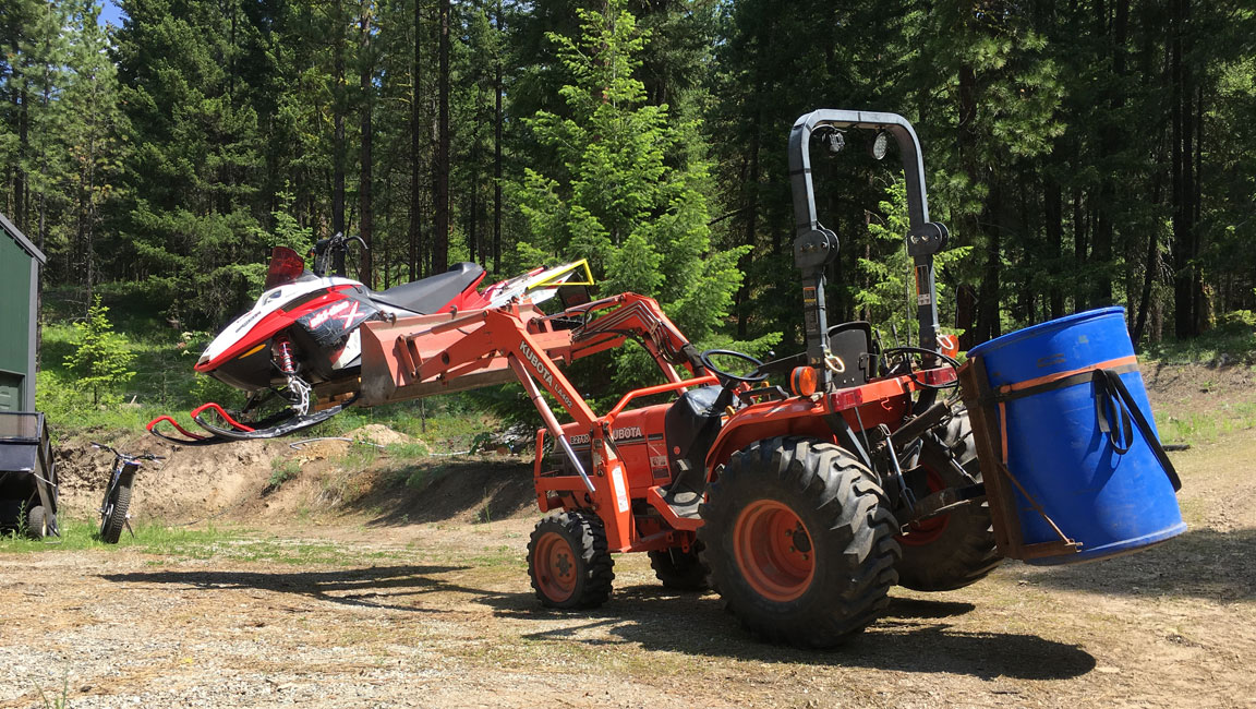

Some of you fellers remember this from way back in 2014?
378575d1402291486-stepped-off-almost-tipped-over-b2710_skidoo800r_16-jpg
The opening post of THIS thread generated some "lively discussion."
I know you fellers thrive on action photos...:D
Here I am in 2019... moving the snowmobile again to it's 'summer storage', now with a 400 lb counterweight (50 gallons of water).
(building the counterweight---->) 50 gallon barrel for 3-point ballast (400 lbs)
607650d1559674039-stepped-off-almost-tipped-over-brushfork_snowmobile_tipping_counterweight-jpg
I got off the tractor, and lifted on the right rear wheel, just to see how much more stable it was....
To my surprise I was able to lift the wheel.
Something like 100 lbs of lift and it came up.
Well.... in any case it's MUCH better with the counterweight!

I think he's referring to the fact that after 4 years you haven't learned to keep the load closer to the ground. There's no reason it needs to be 4 or 5' off the ground.

In 5 years I've prob lifted a rear wheel a hundred times.
You get to know your tractor when you do a lot of work with it and this tractor has done a lot.
