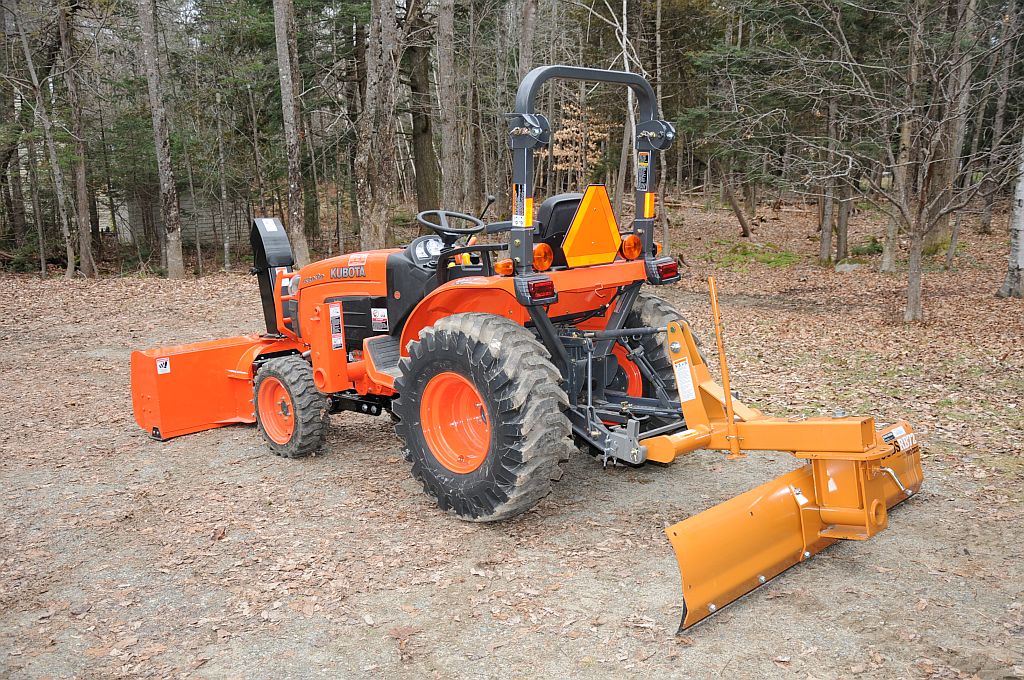

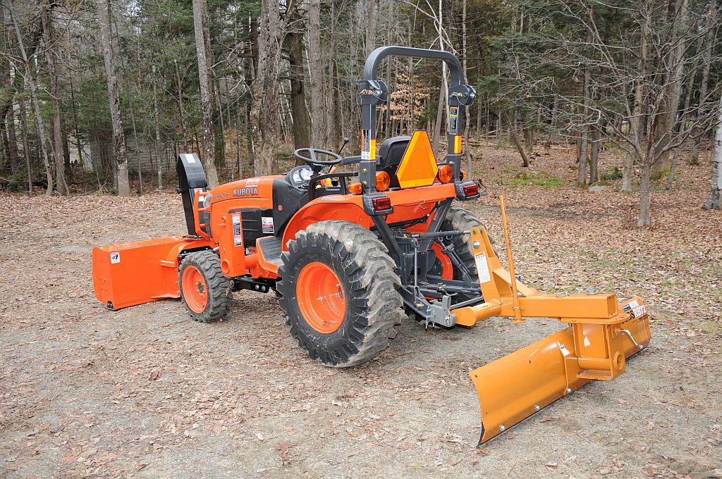

I had some scrap pieces of steel and needed some welding practice, so I made a fuel filter guard. I didn't have any equipment to make the curve in the steel, so I angled some pieces to make the guard (copied one I saw on TBN in the past.)
I fashioned another bracket for the additional LED's on the ROPS bar and mounted those. The pictures are not real close-up views, but I added the pictures below...you get the idea. The lights appear to be mounted off center of the bracket, because they are. My intention is to mount two more rear facing lights toward the outer portion of the bracket underneath the forward facing lights.
I also traded the drag links that came with the B3030 for drag links from a
B3200 that didn't have the adjustable ball hook ups. I do a lot of pushing with the rear blade and made this same modification (3RRL inspired) to the BX1800. I welded a piece of quarter inch square stock on the bottom of the link before adding the Patエs EZ change kit. I couldn't get enough of the reinforcement under the bottom front curve of the link, so I added a top piece of stock, making an I-beam on the forward most part of the bar.
That's the update on the new rig modifications from snowy Maine.

I did shorten the ROPS upper piece...well, I had a machine shop do it for me. I can get in and out of the garage now and prefer to have bar up full time, because I know I'd skip putting it up for small jobs and thought that it was better this way. I saw one that "Gomer" did and liked it, but know that I'll be criticized by many on TBN for doing it. I also know that if the modification was something that prevented a future buyer from making the purchase, the top piece can be replaced and made to original form.
I bent my drag links on the old tractor and 3RRL had made this simple modification to beef up his links. I've never had a problem since, but have also made some additional equipment changes. I have skid shoes on my blade now and that prevents it from digging into everything so aggressively. I also cleared many of the obstacles from the yard that get hidden when the snow hits, so that's probably helped a lot. Dyer, retired
