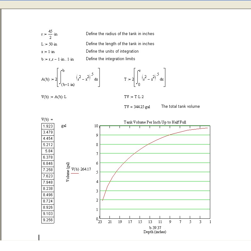

So you have a cylinder 45 inches in diameter and 50 inches long.
The volume is pi * 22.5^2 * 50
But you want to know how much is in the tank per inch on its side.
If you know a little calculus you can do this easy.
The formula for a circle is x^2 + y^2 = r^2
So x^2 + y^2 + 22.5^2 = 506.25
Transpose the equation to get y=square root(506.25-x^2)
Now a circle is technically not a function but to get around this
you use the positive root of the equation.
So integrate(square root(506.25-x^2)) and multiply times 50 to get the volume.
Use integration limits of 0-1, 0-2, 0-3,.......0-44, 0-45.
Then multiply the amounts you get by 2 since you only used the positive root of the equation.
This will give you the volume at each inch of height in the tank.
You will have to convert cubic inches to gallons.
Pooh Bear

Attached is an image of the calculation described by the previous post. It shows the volume per inch up to half full for the tank as described.
