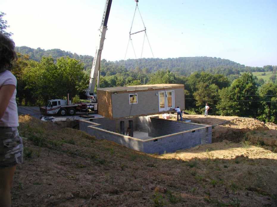

Well you asked, this is the first of 6 modules going in. We have 4 bedrooms and 2 full, 1 -3/4 and 1- 1/2 baths . just undr 200sqft

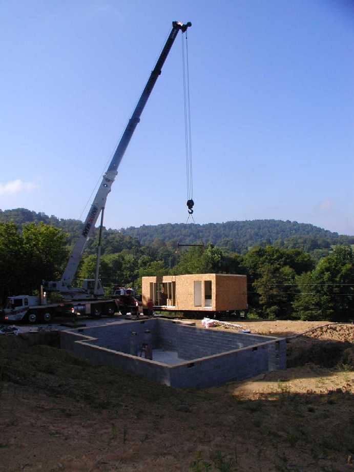

Actually just under 2000 sq ft, basement is just under 1200 sg ft

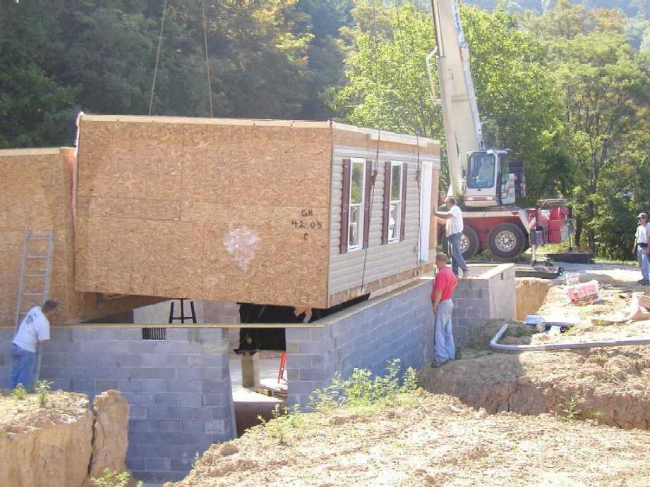

This is where it gets tight, its amazing how precise such a big machine can operate. It took several minutes at this point of "fine tuning" with the crane.
