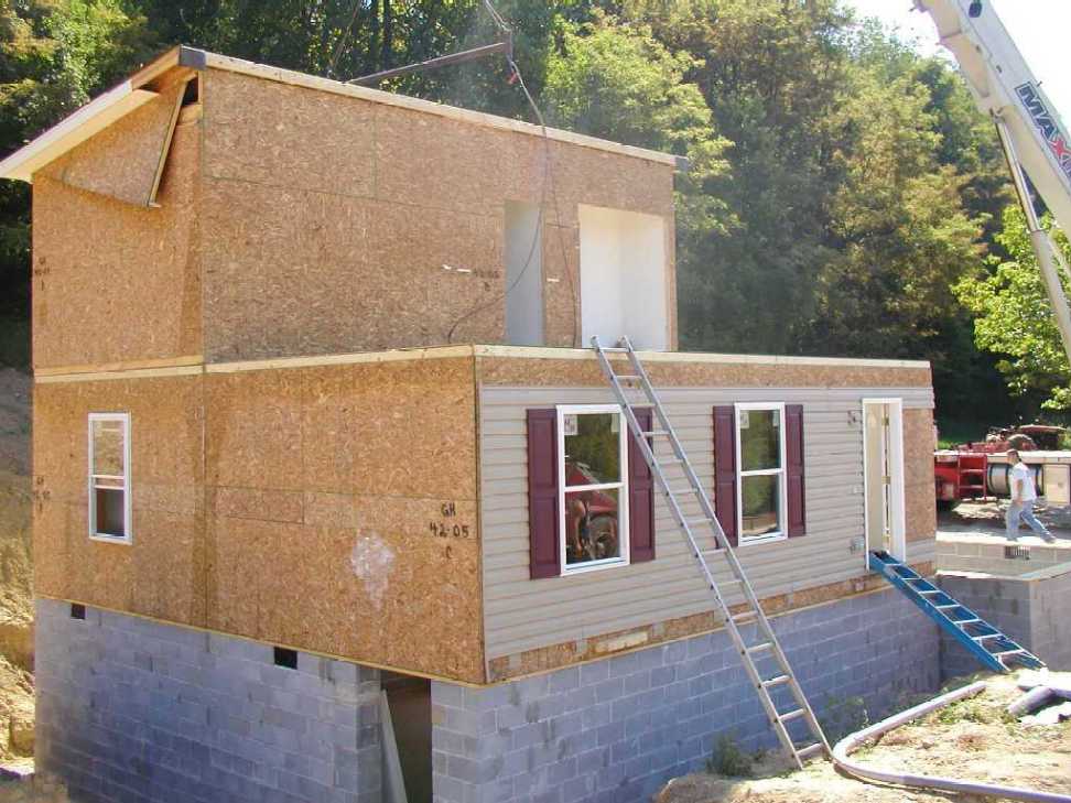

   / Stick Built vs Modular #42
3rd module in place

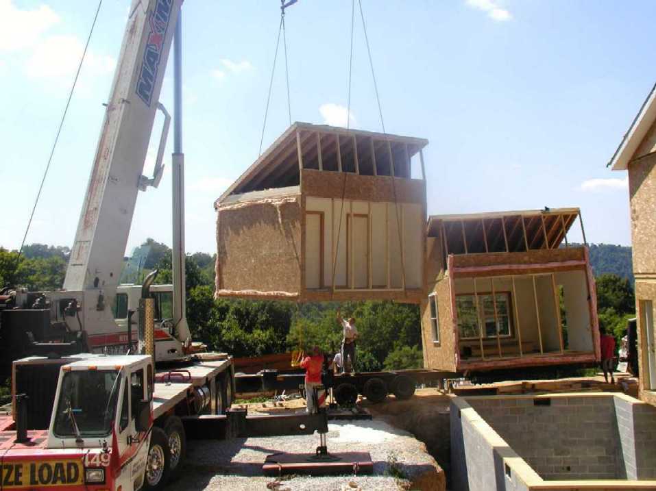

   / Stick Built vs Modular #43
They use the crane to put the roof in place, this part is like a manufactured home.

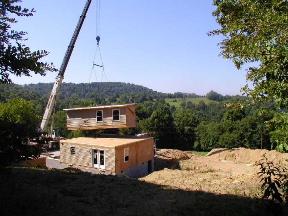

   / Stick Built vs Modular #44
Finally, this is the Maser going into place. When the weather improves I will get a finished shot and post.
