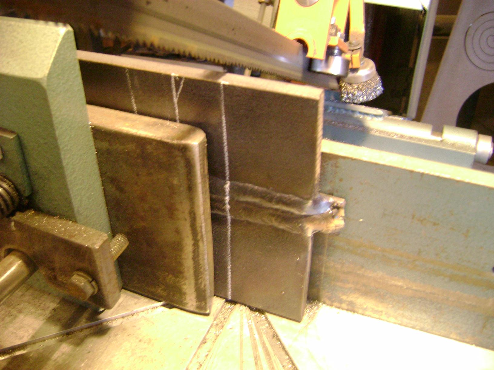

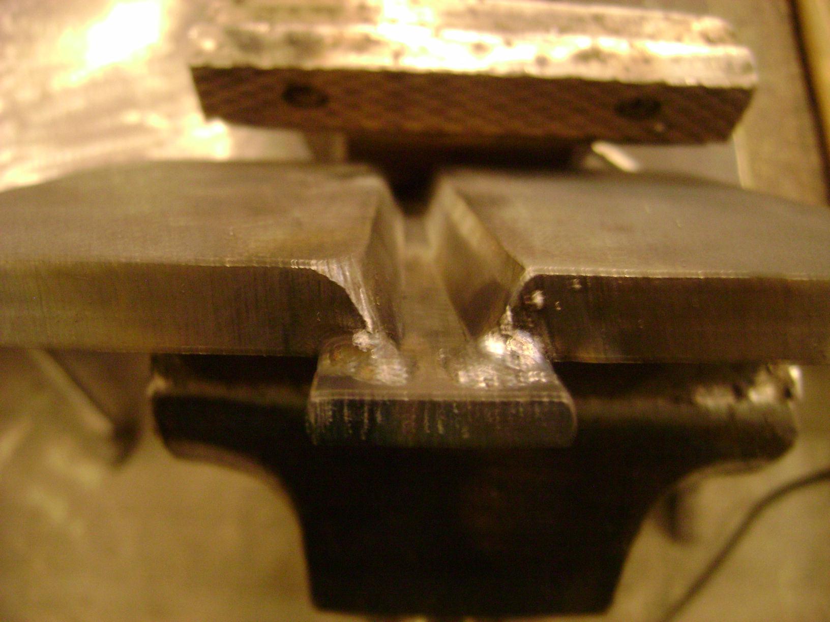

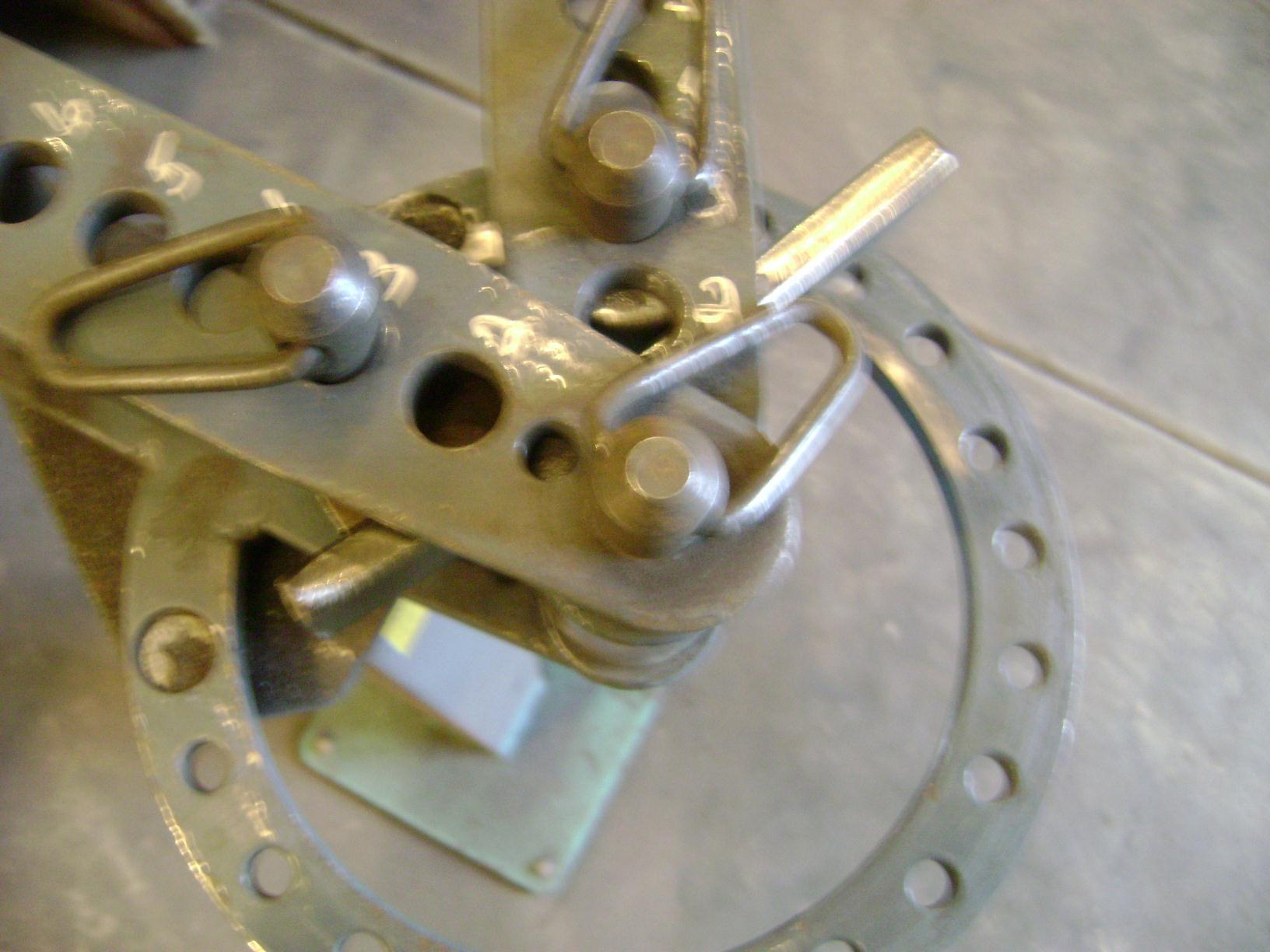

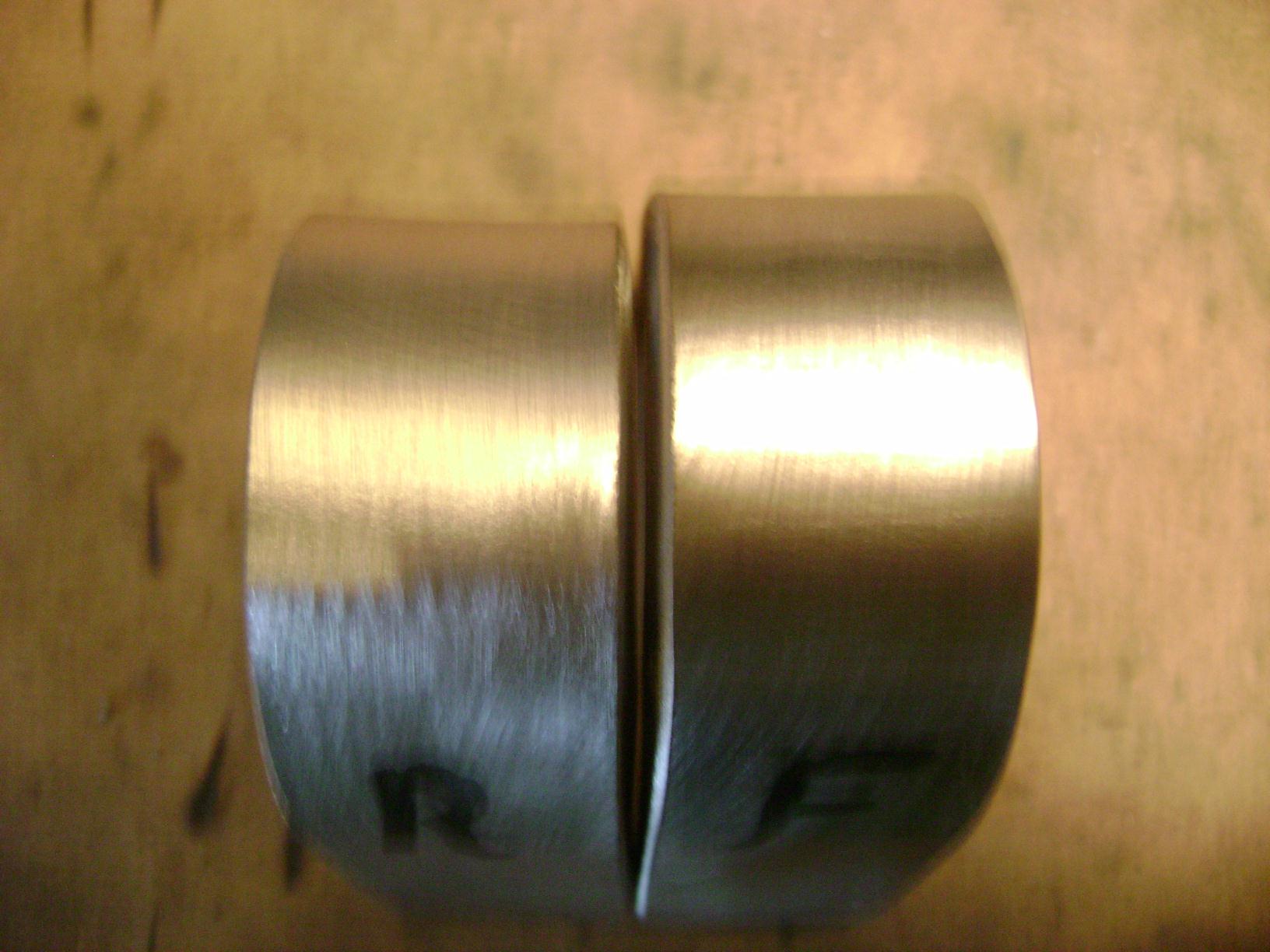

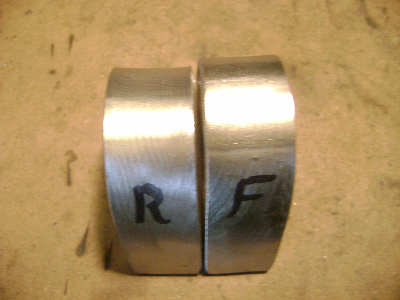

I think it is so strange that 7014 will pass a bend test, but have next to nothing for impact quality!
Not sure if I posted these test results of a 7014 weld here or not.

/ Stick Electrode Smackdown (with video) #8
I think it is because it is so hard that on a bend test where the coupon material can bend, the weld doesnt have to bend a lot. Most of the bending is in parent metal, whereas when you force the weld to elongate, it wont and just snaps. It has the 70 KSI tensile on straight pull, just no ductility. I havent looked up the stats on it, but I would bet it hasnt much elongation before breaking.
