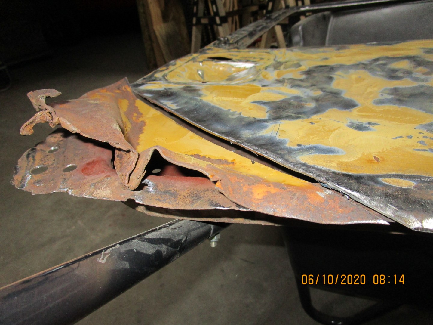

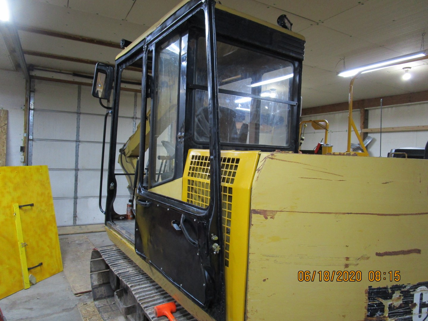

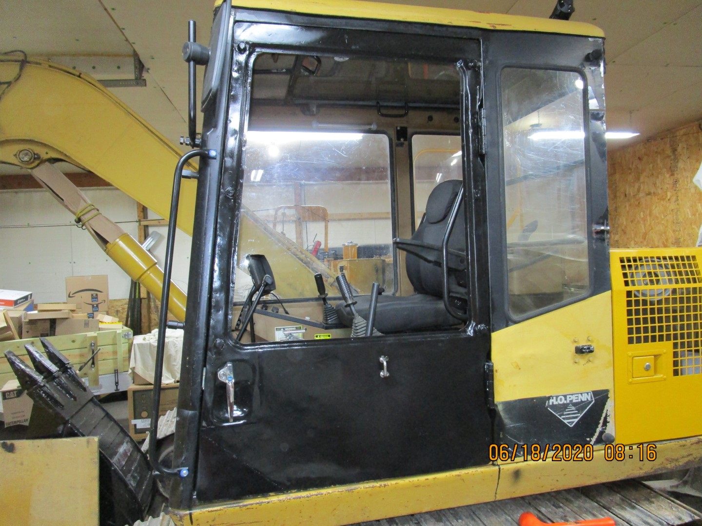

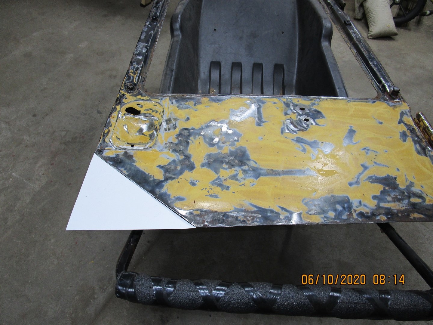

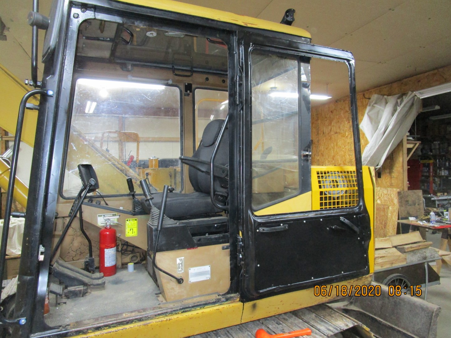

I have been driving stick shifts since time began, back when we used to rub sticks together to start cooking fires..... [ still no patience welding thin stuff ] Got the door beat fairly straight, somewhat welded together, covered in black paint, and back on the machine.. Not proud of the welds, but works. Thank God for no close up pictures and black paint....
