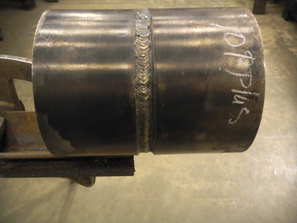

I'm new to this stick welding game myself;). Personally I think you would have better luck starting with 5/32-inch 6011. I really like Hobart's 335A 6011. Reason I say 5/32" rod. It is a lot easier to see the ripples than with 3/32-inch rod. I also believe people run 6010 / 6011 too hot, you have to find the sweet spot for amps, once you do that it is easy to get the stack of dimes look. Here is a 5/32-inch 6010 hot pass on a piece of pipe.

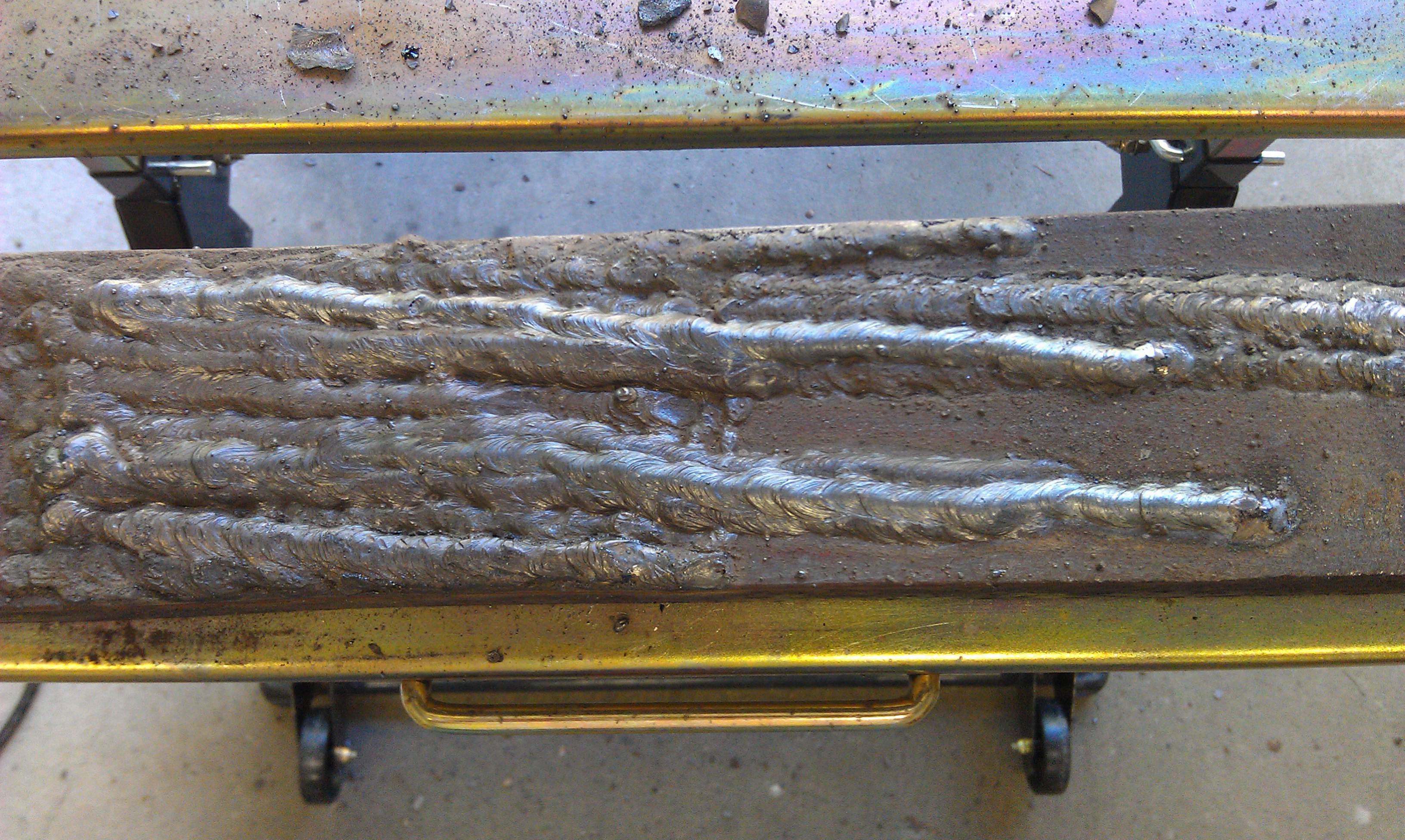

Got some 7018 tonight a ran a few beads, most all of this mess is 7018 beads. Its covering the 6011 practice from last night. The last bead down at the bottom edge of the material is 6011 done tonight. Not terribly proud but I am getting the hang of it, kinda.
Chris.

/ Stick welding practice? #17
Chris.
<img src="http://www.tractorbynet.com/forums/attachment.php?attachmentid=323520"/>
Getting there but seems like you are traveling too fast.
Are you just dragging the rod or trying any type of pattern?
Also practice on a lap joint; laying flat beads on plate can be discouraging at first

Running beads is a good way to learn. Make some lines with soapstone to help keep you straight. Then you can practice making a pad of weld with each bead overlapping the last one a little less than half. There should be no valleys between the beads. Just random welding a piece of scrap doesn't teach you much. A good rule of thumb for the correct speed with 7018 and 7014 is that if the ripples in the bead are pointed, you're going too fast and trying to pull the weld. The ripples should be more rounded. At higher amps with more experience and on certain projects, you will go faster and have more pointed ripples. For just beginning try to get the bead an even width the whole length with more rounded ripples. Going too slow will have the ripples too close together and have too much build up. You'll figure it out with practice. For a newbie, there's nothing wrong with your 7018 at all. Just go in a straight line with no weaving or anything else. 6010/6011 uses a back and forth whipping motion but get the hang of welding first before you try that or it might be frustrating for you.

All of the 7018 practice beads were run just dragging, basically keeping the rod tip buried in the puddle and letting the rod collapse with a 20 degree or so drag angle to set my travel speed. Same with the 6011, haven't tried whipping it yet but some more simple dragging is still in order to get the hang of it. Thanks for the words of encouragement and my next attempt at a pad of beads will be a little more straight and orderly.
/ Stick welding practice? #20
Try a few beads with less angle - say 5* to 10*. Too great of an angle will actually blow the puddle away from the rod making pointed "dimes". The other thing that happens is the bead builds up too high (unless that is what you want).
Using a nearly vertical angle will result in a nice, relatively flat, look to the bead.
The more you experiment the more you will learn.
