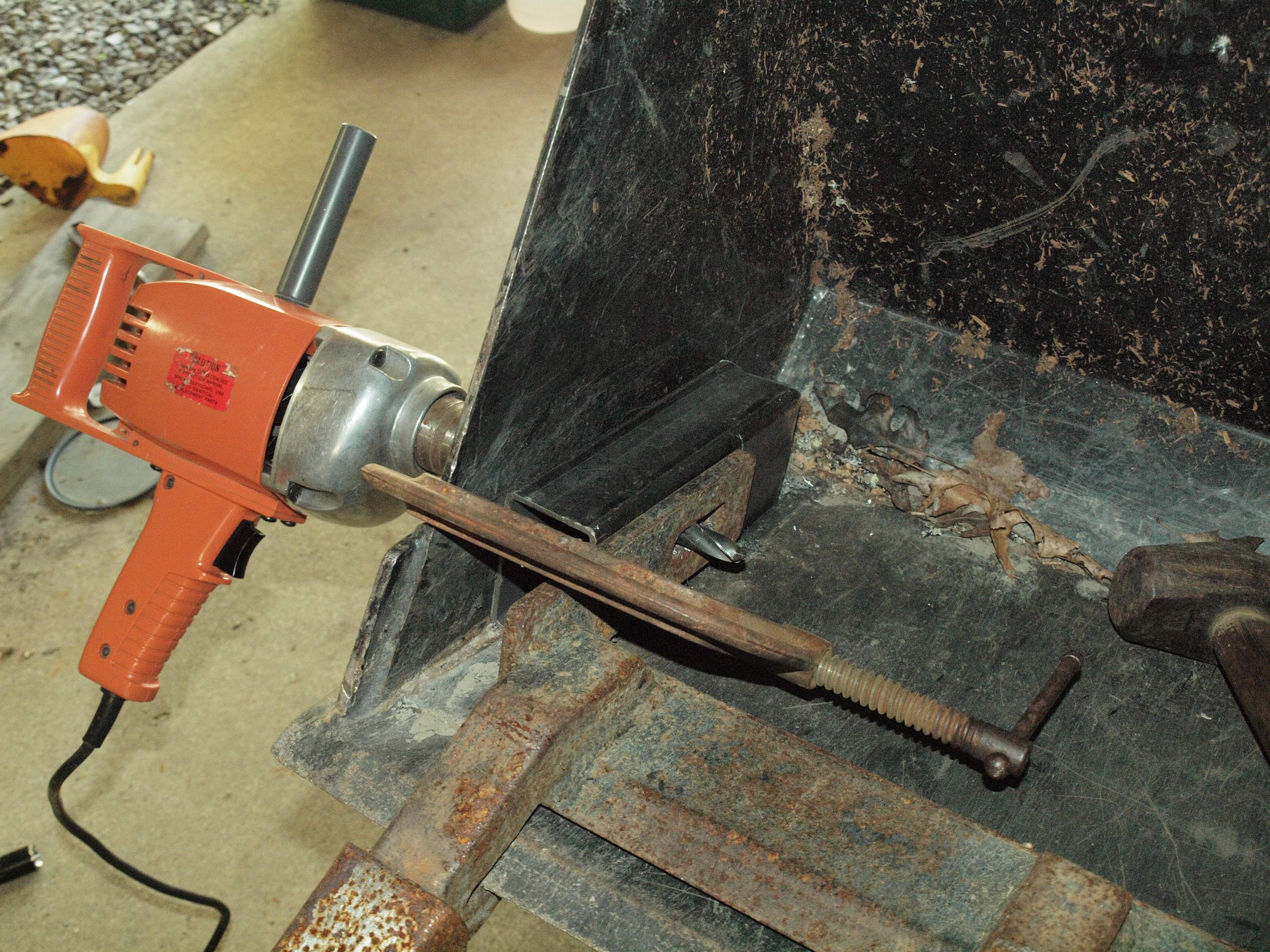

Well dang it, I wanted to give this type of weld a go however what happens when you have a 2" space to be filled with a 2" blocker? Just about fits. As I did not want to wrangle a tooth bar on with these close tolerances, I decided not to weld the spacer in but instead use it as a big "washer". this way I can fit on the tooth bar and just slightly pound in the spacers and then cinch them up with a couple of bolts. Should hold I think. In the picture is an old Harbor Freight half inch drill I bought about 30 years ago. Turns real slow but gets the job done.
   / stick welding tube to plate #16
You might want to cap the tube to minimize the debris you will collect in there.
