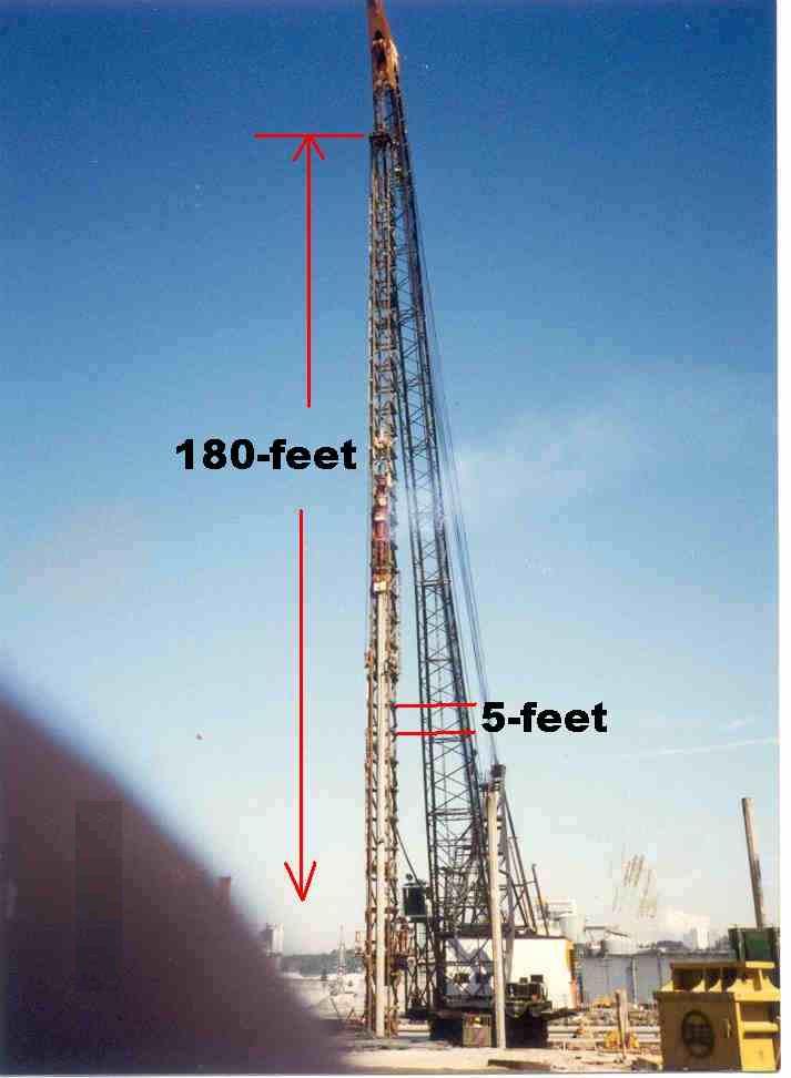

Stick welding has a few advantages over Mig / wire feed. Welding exotic metals for one. Jumping around a lot, or working real high. But I've had the crane operator take a wire feed up to the top of pile driving leads on the headache ball for me to repair them.
