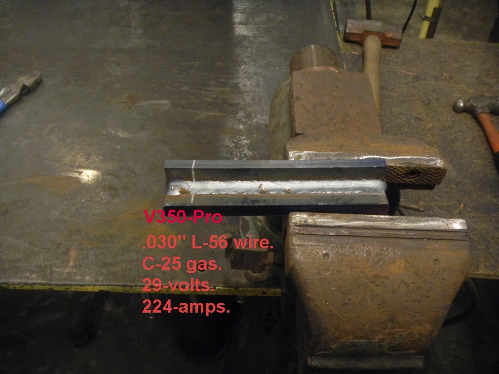

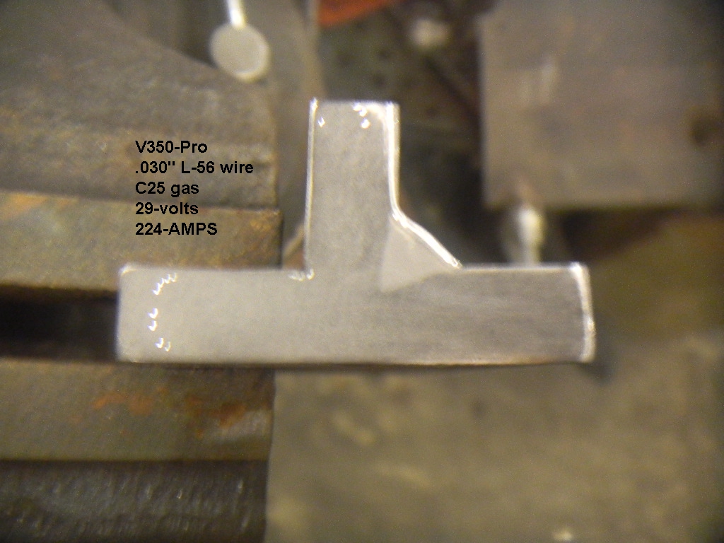

When it comes to Mig welding, there is no substitute for power! :thumbsup:
