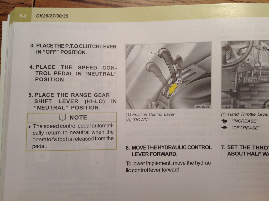

Didn't mean to rattle your cage CM. I just don't think a pedal like that was ever designed to provide a dependable safe self centering neutral function anyway. I searched but can't find much regarding the design intent from Kioti except that it is a one foot operated rocker mechanism which implies to me that you couldn't possibly depend on self centering anyway unless you have a very weak ankle.... which my size 12 clodhoppers don't have.
Look... leaving a ck-hst running in gear and depend only on that rocker neutral isn't high on my list of ways to die either. But put a foot on it and you have complete control of your machine.... without the need of an accurate self centering neutral. That is obviously the way the rocker control was designed to function.
I provided a line of detail on Richyvs's injector pump spreadsheet that provides information on my tractor a long time ago. Yes, I own one... and I'd buy another if this one wears out before I do.. 1000 hours +
Keep your foot on the rocker pedal, never trust the self centering neutral function and all is good. :)

I guess I disagree, I think it should dependably return to a neutral position, the two pedal set up on my DK does, every single time. And I think it's a safety issue as well, my beaten up wood shed would probably agree.
I had the exact same experience as described above. Kioti asked my dealer for pressure readings from those ports. I also had a hydraulic leak. I asked my dealer what the pressure was supposed to be and he too said he didn't know, Kioti wouldn't tell him, but the other tractors he'd seen with the problem all had similar readings. He said he thought the pressure was to low.
   / Sticking hydro pedal #138
Fuggley, the obvious way the rocker control was designed to function is stated in the note box on page 5-6 in the owners manual.
