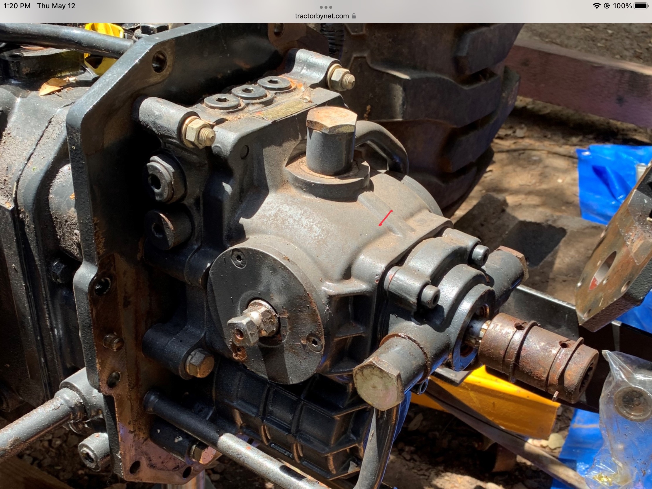

I can only refer to the Kioti CK and Bobcat CT era of tractor, pre tier 4 units. I have not kept up with the newer units.
IXLR8, in post #6, has it spot on in my opinion.
The problem is where the rotating shaft goes into the hst unit. The hst unit is within the bell housing which connects the front and back of the tractor together. The bell housing has a hole where the square end of rotating shaft comes out. A linkage arm clamps onto the square end and almost entirely covers the hole in the bell housing making it very difficult to get in there and lube where the shaft exits the hst unit.
I use fluid film with the straw to hose that area down every time I grease the tractor. Even hard to get in there with the straw. Have only had some treadle sticking the past couple of years only in the very extreme cold and will clear up after about 10 mins of use.
My opinion is this is not normal, but so common that we just accept it as normal.
This is a pic of a Bobcat CT230 hst. You can see where the input shaft with square end goes into the unit. This is where you need to get the lube. Not my tractor or pic.
