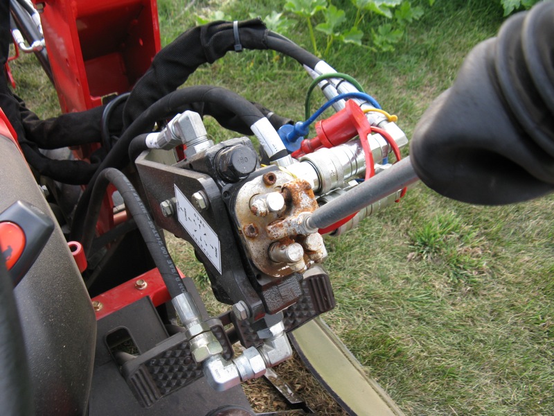

My B2920 loader valve is very stiff to operate. It is difficult to do fine adjustments when in tight places or heavy loads. Are there any way to adjust the loader valve to make it operate smoother and easier? My BX2660 was so smooth and easy. Thx.

How difficult is it to access the control valve on the B2920? If relatively easy try disconnecting the valve from the linkage and see if the joystick moves freely or still binds. If it move freely try to move the spools in control valve by hand to see if they feel like they are binding. Once you have determined which component is binding then you can start eliminating possible friction points.
On the control valve is it possible these tractors or valves sat on a lot and got water in the spring centering assembly causing them to rust?
On the linkage, is one of the pivot points caulked or twisted causing the assembly to bind?
On my Branson the joystick ball joints looked like this from the factory.

I actually worked with mine last night before I posted. Everything with the valve was clean and no rust anywhere. My tractor has only 20 hrs on it and the dealer had to order it when I put in my order. I had seen two B2920' s on another lot before I ordered mine and one was really smooth and the other was stiff like mine. Unfortunately, mine came in with a very stiff operating loader valve. I did spray lube on the valve to see if it would help but it didn't make any difference.

After having another look at my control valve I would guess the centering springs are causing the stiffness.I don't feel any friction or binding in the linkage,just the lever returning to neutral with quite a bit of force.If it is caused by stiff springs,is there any thing that can be done about it or will it loosen up over time with usage?To the OP,I am not trying to hijack your thread,just trying to find a solution for everyone.
