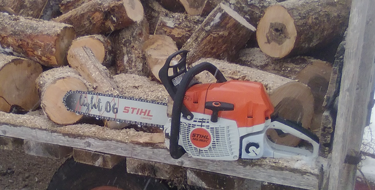

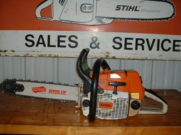

I was looking at new saws last month. Was comparing Echo CS620P, Husqvarna 562XP and Sthil MS362C.
I did not care for the air filter set up or controls on the Echo CS620P.
Stihl had a sale on and the MS362C was $20 more than an Echo CS620P and $200 cheaper than the 562XP.
Sale was so good they were sold out of MS261C and I got the 2nd last MS362C.
Got to be very careful 2nd hand market here, apt to get burned touching some of the deals.

I have no experience with the MS362C, but I have its predecessor, and it's a great saw. I predict decades of trouble-free use, if you keep it clean and sharp.

I run an MS362 as well and that heavily influenced me getting this one. Nice having two identical bars & chains. The older MS362 has the carb adjust holes on the side where the MS362C is mtronic.

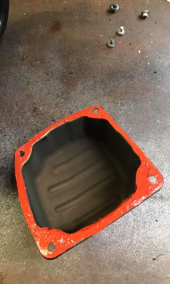

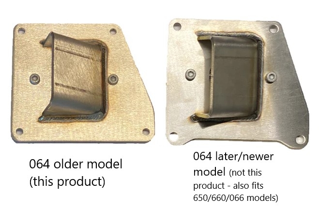

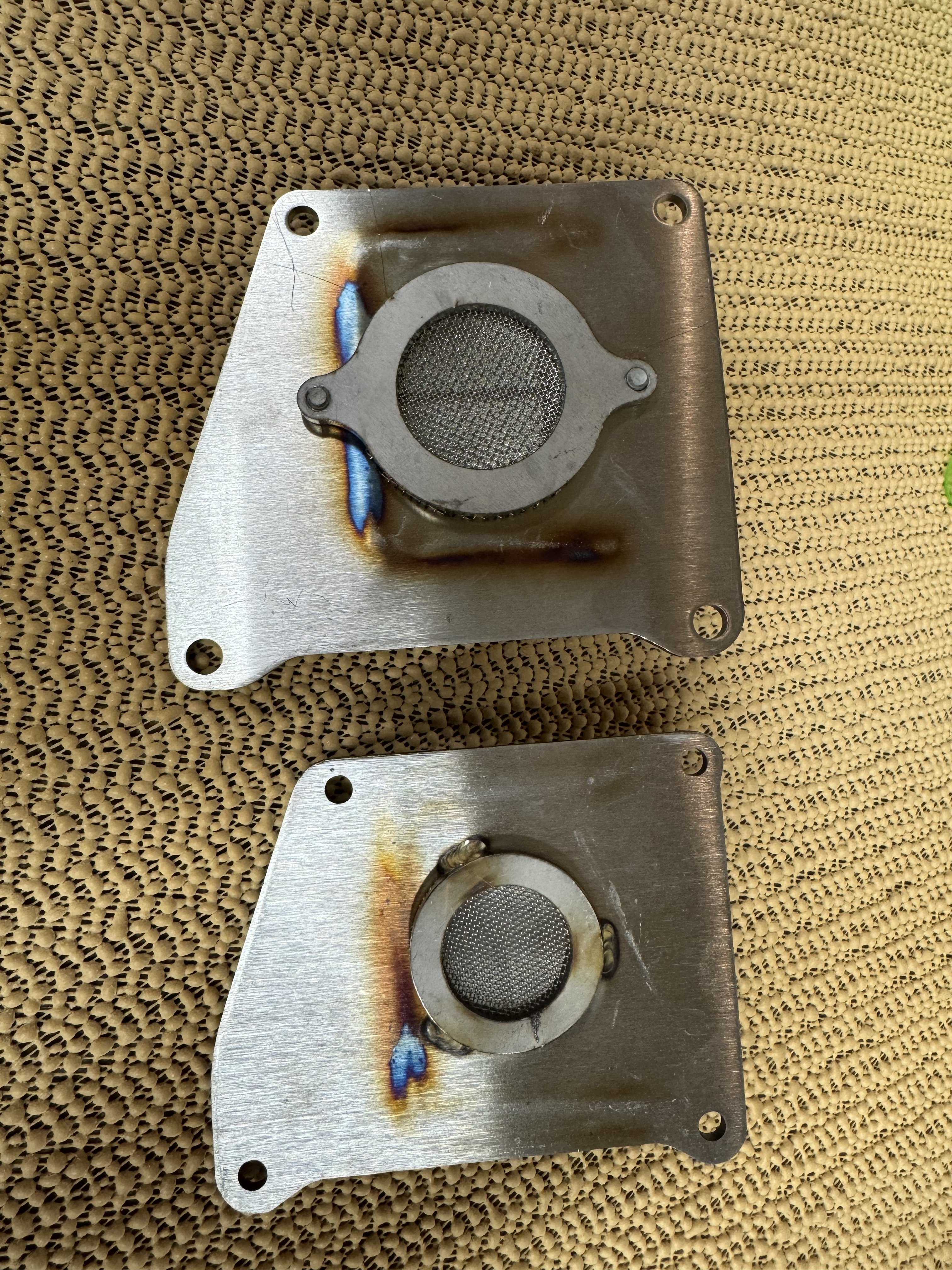

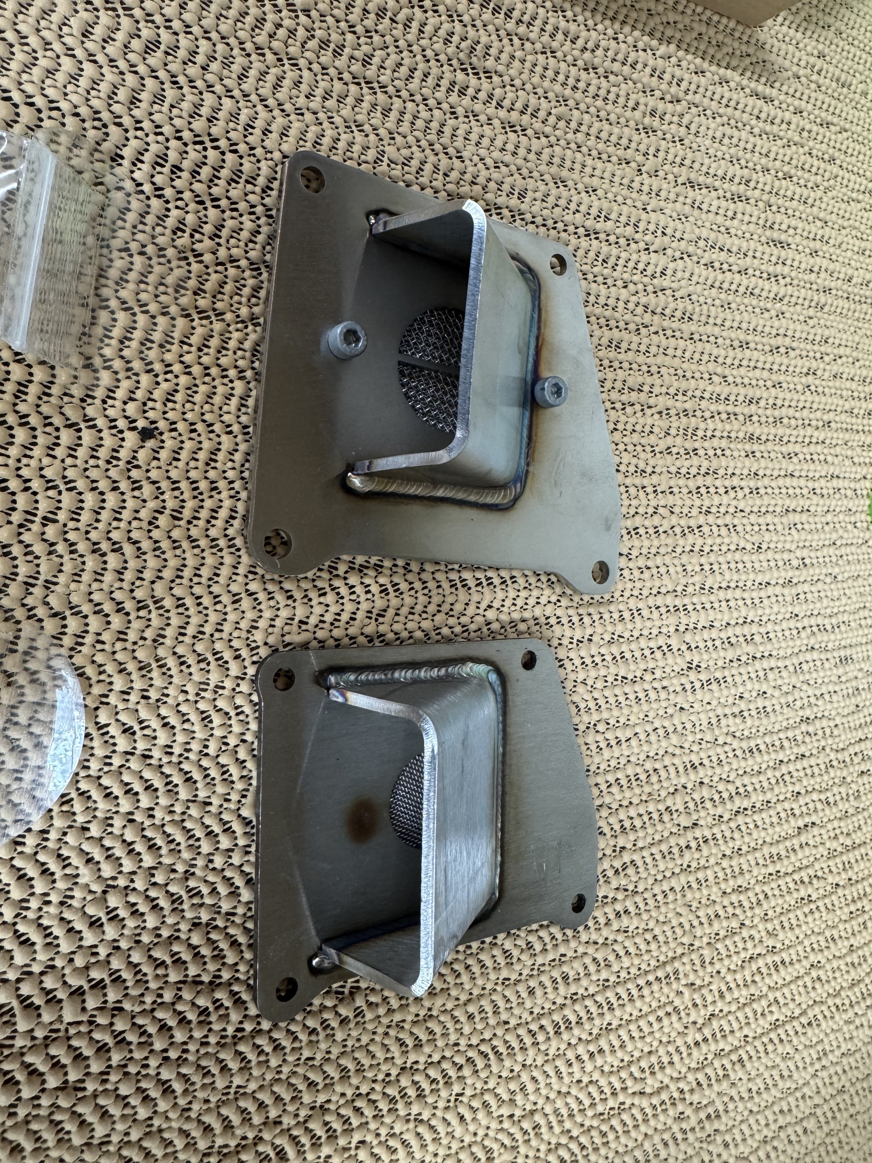

Just received some straight shot mufflers from Egan, and they came with two longer screws required to install, but no gasket. Kinda assumed that they’d come with whatever is needed for install, and old gasket came off with old muffler cover, so I’m guessing I need to order that separately to finish the install.
I’d bet it would be fine with no gasket, it’s a straight shot after all, but might as well do it right. It doesn’t quite fit the muffler housing on my 036, but it’s close enough to force it into the stamped sheet metal lip of the OEM muffler housing.
Oh, a quick photo. The little 036/362 muffler is downright cute, next to big brother. :D

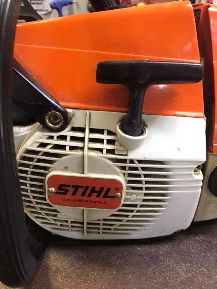

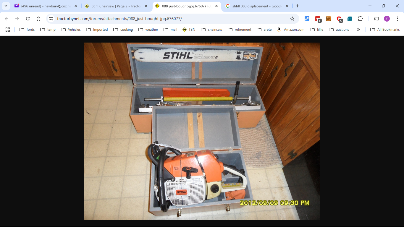

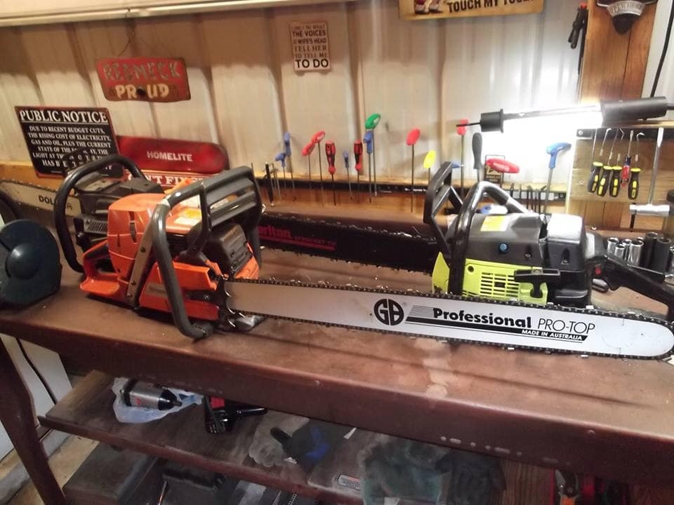

My last $500 saw, Stihl 088 with an Alaskan CSM.
Yep. That's about what I was paying in 2012, as well, but for just the saw with bar and chain... no toolbox.
That's an awesome saw, BTW. I had it's sister, the 084. I think they were 125 and 135 cc, respectively?

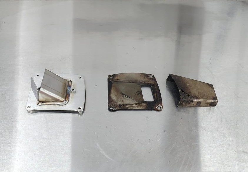

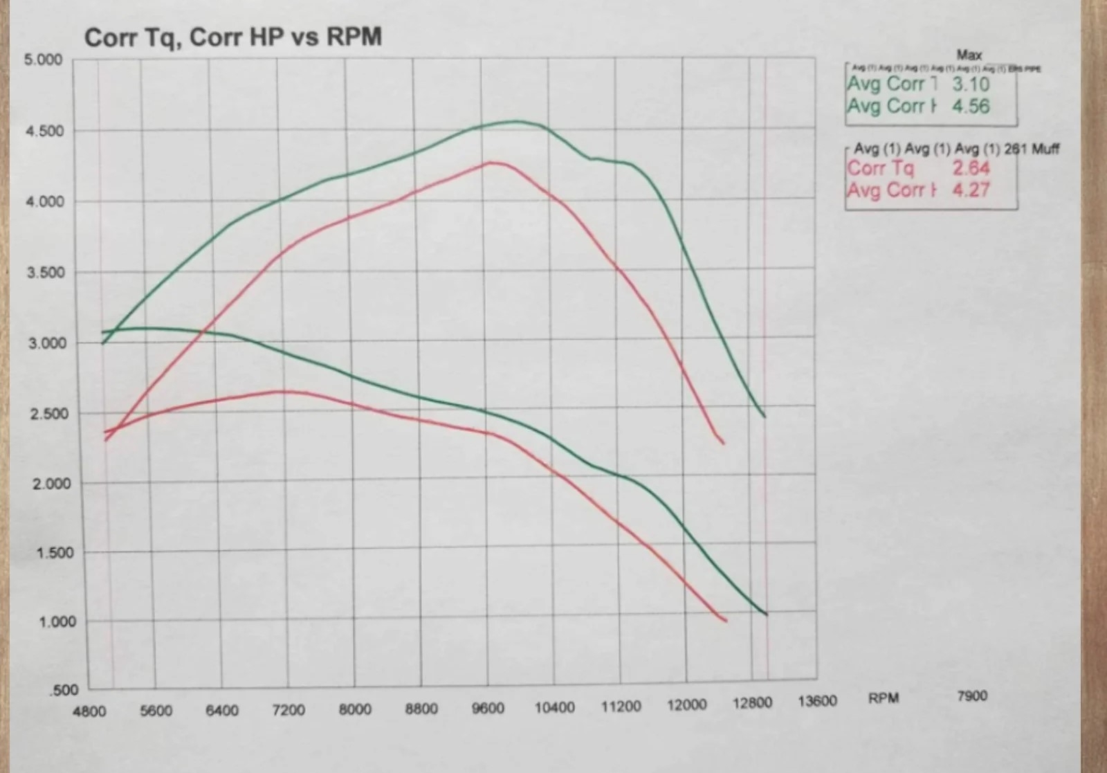

Want a better built cover and proven better even on dyno. Egans straight shots. IMO.
So, I installed one of these on my 036 this week, and had a chance to put a little time on it today. I wasn't cutting anything bit enough to bury the nose, so it wasn't possible to judge how much power it added, as this saw always had plenty of power to sling the 20" bar and chain thru the 12" diameter hickory I was cutting today. I'll have to wait until I have some fresh big oak logs, to really judge that.
But I noticed I'm having to open the high mixture screw right up against its stop, to get the saw in tune. It's not a surprise a more open muffler might lean the saw out a bit, you can't make more power without using more fuel, but damn... I'm worried I'm on the edge of running lean with the screw open as wide as it will go!

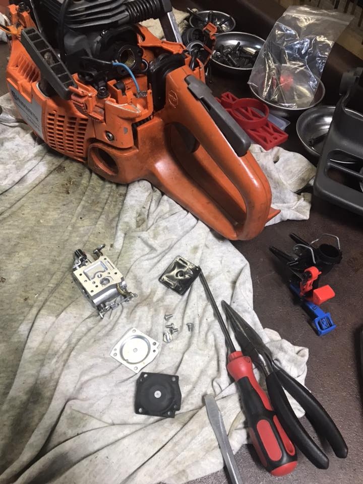

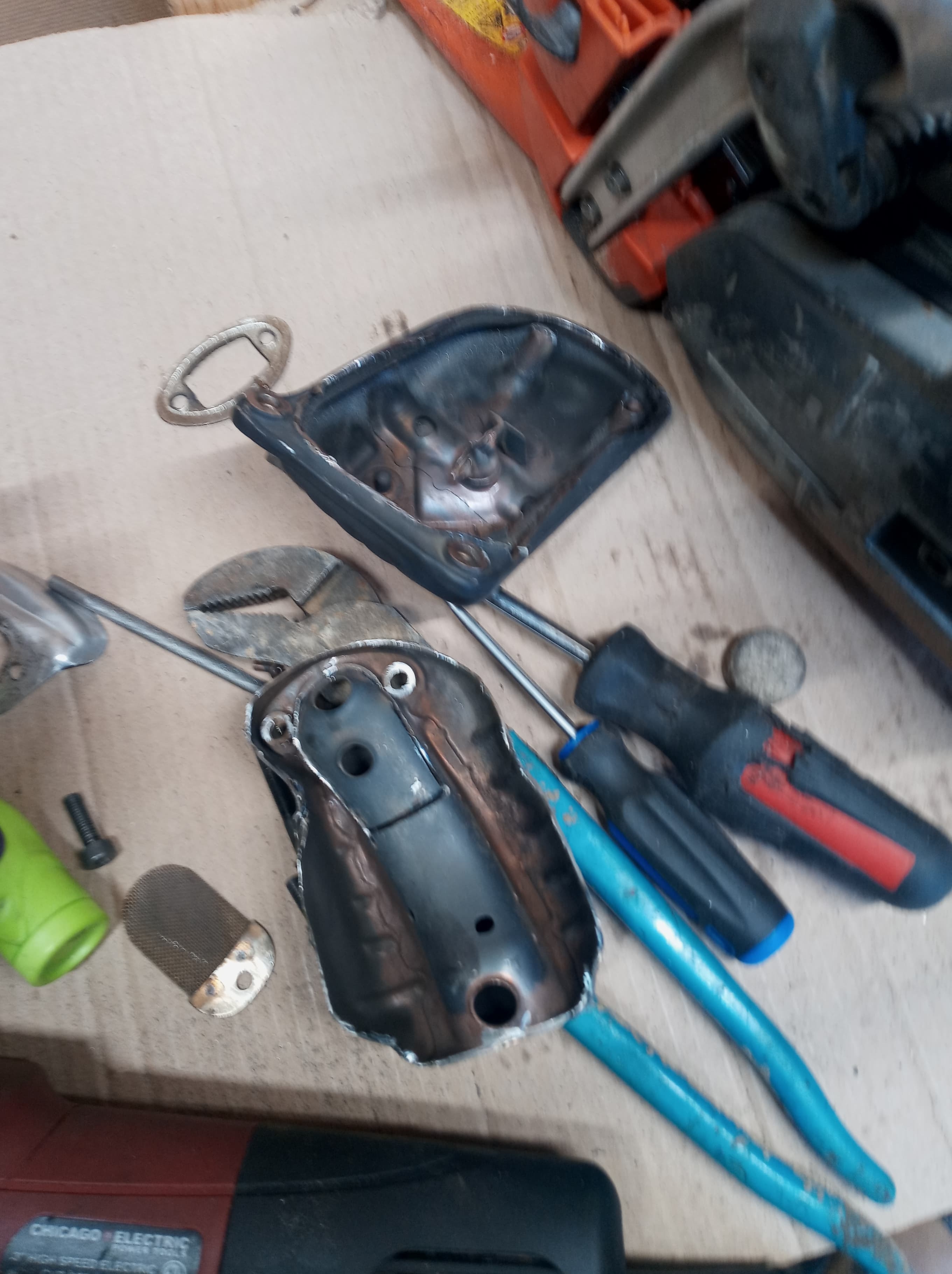

I pulled the epa stops on 2 saws and trimmed the tabs off 2 saws last week alone. Common after muffler modding to get full carb adjustments.
Just trimmed this one waiting on kit. Muffler modded stock 346 44.3mm afm cylinder that impressed me testing.
They were all pulled and trimmed while carbs were on saws. This one needs a rebuild kit.

Hey, what do you think on that muffler gasket? The Straight Shot plates from Egan didn't come with any gasket, but the old gasket came off with the old muffler cover.
I suspect that without a gasket, there could be a small leak that heats up and eventually burns thru the metal on the stock back-shell. But maybe the the Straight Shot flows so easy, that there's not enough pressure to even worry about leaking, without a gasket.

@WinterDeere I dont normally see any issues by not having a gasket there.
But one time a 880 had a leak right at bottom blowing on to the oil tank. So I just used some high temp there and never a issue afterwards.
