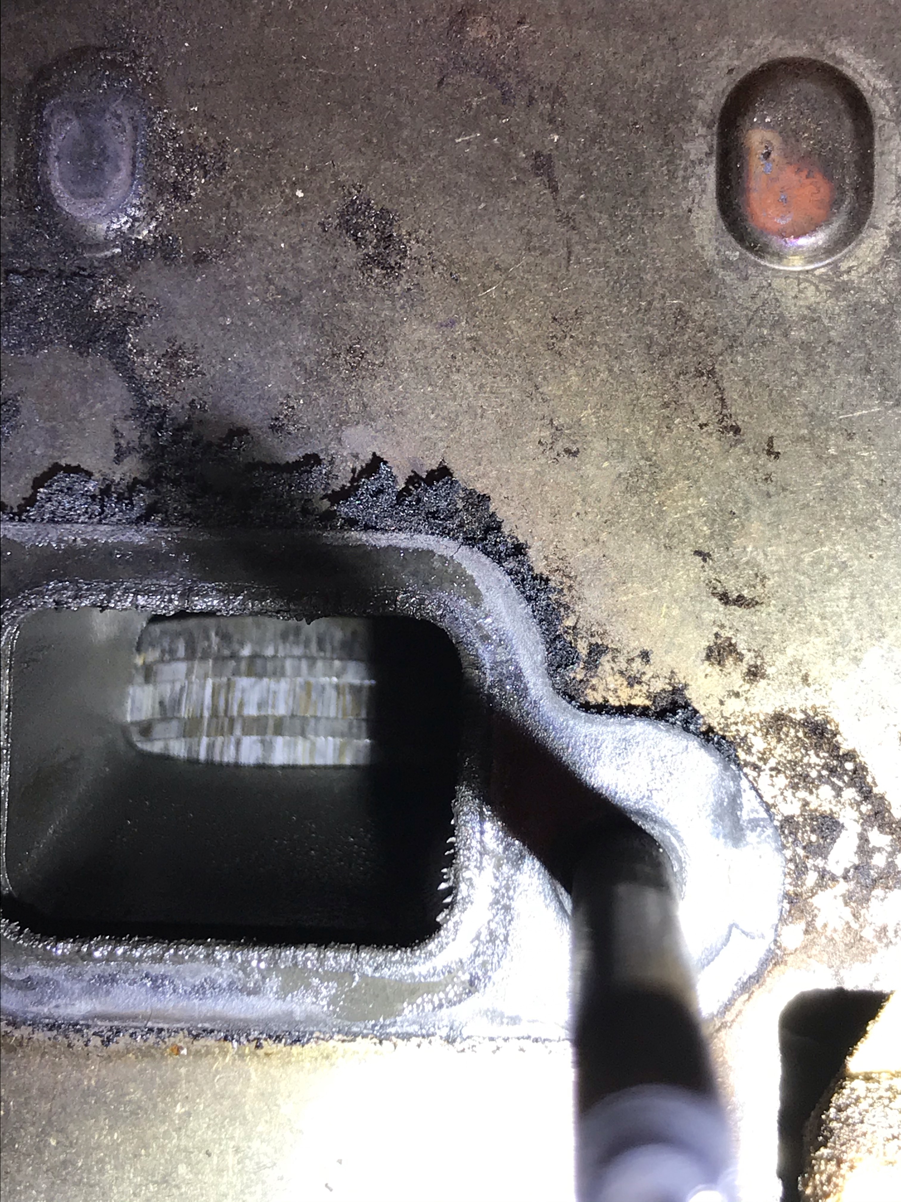

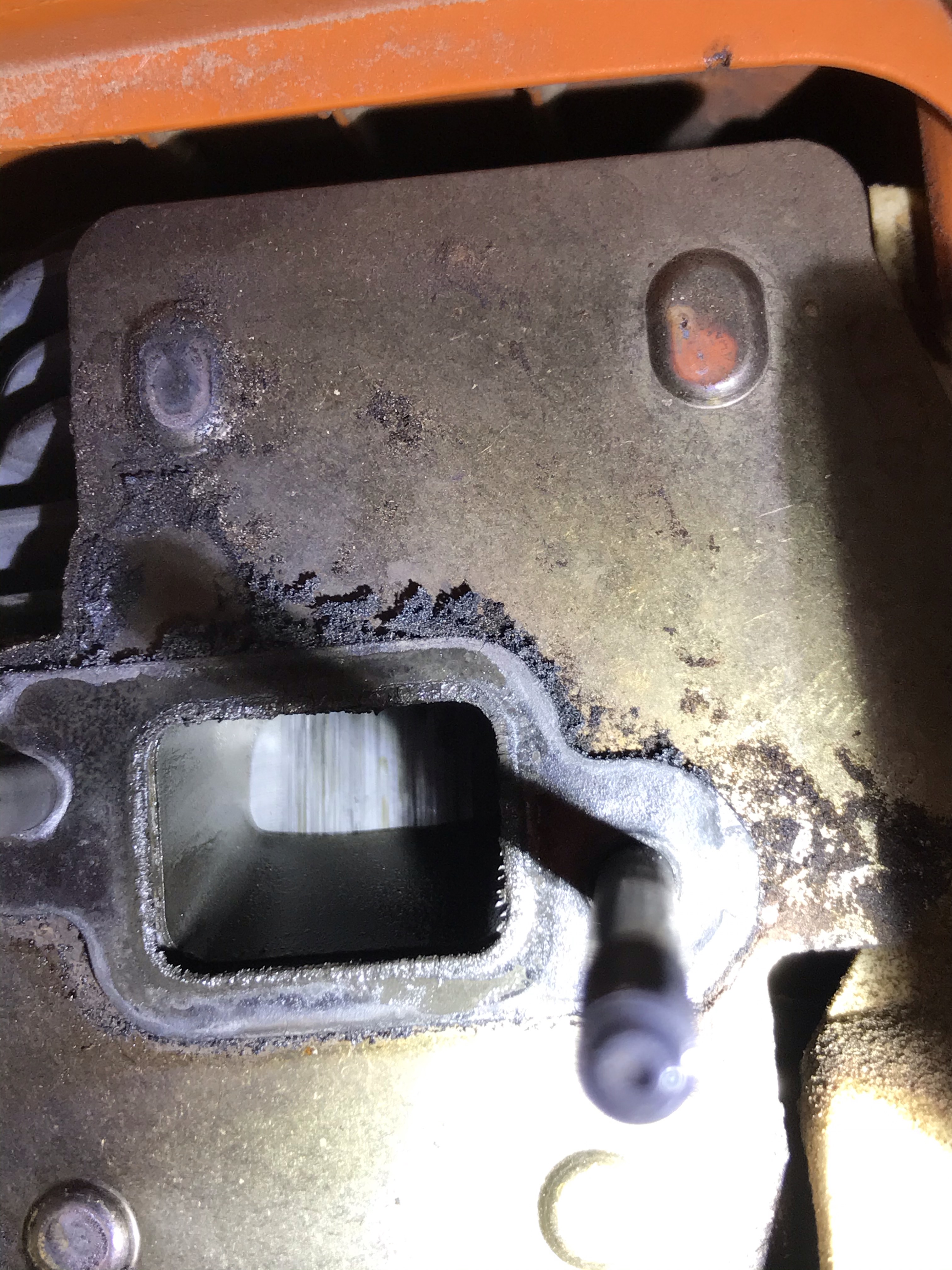

It bothers me some because as I drug a screw driver lightly across the piston I thought I could feel the score. I will try and post a pic.
   / Stihl MS250 mixture screws?
#28
The first pic is more the top of the piston the second more the bottom. Tough to get good pics. 0A2A7DB9-10DA-4DE7-8FDA-F1B90DBD1400.jpeg04C2A9F3-1D1F-4EF8-99B6-79306E0CA207.jpeg
   / Stihl MS250 mixture screws? #29
That looks bad enough that I'd rebuild it. When you do at least replace the piston, rings, wrist pin bearing and circlips. The cylinder may be in good shape but check for scoring and deposits of aluminium. I haven't rebuilt a clamshell type saw but I think the crank seals are easy to get out when you pull the crank out of the cylinder, so replace them too. They may have been the problem that caused the damage and replacing them is cheap insurance.
I have the shop manual pdf if you need it.
   / Stihl MS250 mixture screws? #30
Sorry, Dave, but your piston and probably cylinder are trashed. Good photos.
I have had good experiences with aftermarket P&C for the MS250. You can get a set for $20 from a US seller.
If your pre-mix fuel is kept fresh and at the right ratio, an air leak is a good suspect, as Eric suggests. You also may have over-revved it or worked it too hard in hot weather.
