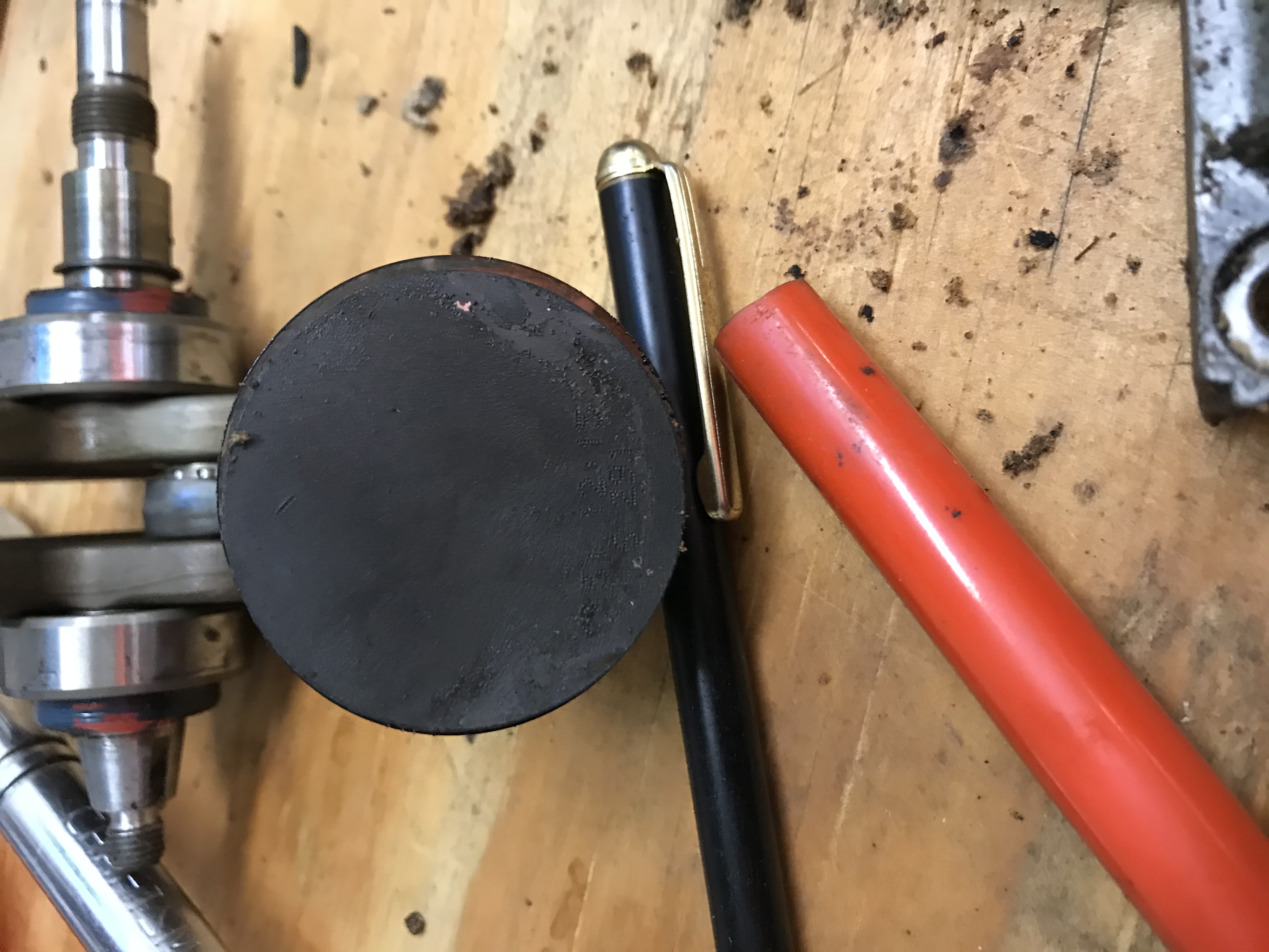

I got it apart, needs an entire new engine assembly. I hoped it would just be the piston but the cylinder is scratched just as bad as the piston. The pic is the exhaust side, the intake side looks brand new. The top ring is frozen to.
/ Stihl MS250 rebuild.
No I do not. Possibilities are no oil in gas, I do not think so. Bad gas, possible, not enough octane. Run to hard with a dull chain, most likely in my mind, my 23 year old son used it quite a bit over a period of a few days or I did it myself.
It has been that way for a few years. It still worked when cutting, it just would not idle well.

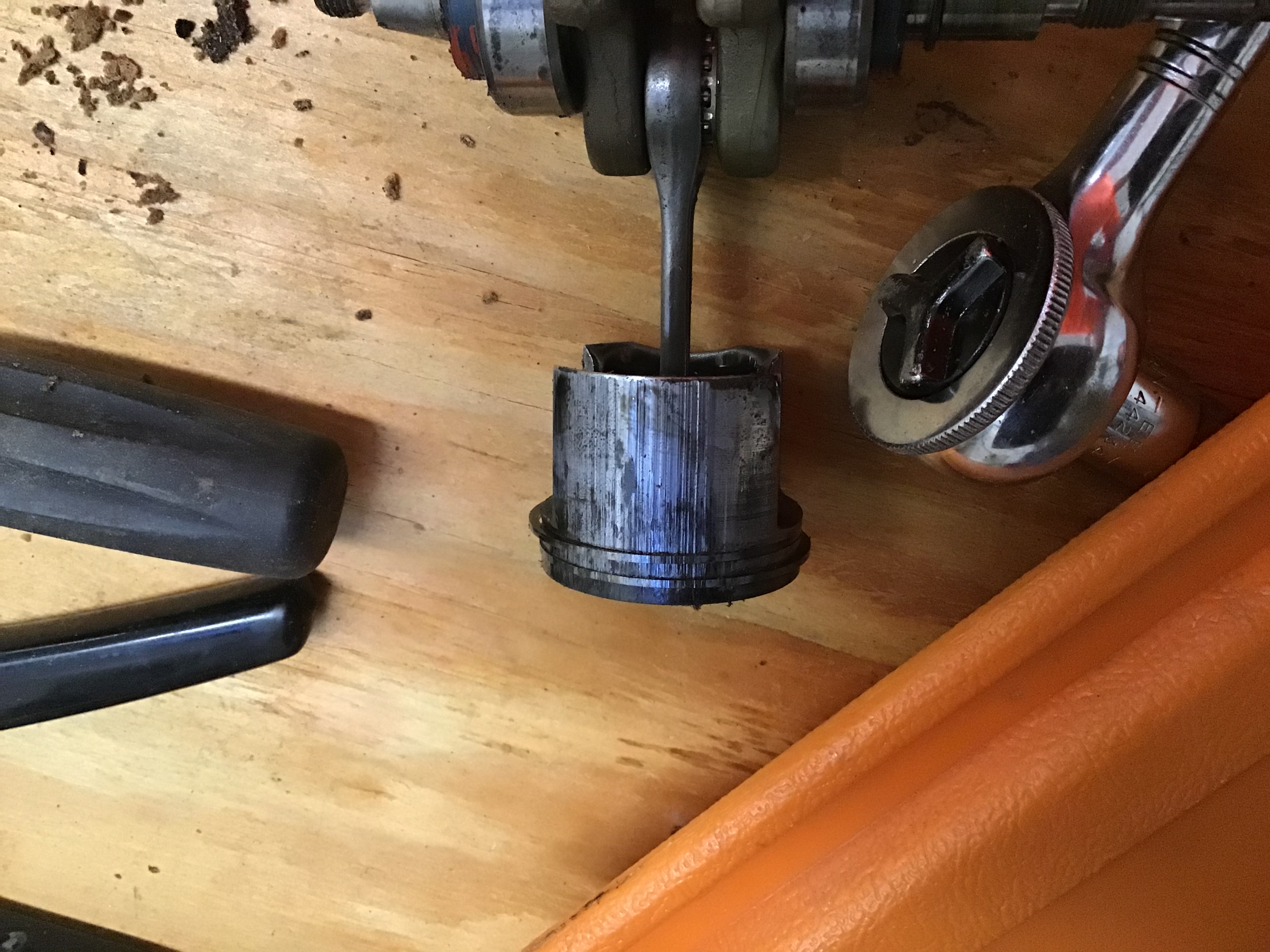

Here is a pic, the exhaust side is up.View attachment 668832
There's no detonation damage and the crown does not appear overheated. You said the intake side looks good. So it's most likely the seizure was from lack of lubrication. The seizure marks match that diagnosis but it's hard to tell from them alone. Lack of lubrication could be from separated premix but modern oils do not drop out of suspension as readily as old ones did. It might be from poor quality oil but even cheap two stroke oil should be sufficient for a chain saw, which has a low power/cc. Most likely cause of lack of lubrication was lack of oil in the premix, like running straight gas by accident or making a mistake with the ratios and not getting enough oil.
I always shake up my can of saw premix before pouring into a saw, and use a Ratio-Rite to measure the oil out so I don't have to do math in my head. You can rinse the oil out of the Ratio-Rite with some of the gas to make sure you get all of it. I recommend using a good synthetic oil. I like Redline Allsport, because it works and it makes the exhaust smell good or at least less bad. I've torn down engines I ran it in and they are pretty clean with no signs of lack of lubrication. For my saws 50:1 using good oil, is fine. 40:1 would be ok too but you'll need to clean the spark arrestor a bit more often.
