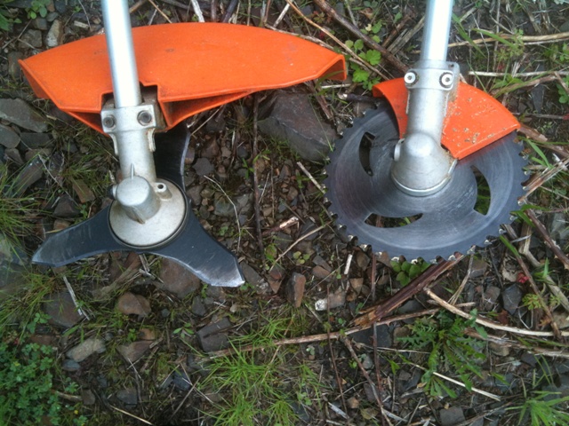

These are the two blades that I use most frequently. The three prong "knife" is great on grasses and other herbaceous vines and woody stems. The other is great on woody stems larger than 2 inches up to 8-10 inches. Beyond 10 inches it is a but much and I switch to a saw. It is really nice for doing PCT but that is not what the OP is trying to do so I won't go into details.
