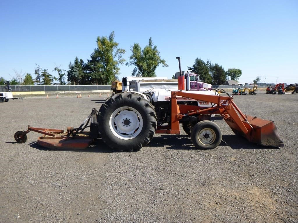

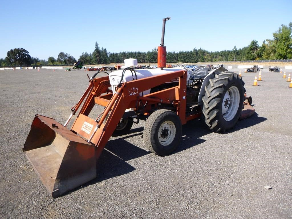

The David Brown is actually the 1975 selectamatic with a Case loader.
I'm not nearly as excited about it, but it does seem in decent shape, if not as nice as the JD. I am a little worried about parts availability for it, but it seems like they're available after a cursory search. Good tires, 2000 hours. I wonder if since it was made when Case bought DB, if it would still have Lucas electrical? Hopefully I'll get the JD and won't even need to worry about the Brown.

there is really nothing wrong with the david brown, they are well built machines and parts are not as hard to come by as you might think. lots of them sold all over the earth. i would be seriously considering weather you think 2wd will be adequate in Alaska though.

The david brown is a 990, which was the same as the CASE 990. Supposedly you can get parts for them through case. It should go for quite a bit cheaper.

BTW, the David Brown is not nearly in the same league. Not having 4wd is huge.
I wouldn't even consider it.

I'm still debating the David Brown. No it wouldn't be the tractor for me in Alaska, but we had to put off moving for at least a year, and I could always sell the tractor along with my property when I sell it. But I could probably get it for around $5,000, and use it until I leave. I'll probably pass on it though.

Careful with the David Brown. That is a 2WD tractor with weight distribution for pulling, not for FEL work.
Does it have enough power steering power? That was a problem with many utility tractors of that era.
That's a small add-on FEL, with tiny cylinders, but it is still heavy. You should take a good look at how any add-on FEL is attached to the tractor. You want a full length sub-frame and no attachment to the bell housing.

sorry that you missed the JD workhorse. I think the DB is more of an antique collector item, not something to rely on for day to day usage
