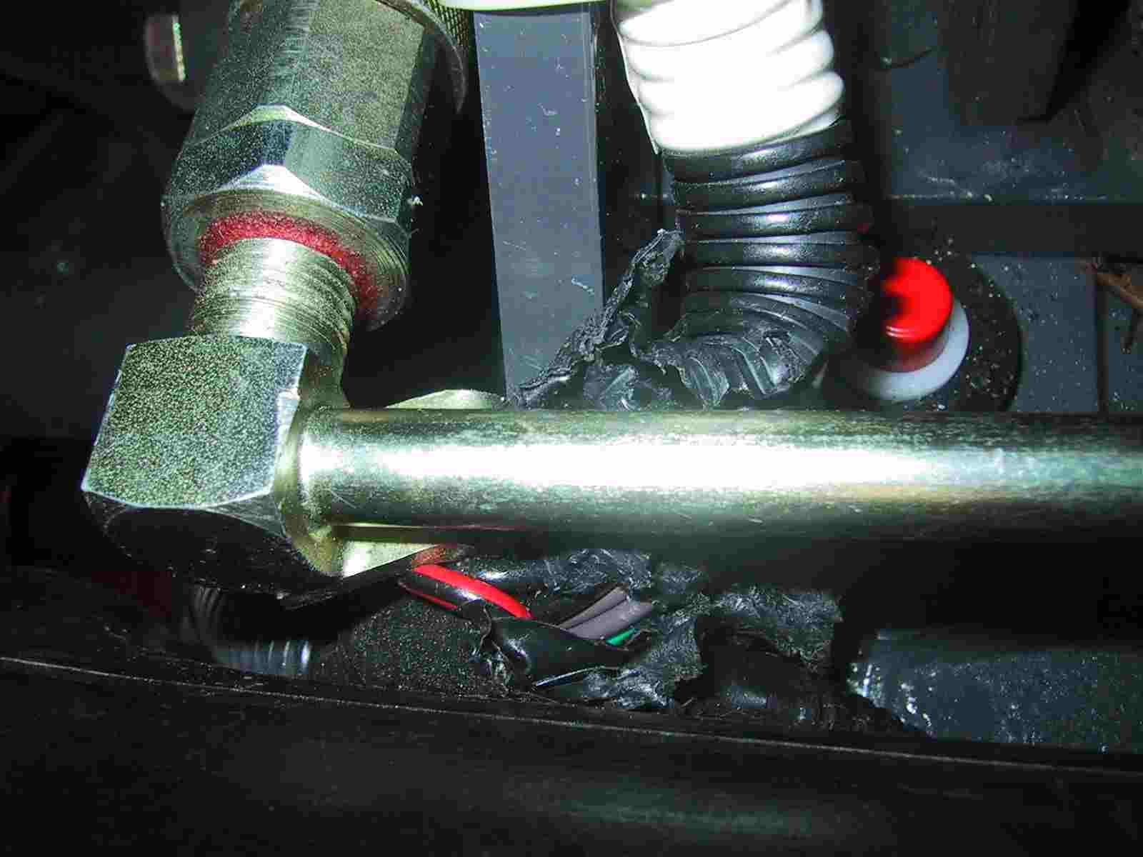

With apologies to Jim Becker, I still can’t seem to locate the aux connectors for hooking up a work light. After digging, and picking away at the electrical tape and corrugated plastic wire-harness shield, and generally making a mess of things (see attached pic), I still uncovered no connectors. So either my BX22 has no aux connectors, or I’m looking in the wrong place or else I’m just giving up to easily. It is a really tight spot …there is zero slack in the wire harness, and it is tightly wedged between that hydraulic pipe and the chassis. Any suggestions would be most welcome. Thanks.

pluck out the red wire that is sticking out and you will have it. It is bundled in the harness where it forms a "t" or "y"... your choice of letters depending on how you look at it...

Thanks for the help guys. I am assuming that the red wire in question is actually the red and black striped wire? I guess I need to do a little more surgery to free everything up. Kubota sure makes this hard.
