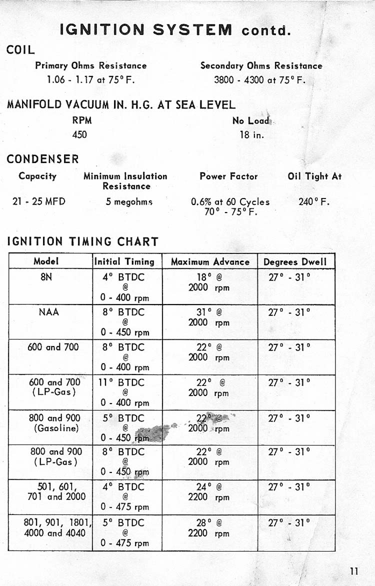

4'btdc at 400 rpm, and 18' max advance at 2000 rpm 27-31 dwell
soundguy
here's a page out of the ford pocket reference.. top line on the chart is the N
