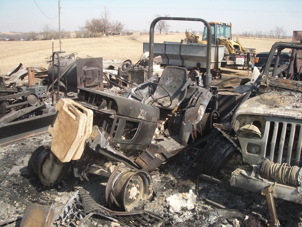

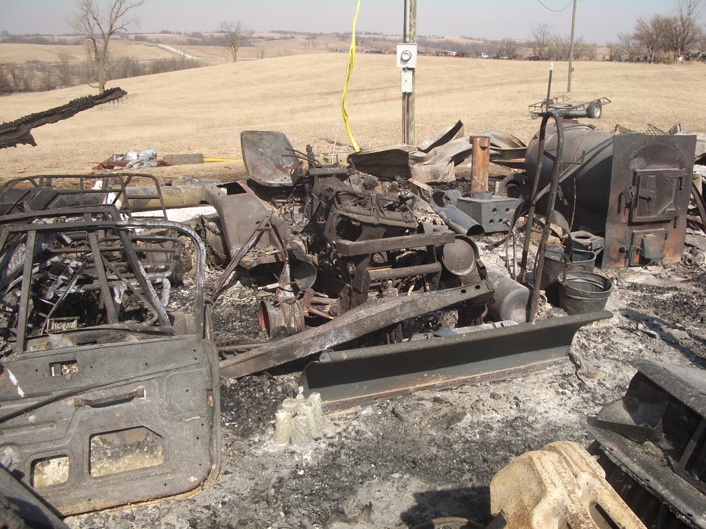

I had a JD455 and my B2910 at the same time. I mowed with both and did tractor chores with the B. I lost both tractors when my shop burned. See pictures.
So I replaced the JD455 with a JD2210 for mowing chores and light tractor duty such as toting in firewood, blading snow, etc. I replaced the B with a L4400 w/FEL to do bigger tractor chores such brush cutting, loader work, etc.
