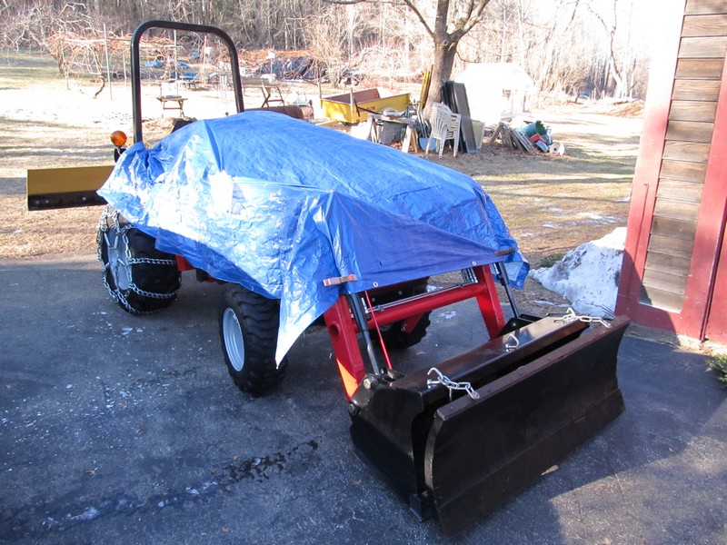

Pictures are worth a 1000 words.....
First clamp the tarp to two sides at the back of the tractor and then pull it tight forward and clamp to the FEL cylinders. I think this is an 8x10 tarp. Protects from rain, snow, and sun and allows air to circulate below.

If i think of it I'll snap a pic of mine tonight. Looks very similar to this setup except I do not use clamps....
My method:
I use a 6x8 tarp for my max. Use 2 bungee cords to connect the 4 corners. In the rear i run it under the 3pt arms or draw bar. Then up to the tarp corners that fall just below the ROPS. In the front, i use another bungee that i wrap around the cross brace on the FEL. It's the same brace that the kickstand is stored in. The corners of the tarp reach just under the upper loader arms....
My only complaint is water tends to collect at the base of the ROPS.
