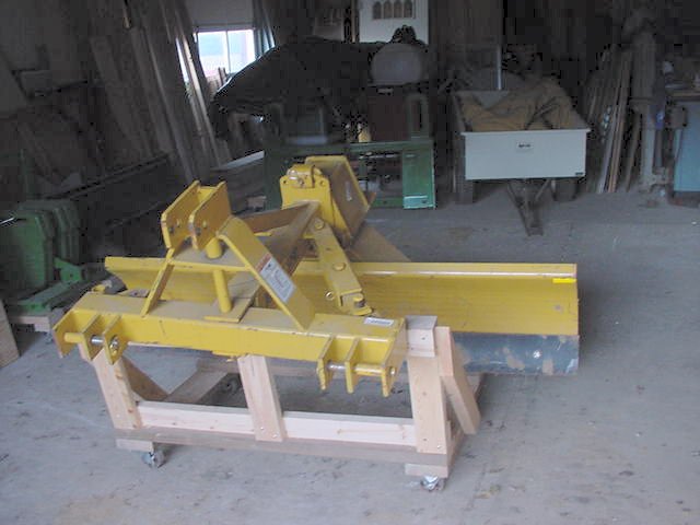

Picture of grader blade.

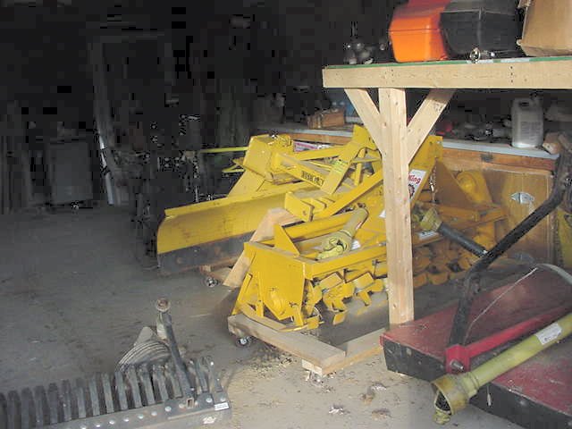

Pictures of them parked.

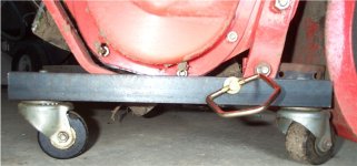

I made a 2X4 & caster dolly for my TSC carryall and it works great but I struggled coming up with a 2X4 design for my First Choice tiller. There is not many flat areas on the bottom of a tiller! /forums/images/graemlins/confused.gif
For the tiller, I bought two pieces of ¼ X 3 inch channel (about 16 inches long) and put heavy-duty casters on the ends of each channel. I slide the channel over the depth runners on the tiller and insert a 3/8 inch pin through the channel to secure it to the runner. The pin goes through the channel, on top of the runner so that it can’t fall off. It works very well.

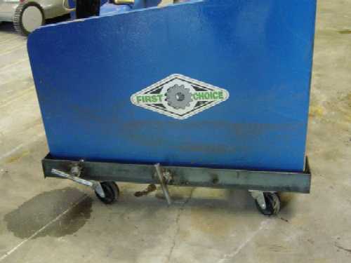

I would be happy to post pictures but my digital camera quit last week. I plan to order a new one... should have it in a couple of weeks. Here is a picture of the dolly that I made for the carryall several months ago. I did not take pictures of the dolly for the tiller but I will do so as soon as I get my new camera.

Gary.. I did not get a new camera but my old camera started working again. I think I have a bad set of rechargeable bats.
Attached is a picture of the dollies that I made for my tiller. I have a dolly on each runner. If you want more detailed pictures let me know and I will take the dolly off the tiller and photo from various views. They are simple to make and they work very well.

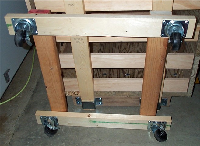

Here are the dollies I built for my Box Blade.
