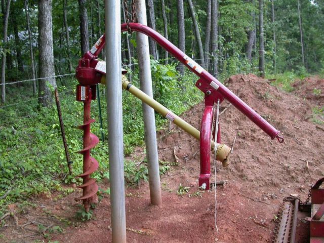

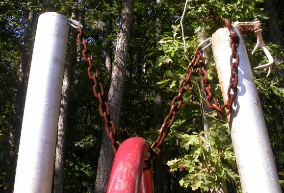

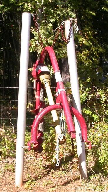

I had my son help me assemble and attach mine the first time. I knew I'd need to do it alone in the future. Driving down the road one day I saw a guy selling some old iron pipe. He said they had been used for church volley ball nets. I put them to use in the back yard for my adjustable height phd stand.
Drilled a hole at the top to link a chain across.
